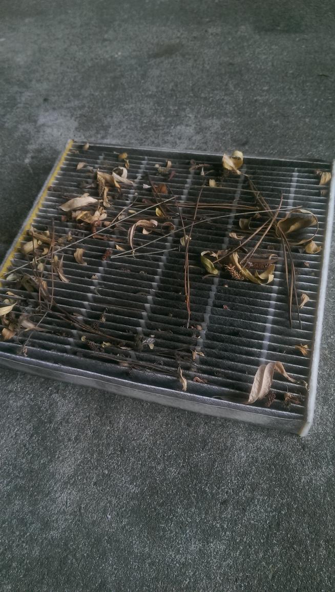

Thought I would share my pic too. This is after 33k miles, after looking at some of the other pics in this thread, I might have taken the lead here with the nastiest filter yet?

Most of our vehicles come with the "EE" cabin filters installed. The black filter in your first picture is actually a very dirty "EE" style filter. The reason I can tell is because of the white splotch at the end of the filter, that shows how filthy that filter is.
Factory Carbon Impregnated Cabin Air filters are a mixture of black & grey through out the entire filter element itself, you can tell when these get dirty because they start getting a brown hue/tinge to them and when you gently pry open the pleats you can see debris accumulating in the valleys.
One more thing I feel I should mention as some people will inevitably try this as a cheap fix. Do NOT blow out the cabin air filters with compressed air, the filter material is finer than it looks and using compressed air will expand the pleats too much and make the filter useless, if its dirty/clogged you need to replace it and that's that.
Hope this helps, you guys are already being more responsible than most of my customers just by checking and replacing your cabin air filters. I'll have to snap some pictures of some of the horrifying cabin air filters I have seen in customers cars (think 100k and never been changed.)

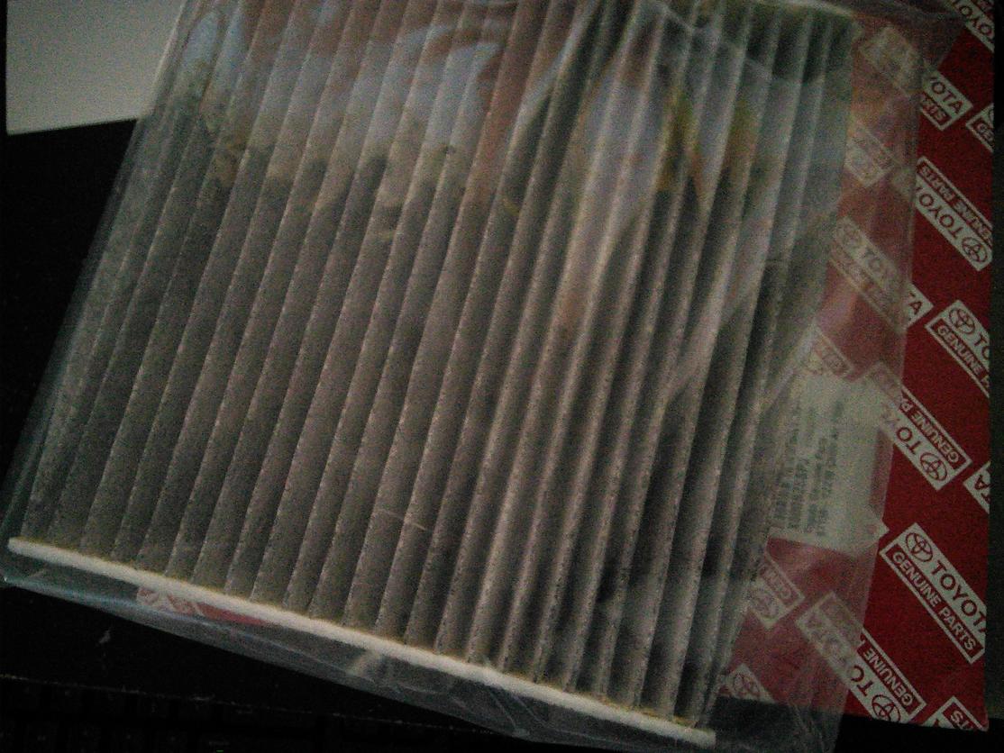

Here's an fun development. I ordered the carbon filter from Amazon (sold by Amazon, not a third part vendor), and the filter arrived in a Toyota Genuine Parts box. But it just doesn't look like a Toyota filter. Too few pleats, a lack of uniformity in the pleat spacing, and although you can't see it in the photo, a lack of structural rigidity. It's taking a journey back to Amazon.

That one looks a bit banged up, but that is how they look. I am not entirely sure how pleat count factors in as many replacements seem to have varying pleat numbers, but the factory replacement cabin air filters are very "squishy" for lack of a better word.

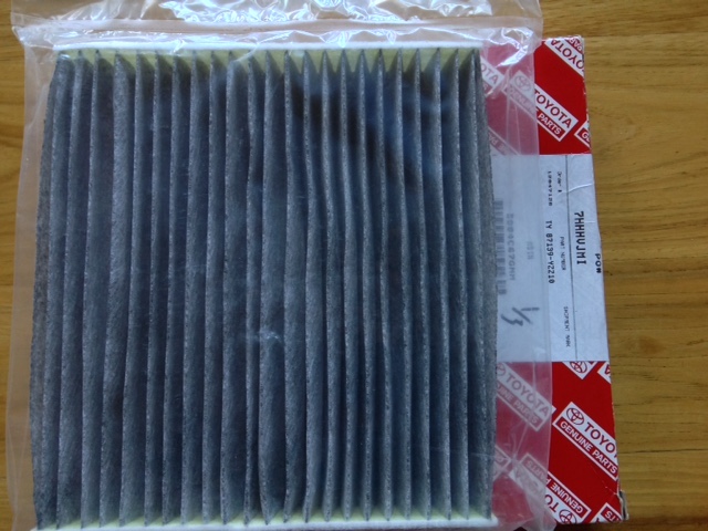

My cabin filter just arrived. It is also from amazon but a different seller. Looks like the number of pleats are the same.

Interesting...What is the part number on that. I just ordered the OEM Carbon filter replacement from Amazon as well (87139-YZZ10) Maybe the carbon version has less pleats?

I replaced tons of these working at service center in college. Some just look beat up. It will be fine though, as long as the outside demotions are the same I would just use it and not worry about it.
Maybe so, I'm sure the carbon provides some resistance so reducing pleats may help. Probably won't matter either way.

Same part number. You can even see it on the box in my photo.

By the way, I installed the new filter. Amazon is off the hook.
Re: charcoal filter vs # of pleats:
The MORE pleats a filter has, the more surface area for which to flow air. If the carbonized element restricts air flow (I don't know if it does or doesn't ), the filter would require more pleats.
