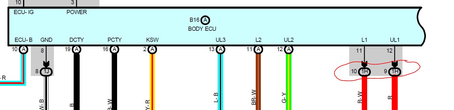

That gets me closer, but I don't see a reference to connector B16 on the Body ECU you posted on another thread, nor does the Body ECU have a connector with 23 pins on it.

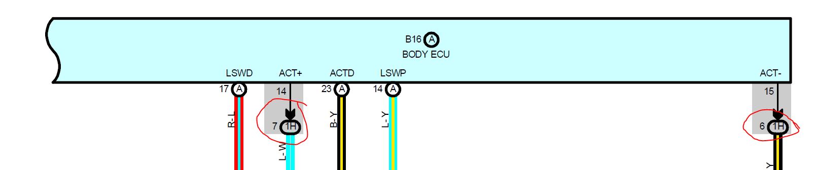

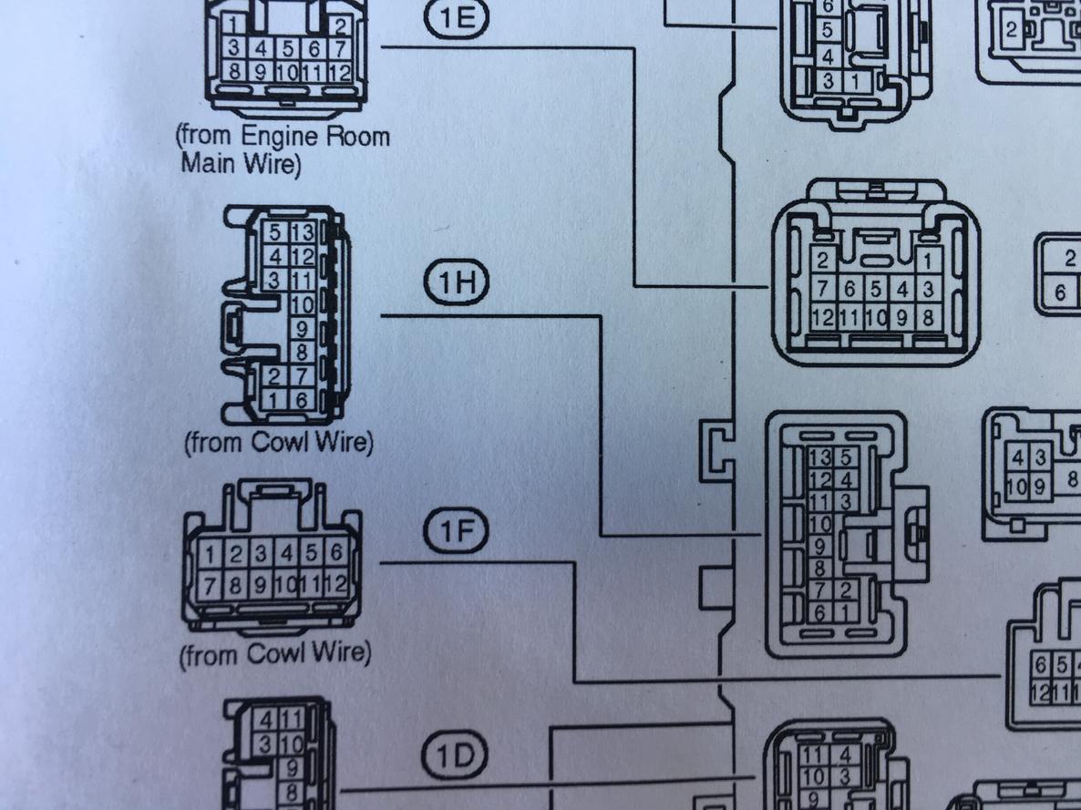

ok, I think I figured it out. The connector that comes from the door lock switches is actually labeled 1H. Ground 1H pin 10 and that energizes the relay coil and locks the doors. Ground 1H pin 9 and that unlocks the doors. Even matched the wire colors with the pin slots, so that correlates. I have no idea what B16 or even the numbers 11 and 12 mean on the diagram.
When I ground pins 9 and 10 the doors try to unlock/lock (motors act like they are not getting enough current, sometimes the lock and sometimes they don't) and shows the same behavior of the door lock switches themselves, this proves the switches are good and either the relay internal contacts or something else downstream is the problem. I will try to get on the contacts side of the relay tomorrow.
OK, I was grilling dinner and painting some parts while I drank a beer and listening to my son playing Norwegian Wood on his guitar so I really didn't pay attention to what you were asking. So B16 is just the location identifier. The actual connector is 1H on the Body ECU. The Pin out for that is here on page 5, not that you really need it.

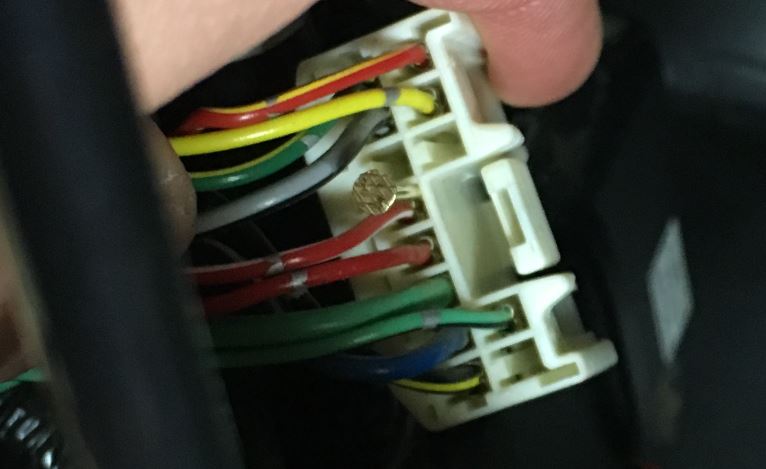

Spent most of the day messing with this. Original problem was the "lazy locking/unlocking" on really all 4 of the doors. I started at the Body ECU because I initially figured the relay was the culprit (although it did have a strong click), but because the 1H connector fed both the coil and the contact side of the relay I could test both without opening up door panels and all those damn plastic clips. Sure enough, I got on 1H (6) and 1H (7) with +12v and GND to lock, reverse polarity to unlock. Same symptoms, conclusion - relay is good.

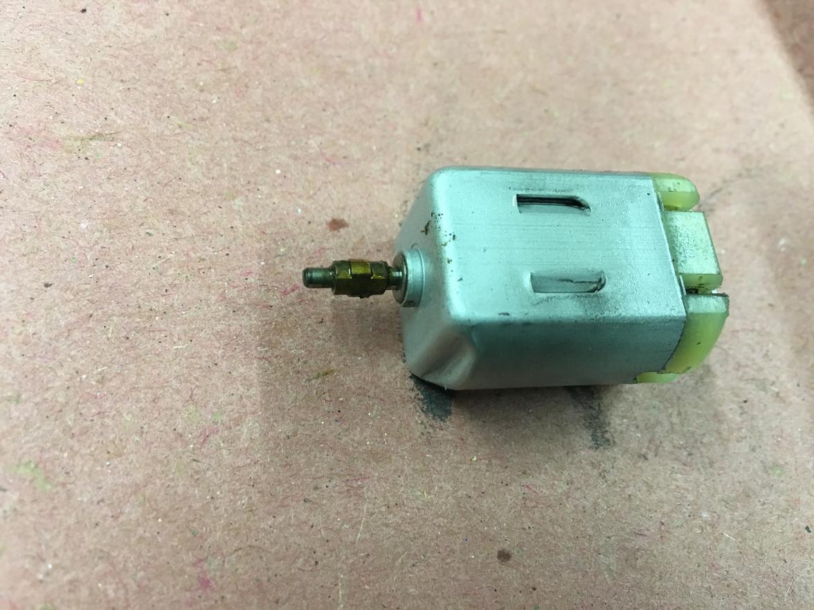

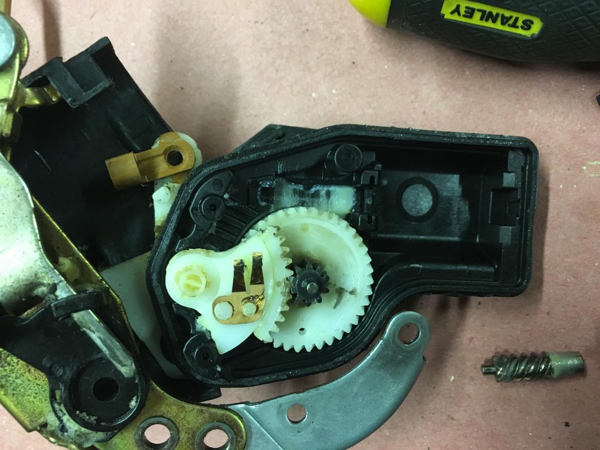

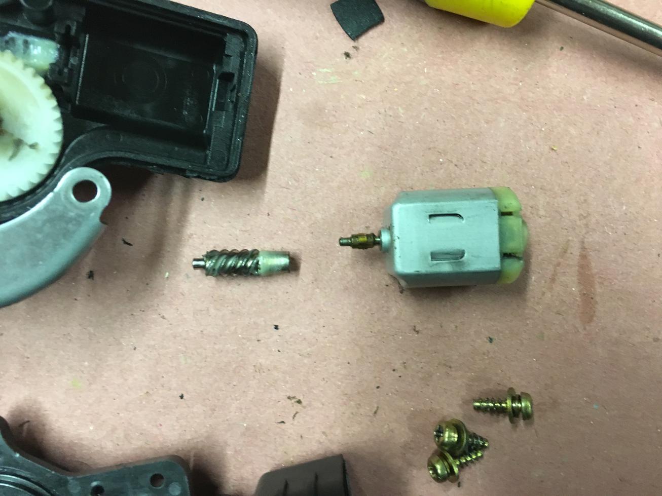

Door panel time. Ended up taking off all 4 door panels, disconnecting the actuators, and testing with 12v on each. They would work two or three times (reversing polarity) then slow to finally stop. Passenger doors worked better than the driver side doors. I read on other threads that as the motor heats up, it will loose torque, thus the "lazy movement" that IBall describes. My conclusion is the motors are the culprit. I took the left rear actuator out just to confirm I needed the motor with the collar (and yep, that damn yellow retaining clip for the door handle broke off!). Just ordered 4 motors from the link that callimobber posted above. Thanks guys!:hatsoff:
To confirm, I have a 2000 4Runner Limited 2WD and the motors need the short shaft FC-280PC-22125 with the brass collar.

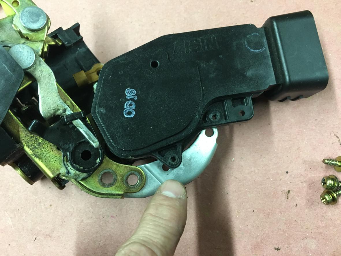

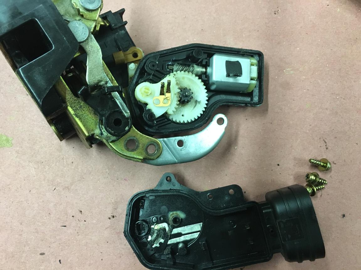

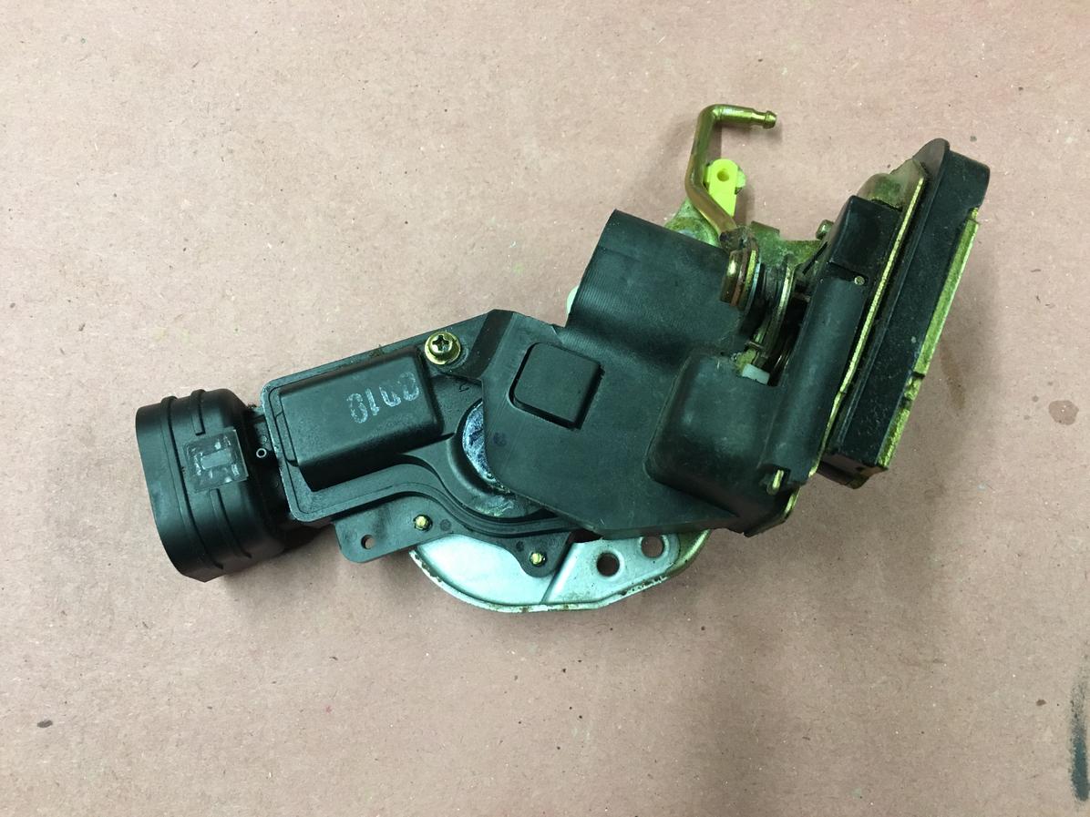

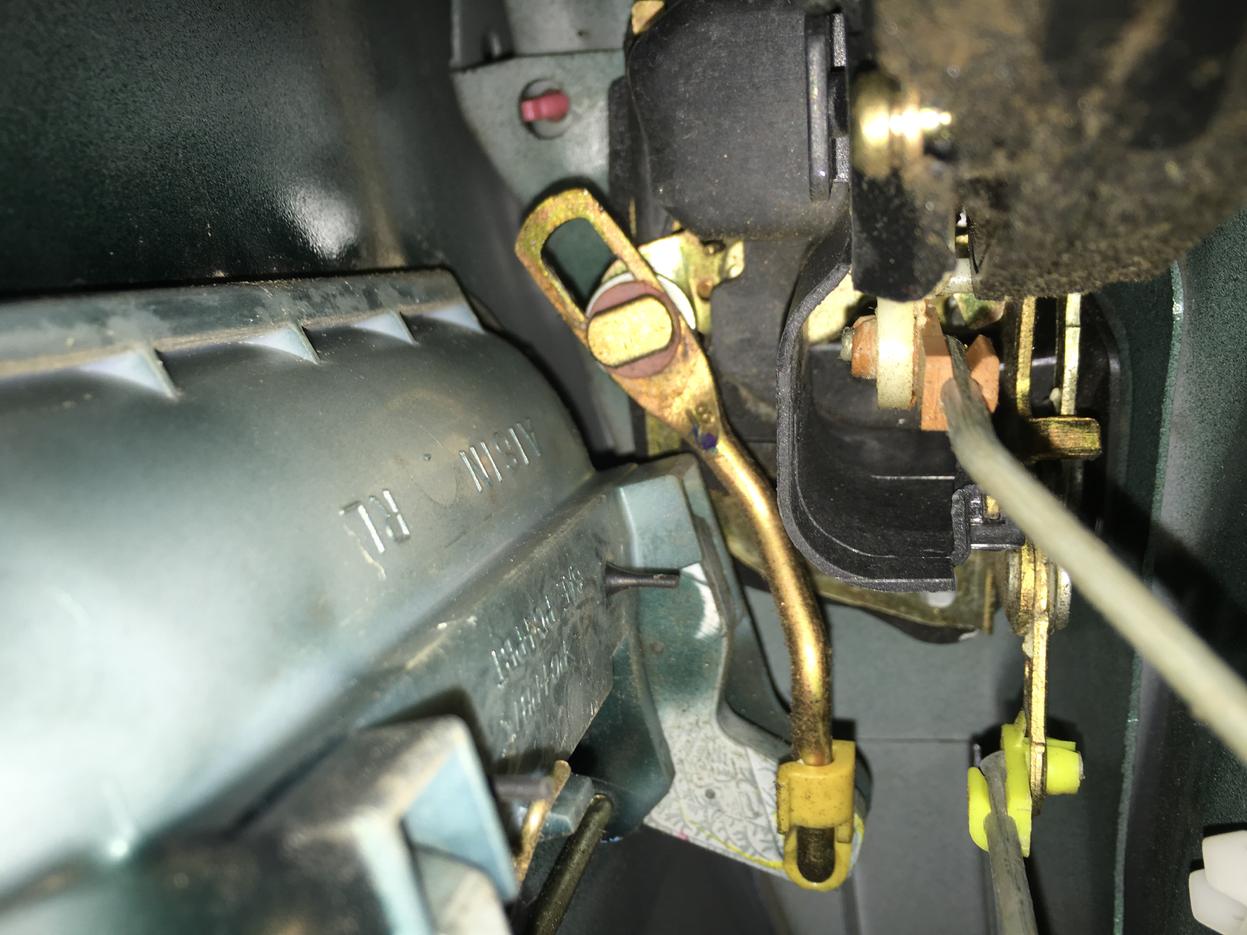

Here are some picks of the actuator pulled from the left rear passenger door. On the pic of where my finger is pointing, you can just wiggle the actuator on top of the bracket, then pry the case open along the seam with a screwdriver.
