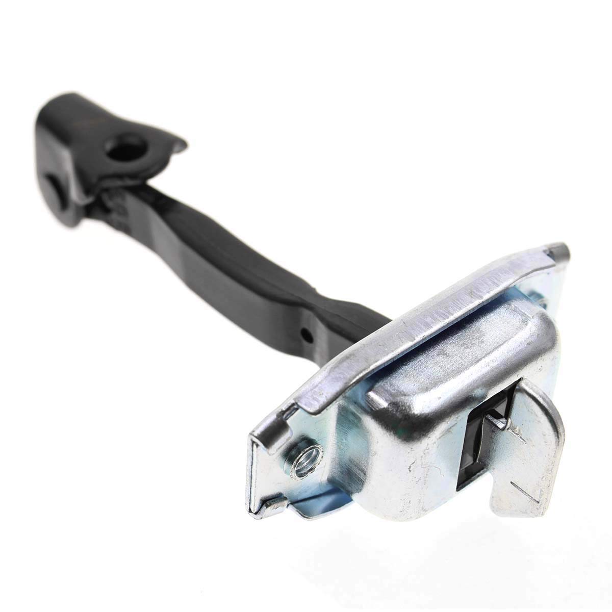

Looks like a good deal! Hopefully you can figure out why our door checks wear out so quickly and if we can do something to save them.
I guess relative to dealership pricing, it's half price, so a good deal....
Compared to other door stays/checks/stops, still not cheap though. I'm not keen on simply replacing an item that is seemingly inferior. I've heard several accounts that ours suck and fail much sooner than others.
Charlie said that our arms are plastic. I'd like to find a viable option that is metal. So, I'm reluctant to buy that "genuine" one on eBay.

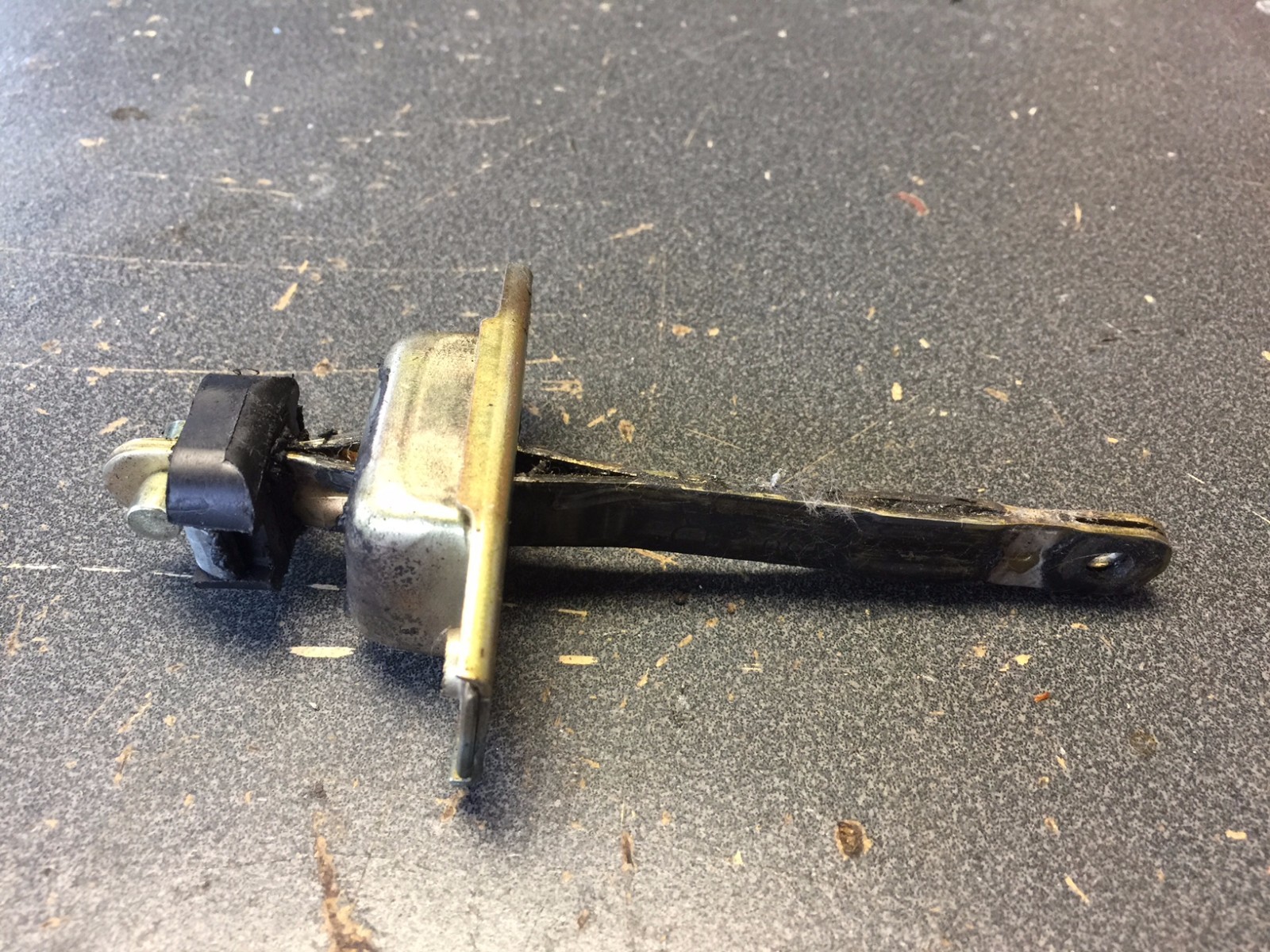

I'll pull one, probably the driver's side and post up a couple of photos.

Finally got the photos.
Here's a photo of the door check when "open":
And here's when the door is "closed":
There is no way to remove the rubber grommet from inside the brass housing, it is welded shut. Well, not without getting really creative. The issue seems to be the arm itself, the black plastic seems to wear down over time. I'm not sure any coating would work for long, seems like it would just scrape off. Here's a close up of the wear on the plastic:

Excellent photos Jerod. Thanks. Very kind of you.
From those and what you described, there are no tabs or other easy way to open the "box". Between that and the plastic coating on the arms, the OEM solution sucks for us. And dang expensive too...
Unfortunately, what I have arriving tomorrow, I think also might have a plastic-coated swing arm. The feedback received on Amazon was all over the place...
But, at least with that unit, the box has tabs, so the innards are fair game. And, at 12 or 13 bucks a pop, if it works, that would be a huge price-savings...

The threads you see in the photo are not a standard bolt, I forget what they are called. Toyota uses them in a few spots like on the sway bar bushing brackets where it's a flat piece of metal that's welded to the housing, so they are basically just studs for the nut to go on the other side. They could be separated and removed, but you'd want to have a dremel or some other tool that can break the bond.
