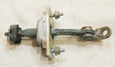

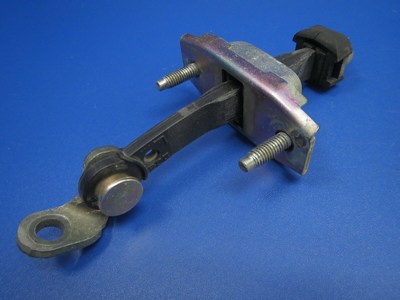

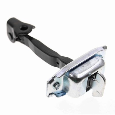

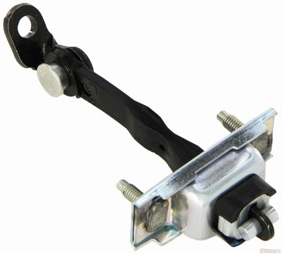

FWIW; first one is a new OEM Toyota drivers side door check. Next two are used Toyota drivers side door check's. Fourth is the Matrix/Corolla door check. All for comparison.

A couple quick measurements.
Yup, plastic-coated arm, but no texture, which might be a positive in terms of those high points getting worn down over time.
It's super stiff. I am not able to close it. It's apparently reversible, a left and right. Would be nice if true for us. Again, this is for a Matrix/Vibe, Corolla and Prius...

Door panel needs to come off, then speaker too. I of course remembered that I sealed the speaker housing...
No worries, I simply removed the speaker, not that surround piece and had sufficient space to get it out. The two compared.
Jerod, no need to measure since I have one out...
It's longer, and I'll see how that plays-out. I'll get a couple 10mm bolts and give it a try. The two holes are indeed the correct spacing, so it seems. The hole on the other end of the arm, the right size too. When the door is closed, with the added length in the door, that looks to not be problematic (freedom of motion).
