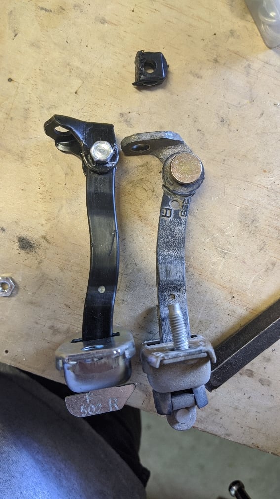

Notice a difference on this one? Besides these being white, not light green...
As stated earlier, two shims on each side. Damn tight fit. Arm needs to come out to slide them in. Wasn't too hard with the arm out. Getting the arm back in take some force. I'm like 140 or so pounds, and it was tough. Curious if this will be too much for our front doors. Will find out...
Filing the end more flat is a good thing and helps to re-insert the arm.
Had this extra piece of wood with the big hole in it, so added two others.
To do this...
With gloves on and a carpet remnant to further protect the hands, with all of my weight I was able to push the arm in and through to full open...
So, if this (shim doubling) proves to be desirable, this added about 20 minutes, for me at least...
I will next remove the nuts and replace the bolts with new ones, tape her up again, then proceed to remove the driver door panel and door check. Maybe even tomorrow. If this (four total shims) works even better, I'll do the same on the front passenger door.
There was an assumption, a realistic one, that this door check would work on the driver's side too. I can confirm it does. Just flip it over (L for driver, R for passenger). And, I saw no ill effects of doubling-up the shims.
So, I removed the front passenger one again, and added two more shims, put it back, and finally the rest of the door. All back together, at full weight, and it stays open quite nicely...
So, I'd recommend shims, two on each side even, but likely not needed I suppose. I didn't want to experiment for weeks, take the door apart again, add a shim, repeat...
So, fronts done and back together.

I think most would rather have you bump an old thread like this. Shows you already did at least some searching. The door holder piece is called a 'door check' by Toyota. I replaced mine recently, and yes it fixes the problem. You do have to remove the inner door panel to access/remove the old one and install the new one:
They are different left to right, I only did the front doors:
It installs from the inside of the door:
