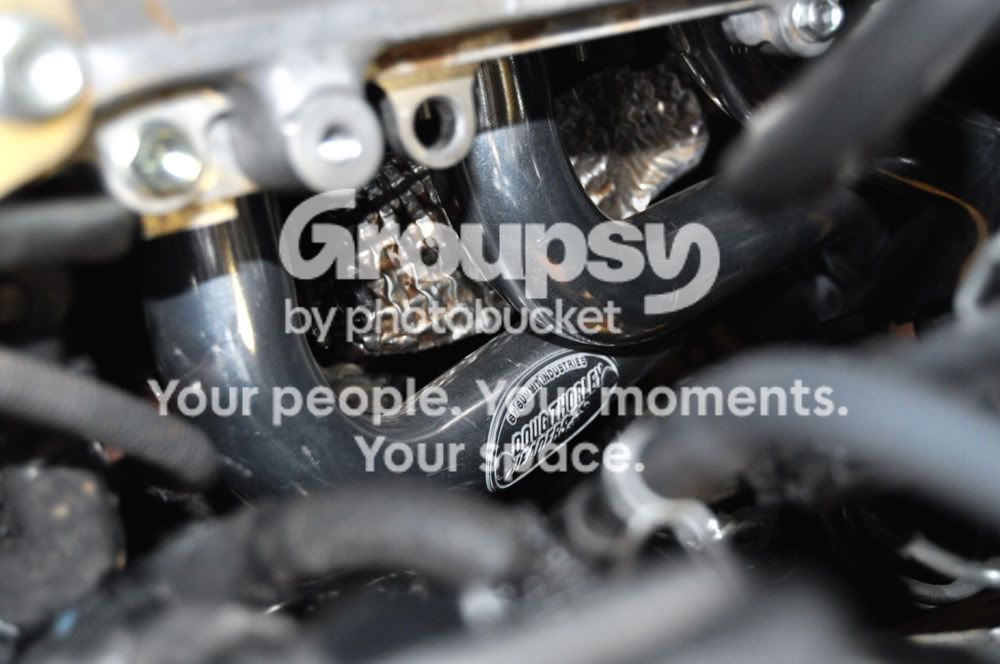

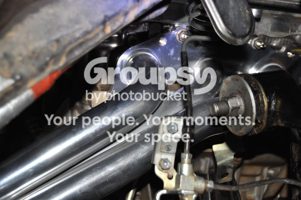

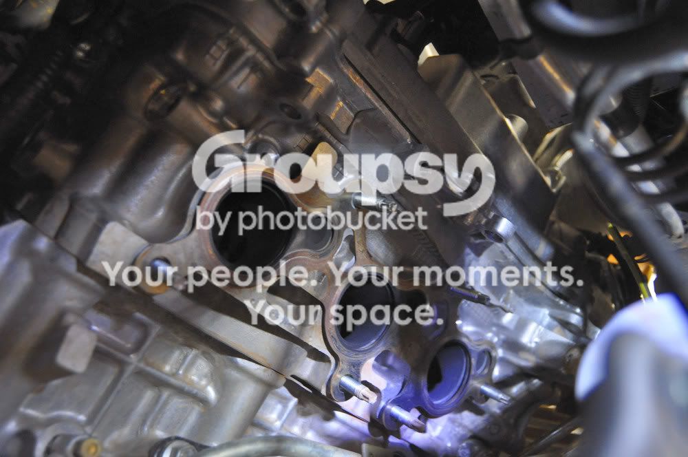

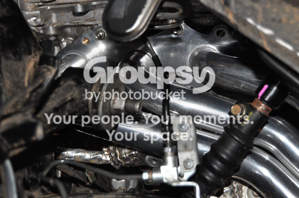

Here are a couple of pics.
Drivers side...that steering shaft with the pink stripe had to come out. It's a new kind with built in dampener and a universal. Alot easier then the old type with the round rubber disk and 4 bolts that attach it.
Picture007-3.jpg~original
Picture008-1.jpg~original
Passenger side
Manifold removed and a shot of the manifold gaskets and exhaust ports on the head. They use a stainless alloy metal of some kind for gaskets that is doubled and they were like brand new.
Picture002-3.jpg~original
Pass. side installed
Picture005-2.jpg~original
