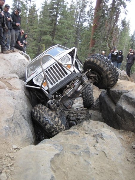

Looks like someone pushed some rock into WH3, it looks a bit different than the last time I was there.
They might have when they blasted the middle section a couple weeks ago. The squeeze is way rutted out now and full of gear oil. Pretty knarly section.
