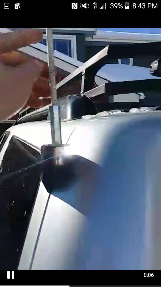

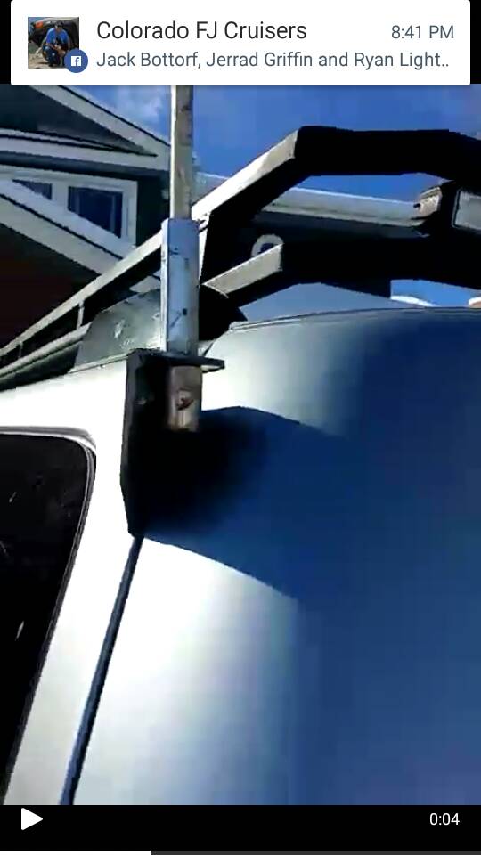

This is the redesigned 5th gen, it needs to be bent a little more so that the top sits level, we just ran out of daylight. The Mount is very soild, I grabbed onto it and could shake the entire truck just by the Mount.
Can we get a few more pictures? Maybe a little closer and a few other angles? Could you also take a few with the hatch open? That picture make is too hard to really make out the mount. Thanks.
Any chance of having it mount lower on the body? I have a very tall antenna and this would make going through a low tree canopy very difficult.
I didn't take anymore for some reason and then we ran out of light, I was working at a buddies house. It is a very similar shape to the 4th Gen mount now, and I have more picture of that is that works for now. I honestly couldn't find any other way to mount it lower, there wasn't a good way to keep it snug to the taillight. I would recommend a 1 or 2 foot antenna.

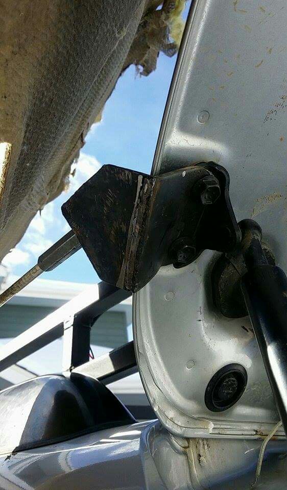

Here's my concern. Based on experience with other hatch mounts, the ideal swr is hard to achieve because cb antennas work off a ground plane. The ground from the hatch to the rest of the body doesn't appear to be ideal. I'm wondering if there had been any testing or tuning yet to show that these mounts will actually ground properly to get a decent swr.
We did test the 4th Gen mount. We borrowed a 1 foot antenna from another truck and he could hear clearer than with his current setup
It was just a thin flat piece that mounted behind his bumper. He wanted a new setup and when I told him about using the strut mount he was very excited
This is the 4th Gen, it sits about a half inch further out now to help clear the coax cable, but you can see how with the antenna won't contact the roof rack with the hatch open
Where you have the new mount has very little gap between the body and the hatch. That location would need a super thin cable to get it in there. The gap is much bigger lower next to the tail light. Just a heads up you may want to check out before these go into production.
