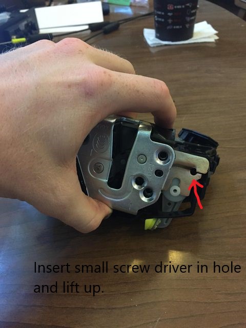

Just got through replacing the drivers door actuator and this thread was a big help. I did find a few useful things that helped.
Already mentioned but read the thread all the way through first, I had to go back and reset the door handle lever.
Rolling down the window helps a lot in rehanging the door panel but reinstall the actuator assembly before rolling it down.
The metal faceplate pops right off with a screw driver, see pic below.
