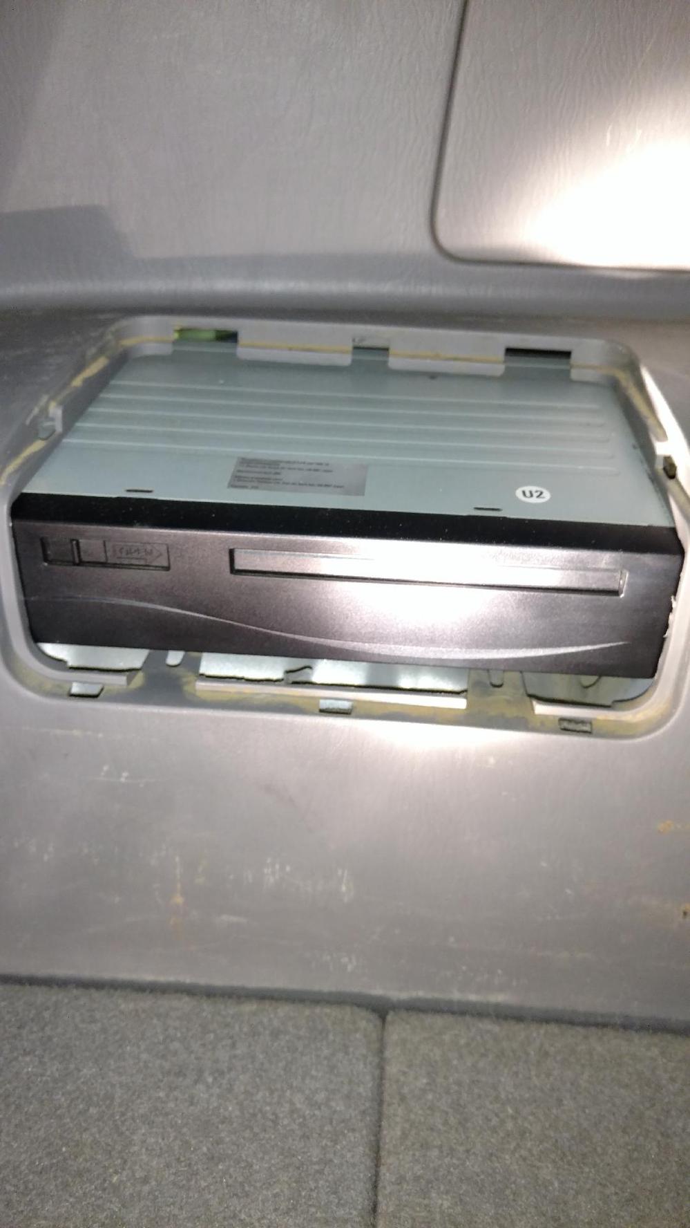

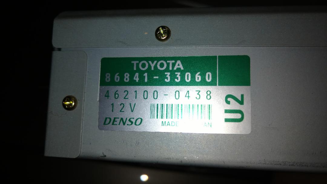

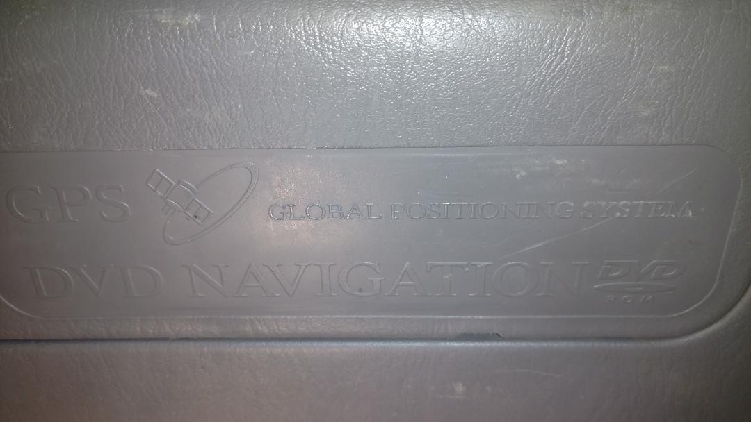

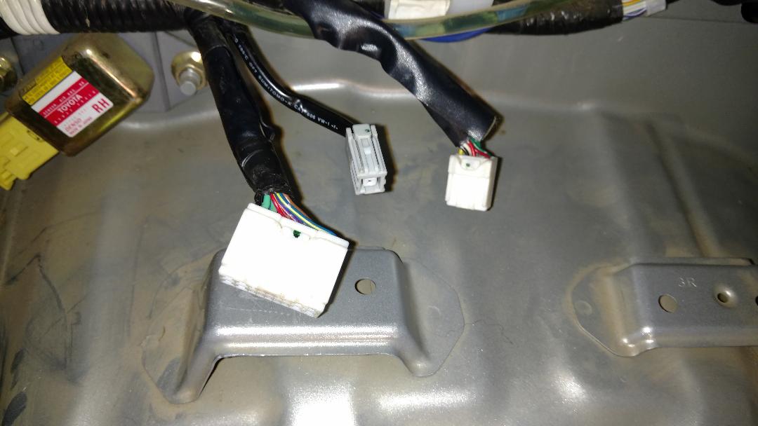

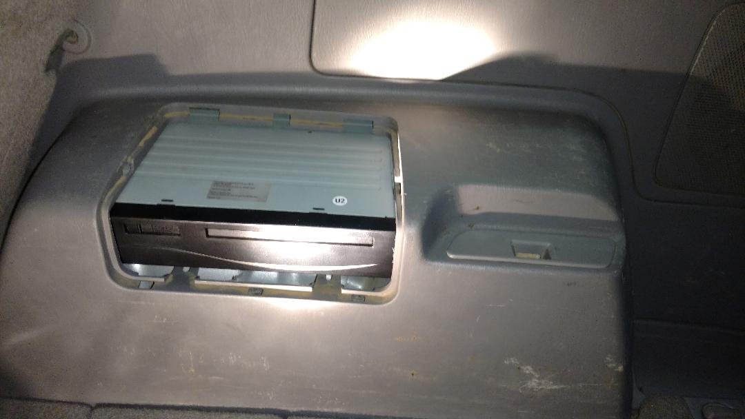

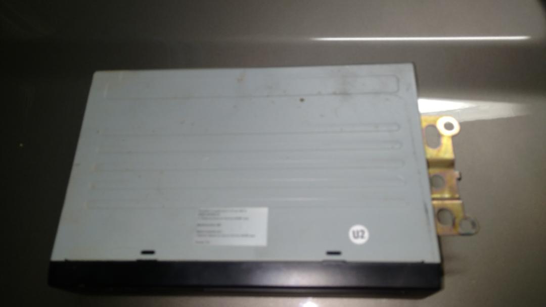

Holy F! I figured it out by throwing crap at a wall and seeing what stuck. I removed this lovely item when I had it apart because it was a DVD/Navigation component of the old system? O.o Well apparently my front driver's side door speakers are somehow run through it.
Anyone have further information on WTF?!?! Thanks :)
