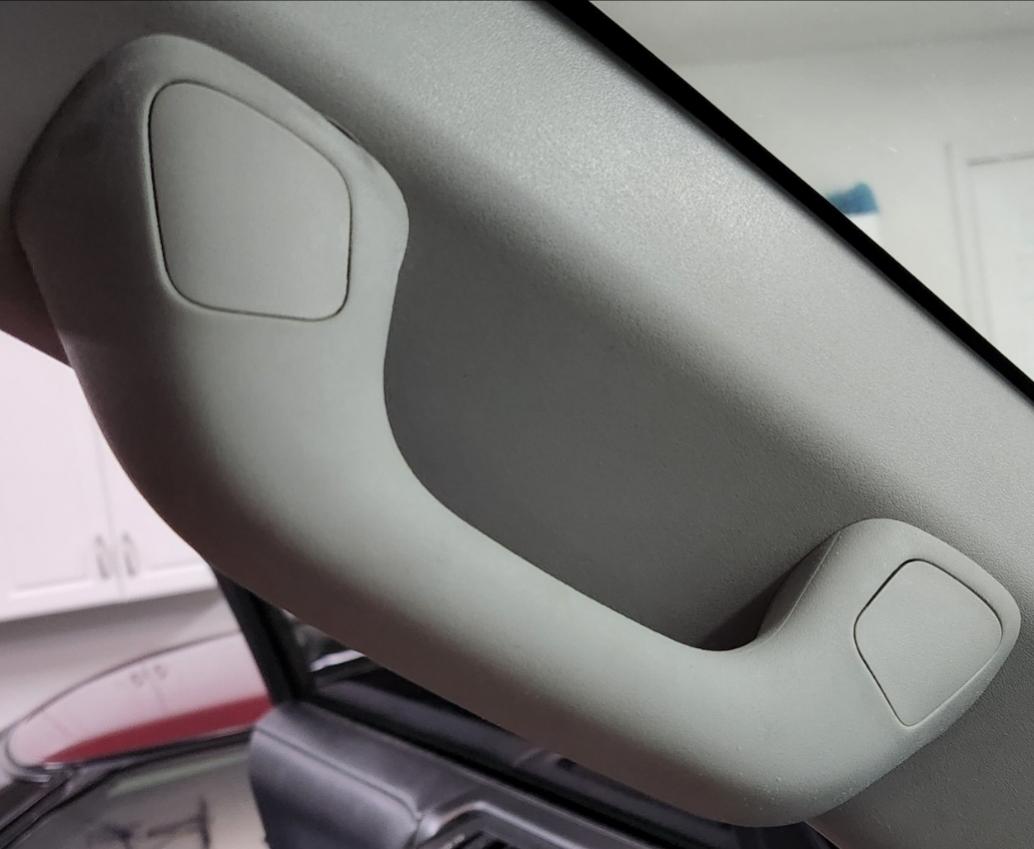

The KTJO kit for sure works 100% with Jasons bracket. Zero trimming just align the bracket, drill, mount and then slip the KTJO trim on and secure handle.

Okay, finally got around to doing this. Logistics was my enemy, lol.
Anyways. Install was fairly easy, scale of 1 to 10, a 4. Measurements are key.
I recommend the second bolt you tap in, use a silver, gold or white marker and mark the hole where you need to drill. Take bracket off, start to drill it, then stop.
Put bracket on, with washers underneath the bracket on second hole for elevation issues, then slightly screw it in. Put top bolt in, use a flat on it on top for extra security, and screw it in. Then screw bottom one in..

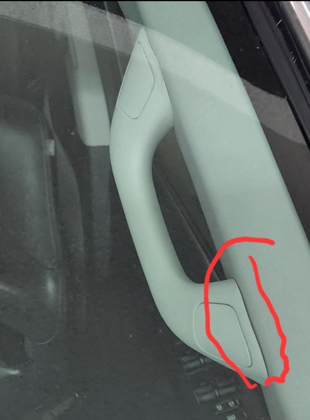

I flattened the bottom of the handle down, and I still have a slight gap. Cant see it unless you are in front of truck and staring at it. I highlighted so everyone can stare..lol/
I will address this later, washer is in need of my attention..
