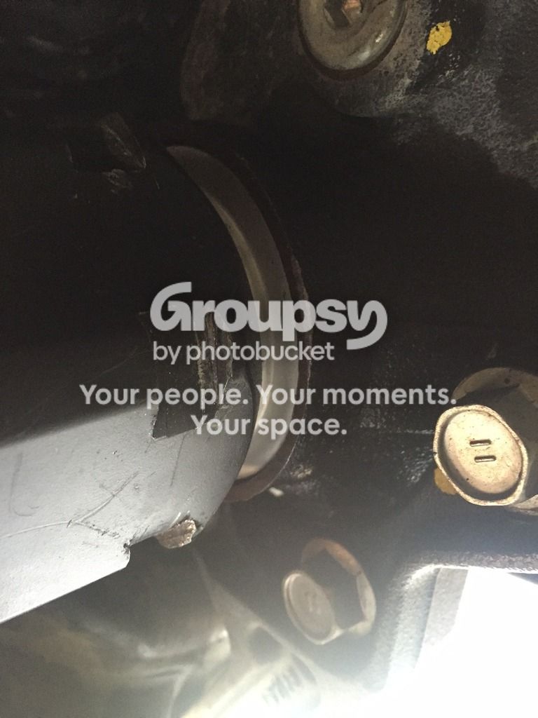

Here is how close it is:
image1-2_zpsnhcozqcd.jpg~original
You can see that it has about a 1/2" to go.

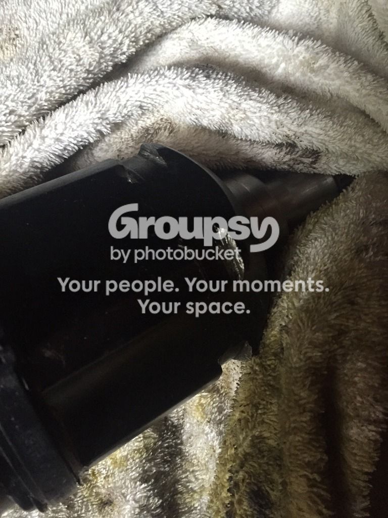

I even clipped the outside boot clamp and removed the inner pieces to smack the outer easier - still no luck:
image2-2_zps54m7bhkk.jpg~original

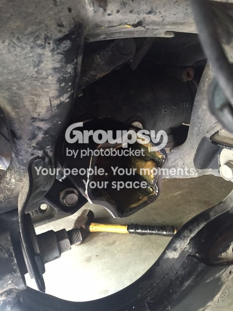

I have hit it so hard that I have started damaging the notches on the outer axle piece as you can see in this picture:
image1-3_zpsspul7wsn.jpg~original

Not sure from the photo but here's a possibility: It looks like the seal may be installed backwards, turn it around 180 degrees, the narrow section should be towards the inside.

That can't be the problem. I never took the seal out.
OK, thanks for that update. Not sure from the photo.
If that is the metal flange piece that is right after the tulip, and that piece is recessed within the opening of the casing, then you are done. Stop pounding on it and relax. It appears that it may be in far enough. It does not need to be far in, it can vary from 1/16" to 1/4". It is more of a dirt shield than part of the seal. If it is not within the opening, then yank it and try again. I opt for the clip opening down. Take another photo for us to check. Also, you probably should have replaced the seal while you were at it.
It hard to tell by the picture how for the axle is in. To me it all most looks in. The best way to reinstall the axle is to pack the area around the c-clip with grease (wheel bearing grease) it dissent require much. Once you have some grease in there you need to move the clip so the open end is at the bottom. Center the clip on the axle using the grease to help it stay in place. If you've done this the axle will go in with almost no effort. If not get a new clip. Stop forcing.
