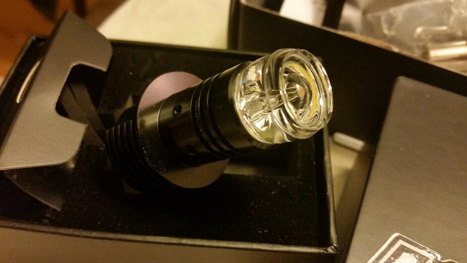

I've had my Tritons for about 2 1/2 years and continue to love them. Gives the 4R a "new" look (with all the LED DRL new cars have nowadays). Yes, they are bright, but don't forget to install the "dim" wire (connected to headlights), otherwise they stay crazy bright when you have the parking lights on. Then, yes, the light can be too much.
Note: I've had to change one bulb so far and another one has be changed. Not sure why this is happening, but they have a lifetime warranty. When I took out the defective bulb, it's still looked new. The metal base of the bulb looked new. Anyway, vLeds stand by their products.

I pre-ordered in September and still have yet to receive my order. In November they emailed me asking about how my drl's were wired. They said I would be needing their resistors (VLR-6), which is delayed. I had the option to continue to wait or get a refund. I guess it's better that I wait than get an incomplete product that still needs modification to work properly. I'm hoping they'll work the bugs out soon. I'm itching for some switchbacks.
Speaking of Triton V6, I pre-ordered mine in early September, and just received them in early January. I did not get the switchback and I actually turned off my DRL via Techstream. Build quality is excellent and pretty straight forward to hook everything up (other than the heat shrink wraps lol). With the VLR-6 resistors, they have been great so far for turn signals.
That's GREAT to hear and see! My "band-aided" V3 are starting to act up again. I'm ready to upgrade to the V6 tritons. I'll post pics. Oh and yes, one MUST get the resistors to prevent hyperflashing. It is quite annoying.
