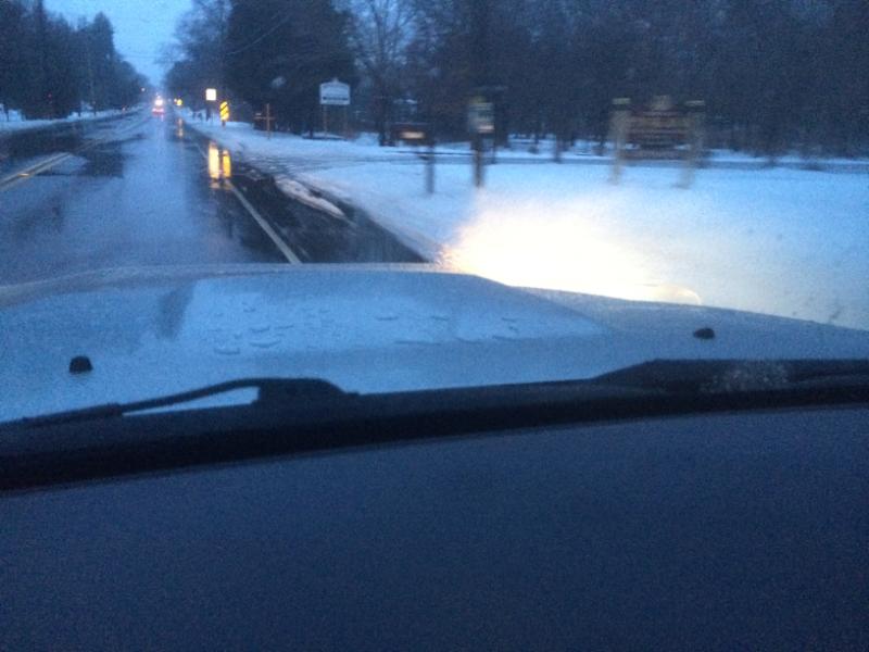

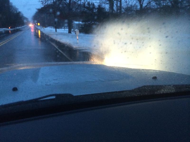

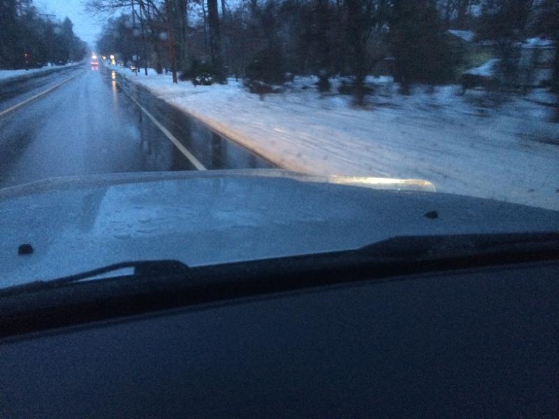

UPDATE: Drove though nasty slush, rain, and deep puddles this morning.
The Teflon and trimmed rubber gasket held the moisture out.
The photos show the T4R splashing up one of those cold deep icy puddles while I watch from the comfort of my after market heated seat! You can see the front end getting totally wet. No moisture entered my light.
Again, according to VLEDS, you should NOT put Teflon tape on the LED shaft under the collar. NO No no... (If you do so, you may risk over heating the lamp shaft. So do so at your own risk)
BUT, take a look at how loosely the collars fit. Install the LED and see if some of the light is escaping around the gasket.... Do the math.
I might have put a little too much on mine (3-4 wraps over the whole LED shaft.) But I think a little around the adapter collar... will help with moisture, and a little where the two heat sink collars meet... will keep the collars from getting loose. I think common sense here should prevail. So far, my lamp has only gotten barely warm with no problems.
