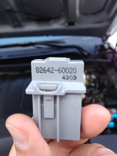

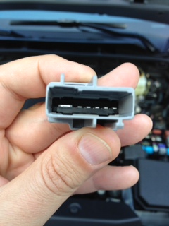

I went on the online Toyota service manual site and researched it. I'm attaching the PDF files I made with a diagram of the system from the relay to the ECU. I'm not an electrical guru but I asked a couple of friends to take a quick peek though. It looks like if you got rid of pin #2 on the DRL relay in the fuse/relay box under the hood it should kill them.
As I don't know much about wiring in cars and I don't see how you could take this relay apart. Also I'm a little hesitant because a replacement relay is over $100, and I don't know if killing that pin will do it nor do I know if it will have the desired effect (keeping auto headlights) or if there will be any side effects.
Take a look. I'd love to figure this out.
Pin two is the second to the right.

Has anyone checked for a DRL fuse? 90% of vehicles have a designated fuse for it, unless Toyota fall under the other 10%... I havent looked since I like my yellow DRLs (replaced bulb)
Kid can was right. I cut the green wire under the number 2 relay and it kills the drl's without any problems with the high beams. Worked like a champ.
