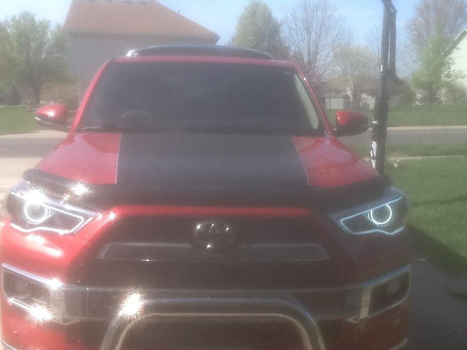

Has anyone come up with a way to disable DRL and leave the headlight switch in auto or has anyone figured out this pin 2 or green wire mod?
I have added halo's and LED strips to mine that run independent of the DRLs but want to be able to disable the DRL yet still have brights and use the auto headlights.

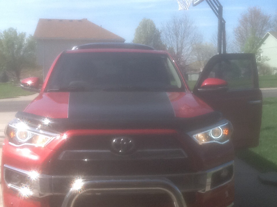

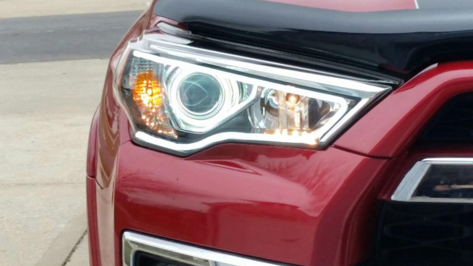

It was very simple. I pulled the relay and instead of cutting pin 2 I bent it down and formed it so that the relay can still be plugged in. Now my lights work in auto without the DRLs on and my modified headlights, halo's and LED tubes look great.

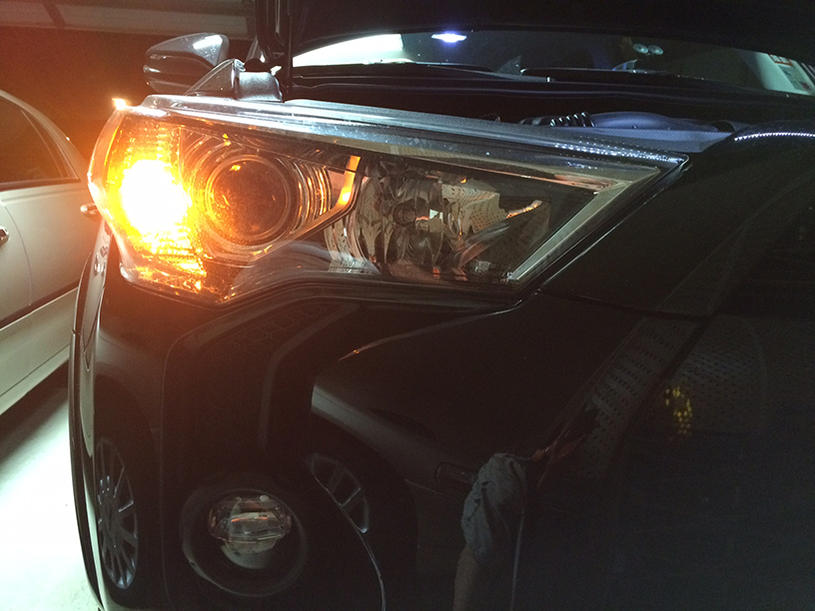

Another look with brights on
I pulled it in the garage and the auto works.

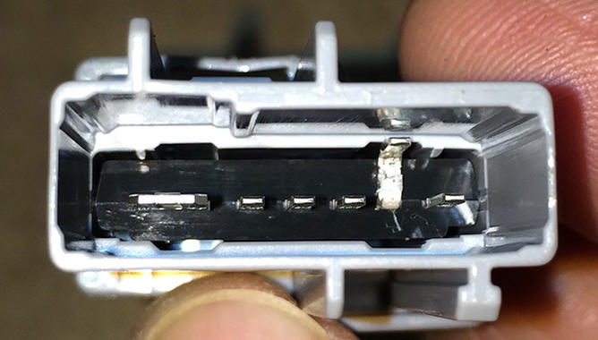

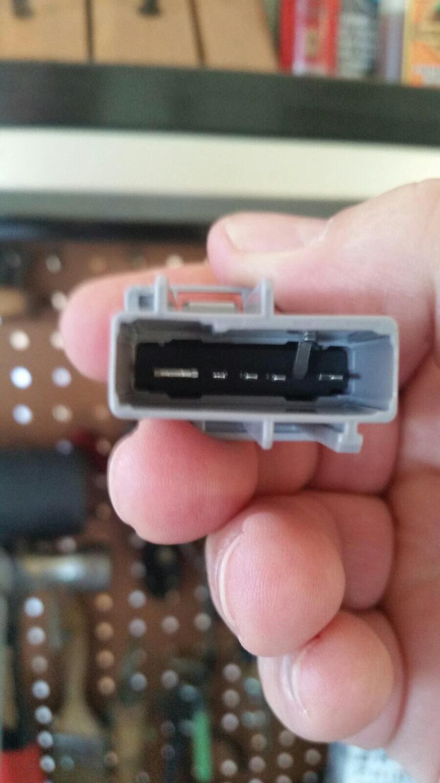

Some more pics
Here's another pic, this is the relay showing pin 2 bent and formed. I'm not sure what you meant by the other question but I can tell you everything works now except for the DRL. The brights work the flash bright works and all other light functions. The auto works as designed and all other switch positions work as designed.

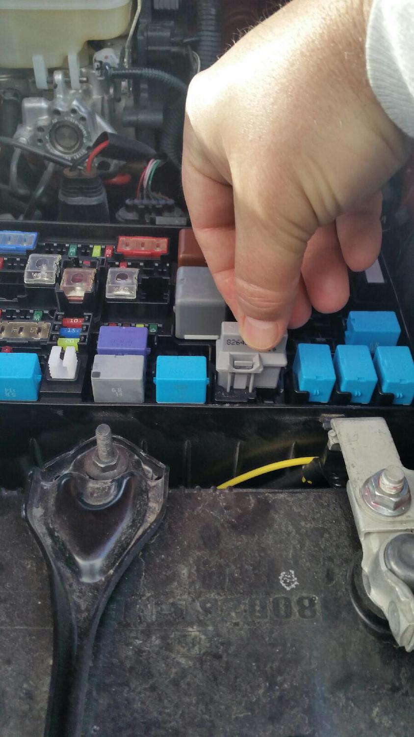

One more pic
This is the position of the relay in the fuse box. I could most likely bend pin 2 back in shape but that would weaken the pin so I wouldn't want to do it more than once.

DRL Disabled on Non "Auto" Headlights System on my SR5 Premium.
So disabling them is the same as Auto Headlight systems, by bending pin #2 out of the way without any adverse issues!
I used a pair of needle nosed pliers to bend the pin down and firmly to the side as pictured.
DRL's don't come on.
Parking lights function as normal.
Low Beams and fogs function as normal.
High Beams function as normal.
Tail lights, stop lights and turn signals function as normal.
Thanks to [MENTION=4160]KDCane[/MENTION] for starting this thread!

So, here are my photos of the relay and the parking lights on and NO DRL's !

I will provide more confirmation that this works like a charm.
Just take a flathead screwdriver and push the pin back. Took all of 10 seconds.
Thanks KC Fan for actually trying this based on the information that was posted before!
I suppose the good thing is if you ever wanted to have DRL again you could either bend the pin back or get a new relay. No wires had to be cut.
I have to say I am thoroughly pleased with the outcome of this easy mod not to have DRL's burning and my parking lights on.
