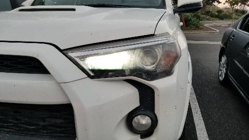

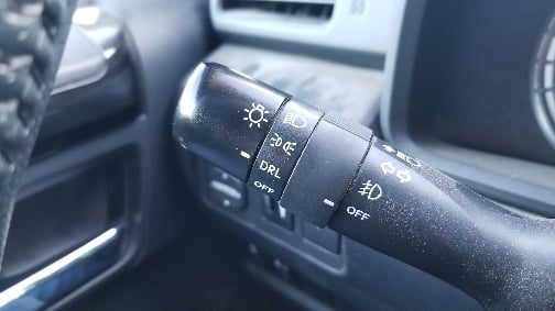

My 2018 TRD Off Road does not have auto headlights, so I noticed that when the lights are set to DRL only the low setting for the highbeams come on, no side markers. My hope was to have the side markers with no highbeams at all when set to DRL. Is this what you have done?
The picture attached is my headlight set to DRL.

In the normal DRL mode, the High beams are on at a reduced voltage...9v.
This is achieved thru the DRL Relay.
So, your headlights are configured the same as mine..."No Auto Mode"
So, by bending the pin on the relay, that makes the DRL not function, then you can turn your lights on click past DRL and achieve what you desire.
No DRL, Parking or running lights on, no headlights lit...
I think this may be what you desire, if so....follow the examples in this thread as others have done.
