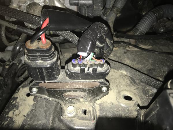

Well, I got this part figured out and I thought I'd post my solution here if anyone wants to do the same, after doing the DRL headlight disable mod. Useful, if your changing to non-dimmable LED high beams, and still want your DRL compatible fog lights to operate in DRL mode. Another nice feature with this solution, is the DRL fogs retain the original time delay off function when the vehicle is turned off.
My fog lights have two wires (I assume all DRL compatable fog lights would), one that plugs into the factory fog light harness for normal operation, and one wire that was tapped into the high beam bulb connector green/black wire. I removed this wire from the headlight connector. Then I located a power source that had the same voltage that is controlled by the key on/off. There is a power distribution block just behind the fuse panel box.
The red/black wire, 2nd from the left, is the one you want to tap into. This wire is controlled by the key, and when you turn off the vehicle the wire holds power for about 60 seconds and then turns off.

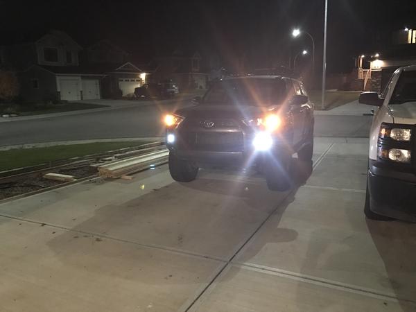

DRL fogs and marker lights on. (My cell phone camera makes fogs look brighter then they are.)
Where are these connectors located? I am also wanting to run fogs as DRLs. Seems like its much easier to do than [MENTION=65614]Antman[/MENTION]'s (love that dude and all of his write-ups!) version of independent fog lights...amma right?? :confused:

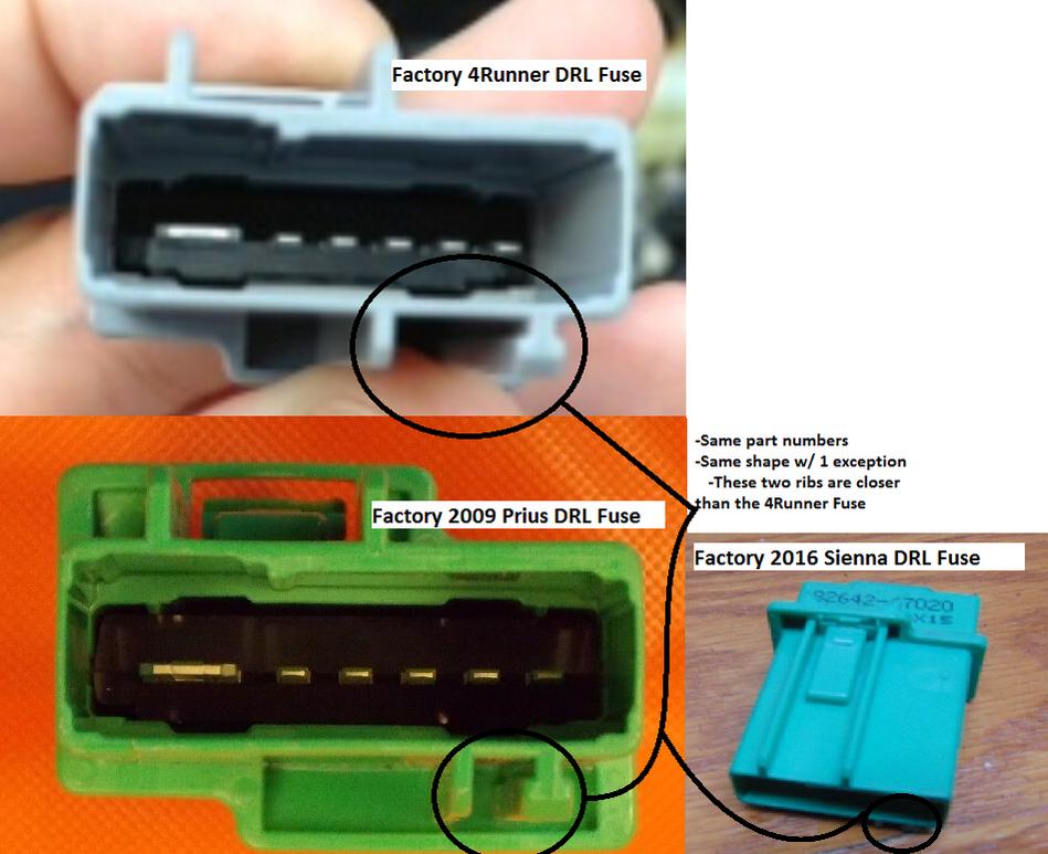

So I have also been curious on how to cut out the DRL function without affecting any other functions and the fuse solution that bends the pin seems to be the best option but that insane price for a replacement has kept me from pulling the trigger. I did some research and discovered that the 4Runner fuse shares it size with a few other Toyotas. The only difference I can find is highlighted in the picture. I bought the 2016 Sienna fuse for $20+ $7 shipping off eBay. All I need to do is grind one rib off and it should slide right in. I'll report back later today with how it works out.
Success! The 2016 Toyota Sienna DRL fuse works perfectly! I did have to shave off one of the guide ribs but a utility knife made easy work of it. All other functionality works as it should, just no DRLs.
2011-2016 Toyota Sienna
Part number: 82642-47020
I also found that the same part number fuse is used on a 2009 Prius.
I found a used one on ebay for $20.

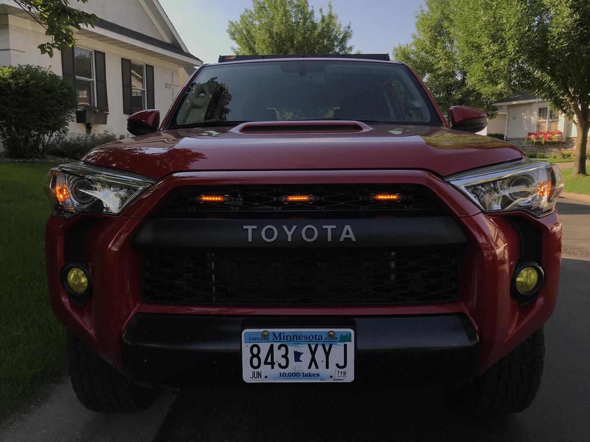

Just did this on my Limited. In AUTO, it does not turn on the marker lights, which I was hoping it would since I recently did the marker LEDs on the grill.
However, while in AUTO, the low beams and markers do come on when the conditions dictate it. At least I no longer have those annoying LED high beams during the day.

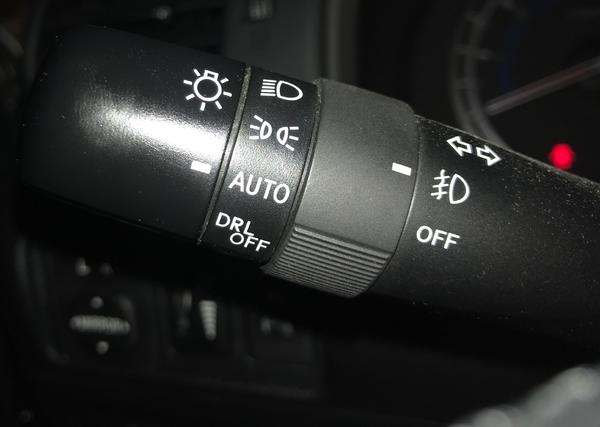

Seems like it is a little different on the 2017 Limited as I have the following switch positions:
- Headlights On
- Tail/Marker Lights On
- Auto (DRL/Low Beam)
- DRL Off - All lights off
I do not use the Auto function on the headlight stalk. I use the DRL position and the on position. Not a fan of auto lights!
