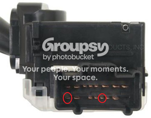

After testing the Solara stalk I found the two pins in red are the pins that control the DRL. I did this by using a test probe and 9v battery. The pins with the red circles around them are the ones you want to use for the DRL MOD.

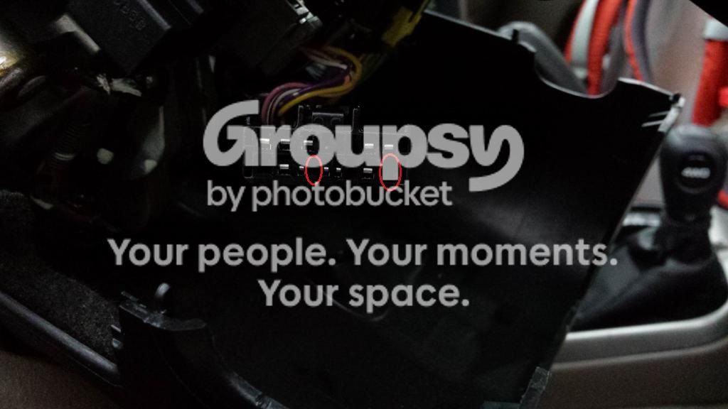

Here is the plug on the 4runner that connects to the headlight stalk. The two red circles are the terminals that you need to add wires to. These terminal locations match the pin locations on the Solara stalk.

You'll still need to perform the regular DRL MOD for this to work. You just need to cut the from the DRL module, splice in two pieces of wire, and run those wires up your steering column to you new stalk. Connect the wires to the pins I have mentioned, and you're good to go.
