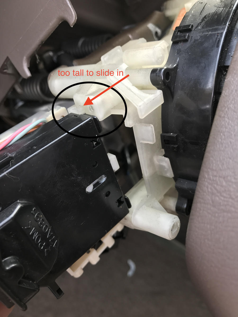

ok so the lexus es300 light stalk DID NOT work... its slightly too tall to fit into the slot where it lives naturally....
so i went back and got a 2002 solara stalk.......
this was also TOO BIG!!
went back and got a 2000 solar stalk.... this again was TOO BIG!!!!!
im so confused...
[MENTION=98153]MStudt[/MENTION] did you just have a stalk that was plug n' play?....
everyone i have tried so far has been slightly too large ( too tall )
:cry:

This statement says it all. The "pigtail" meaning socket that stalk mates to needs to be used as well, which is why we are having fitment issues. I'm assuming the stalk with socket will mount to the steering column as the origanal one did, swap electrical plug ends thus making it Plug n Play as Mike has stated. I have not been able to get my hands on both pieces when/if I do will know the rest of the story.

I went through the same dilemma as you did. Seems that the years 2000 and newer had the smaller design stalk vs the larger ones you found off other toyotas. The fix you ask? Either buy or find at your local salvage yard (like I did) and pull the ENTIRE column that holds both the headlight/wiper stalk! That worked for me and loving every minute of this mod. I pulled mine from a 2003 Solara with the drl off and fog light.
