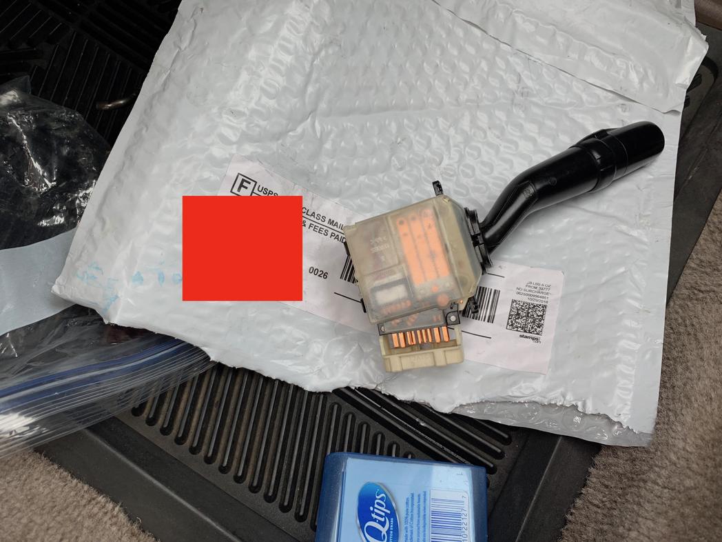

I just got a solara stock via ebay. It arrived today and it looks like the same exact one I already had from a 2000 limited 4runner. I remember that one not fitting into the steering column bracket. What the heck?
Anyone else have this problem?
Mendozer, yep have this problem also. Spoke with Mike plug n play for him.

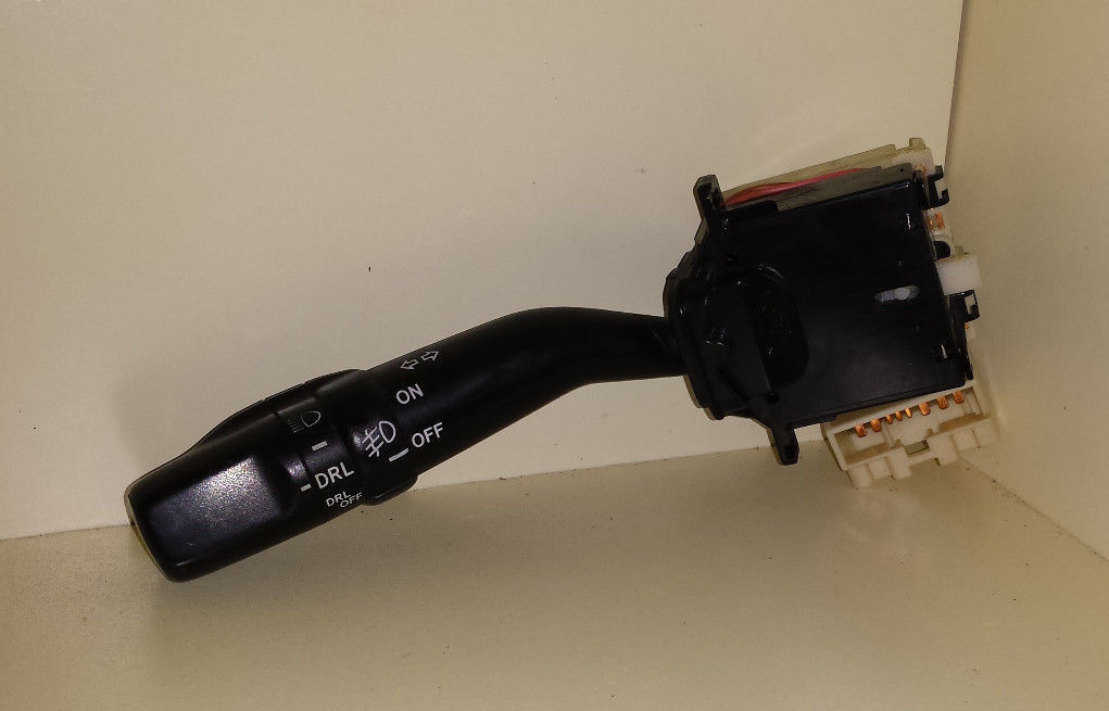

99-01 Solara had p/n, 02-03 p/n, 04 up p/n. all with DRL off and Fog switch.
There aren't any Solara's in my area so back to drawing board on this mod.
Dremel might come out, cut n tape wire, don't know yet.
You can get female sockets at dealer, look like pigtails in pics mike posted.

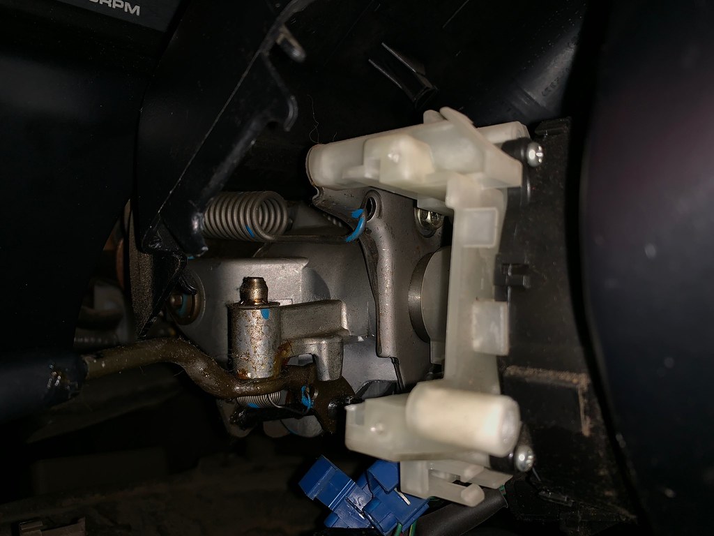

Ok so I know this is older stuff, but just in case someone wants this stalk to fit their car, there are two kinds of mounts that hold the left and right stalks. (it is the white plastic piece that screws to the steering column)
I have two runners, one 99 and one 00. This is when the white piece changes shape and accepts the newer style stalks.
Just make sure to disassemble your steering column bezels to find out which stalks you have before you buy the extra fancy one!

About to purchase a stalk with fog switch and DRL disable switch for my '00. Can anyone confirm that the '00 for SURE takes the Solara stalk?
Also--what kind of pins do I need to run new terminals in my plug? Thanks!
EDIT: bought it anyway. I have a couple left over toyota pins from when I rebuilt the KS harness on my 3.0.
I went ahead and disassembled my column out of curiosity (reference for later, maybe):
IMG_0791 by keaton.burleson, on Flickr
IMG_0792 by keaton.burleson, on Flickr

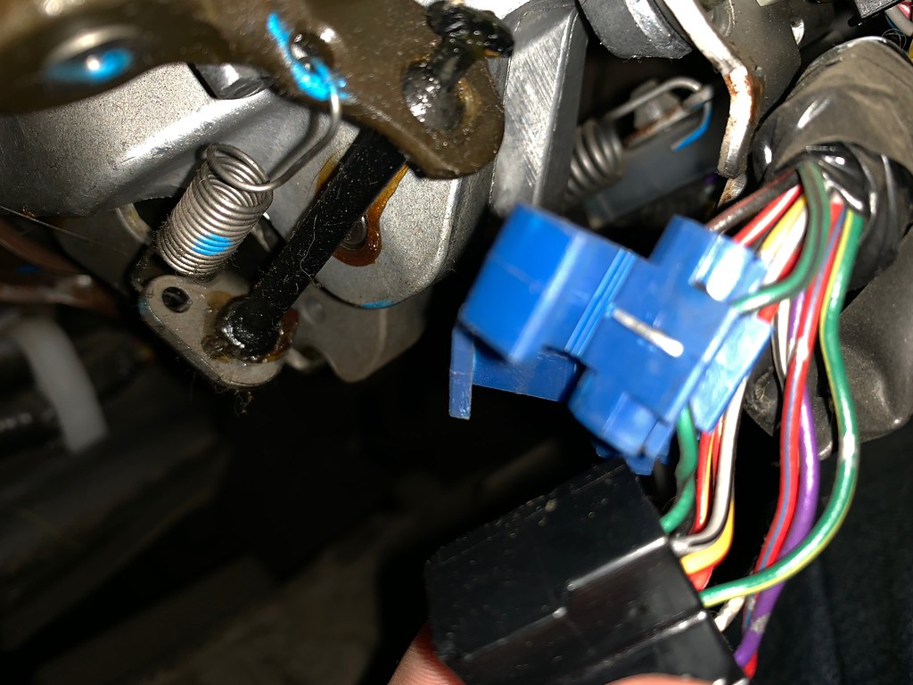

I dunno what the hell the PO was doing here:

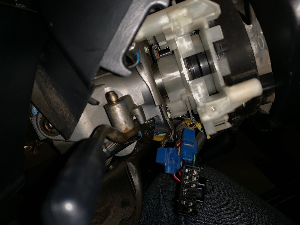

IMG_0793 by keaton.burleson, on Flickr
Every. Freaking. Time I take apart something electrical, I've discovered a hack job. Cannot wait to pull the radio and see what horrors await there.

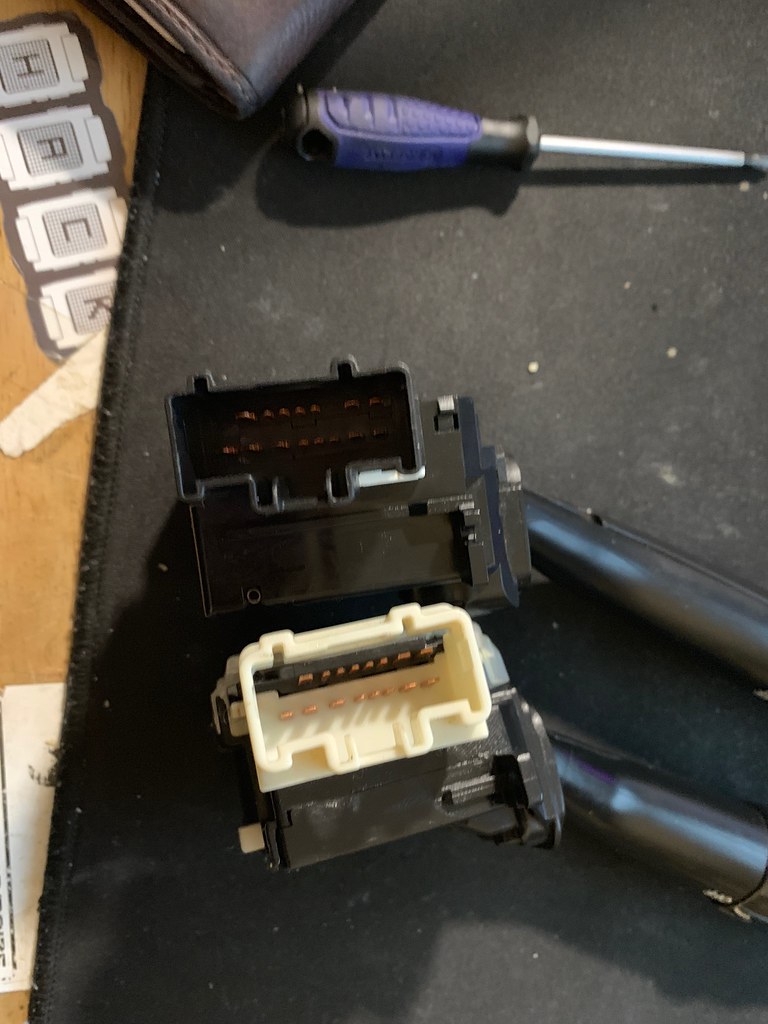

Okay--that stalk was too big. Looks like this mod really only works on 2001+, unless you find a smaller stalk. I'm going to look into trying to mod the housing, but I did disassemble it and found no way to swap just the guts over :(
EDIT. shoot! You might just be able to swap the stalks.
EDIT 2: You can't. I am now a certified Toyota-stalk professional :)
I could not find an easy way to swap the stalks. There are a bunch of differences internally. I'd hope that you could dremel out a spot in your column, but I'm wary of doing that.

IMG_0847 by keaton.burleson, on Flickr
The stalk mechanism is actually pretty neat in both, but operate slightly differently.
The Solara mechanism (top) is thicker AND taller (just slightly) than the 4Runner mechanism.
