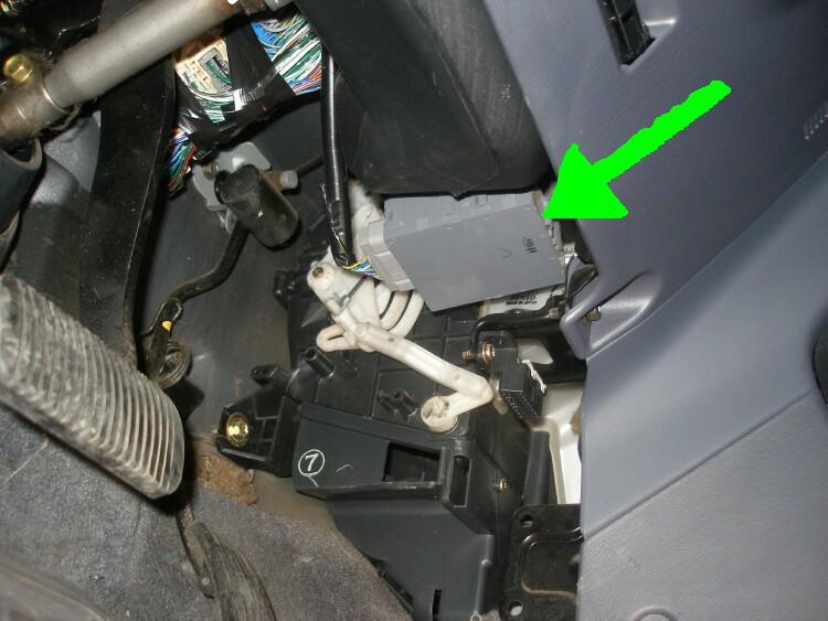

My 1998 model is "Canadian born" in order to disable the DRL on these there's a small grey control module under the dash next to the OBDII plug (close to center dash console). Just un plug connector and remove the BLK w/ yellow stripe wire pin and all from the connector and reconnect. 5 minute job.

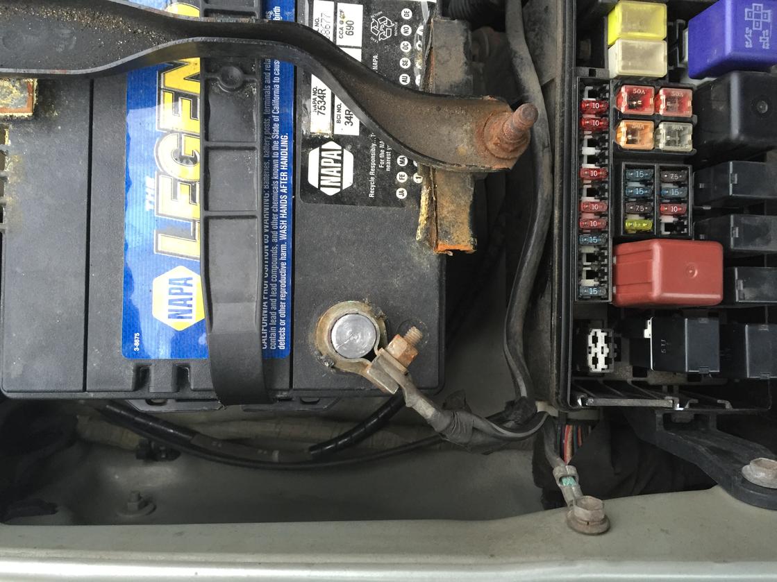

Not seeing this relay on my 99 Limited. See attached pic. Also, the pic links above are not working.

For those of you looking for a picture - you don't need it at least for the 2000 year, just pull the battery and look against the fender wall. 2"x2" module with a cage around it, just disconnect the grey plug. Problem solved.
