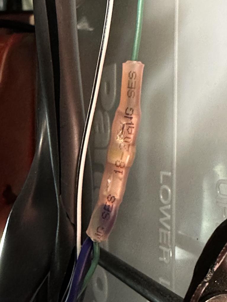

I just turn the DRL's off thru the screen setting. I run Lasfit Switchbacks and just keep my parking lights on. I also have the Diode Dynamic backlit fogs which also I run with the parking lights. I just tapped the wire going to the smallest side marker light as the backlight doesn't need massive current. Same with your raptor lights. I used crimp with solder heat shrink connectors and can't imagine they'll ever be a problem. I wouldn't do it with a non weatherproof connector or scotch lock or tap the injector fuse as many do under the hood.
