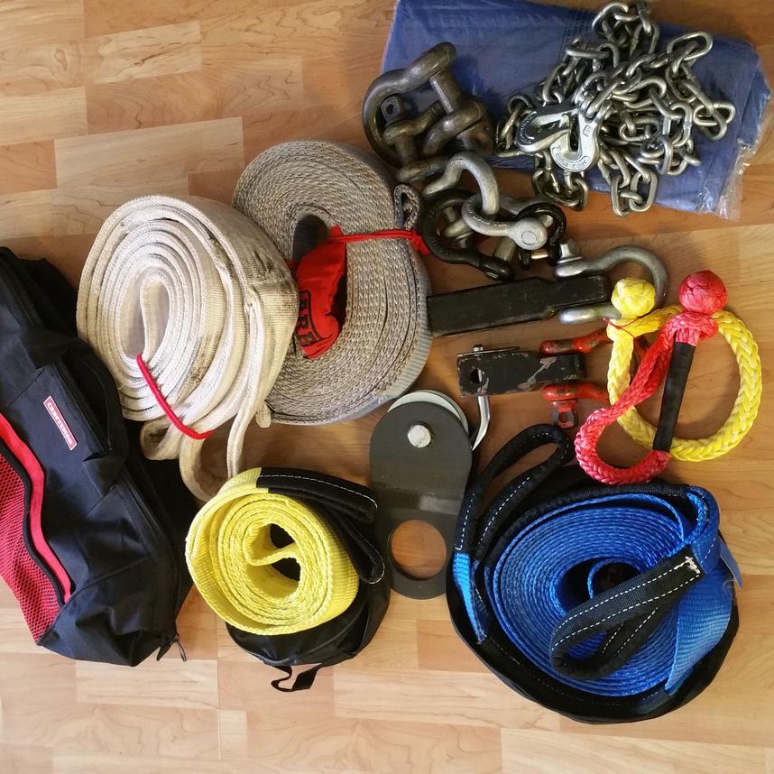

inventoried the Prius Winter Recovery Kit, with the addition of some soft shackles I figure I can shed a few pounds of steel by dumping some steel shackles. Some I have had for 25+ years. I have a ton more stuff for recovery, I would like to get a 50' winch extension sometime.
The chain is used to remove deadfall

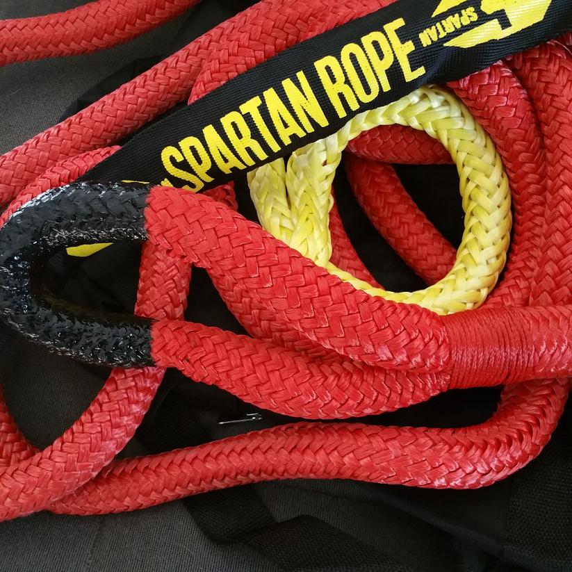

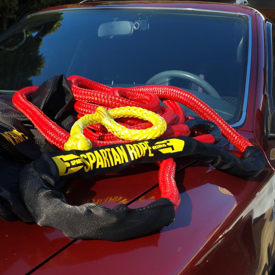

Took the plunge and ordered a kinetic recovery rope from Spartan Rope on Black Friday. Thanks for the recommendation @the_great_him ! Not only did I get a great deal on a great product but they dropped it off personally to my house. Totally unexpected, wish I had been around

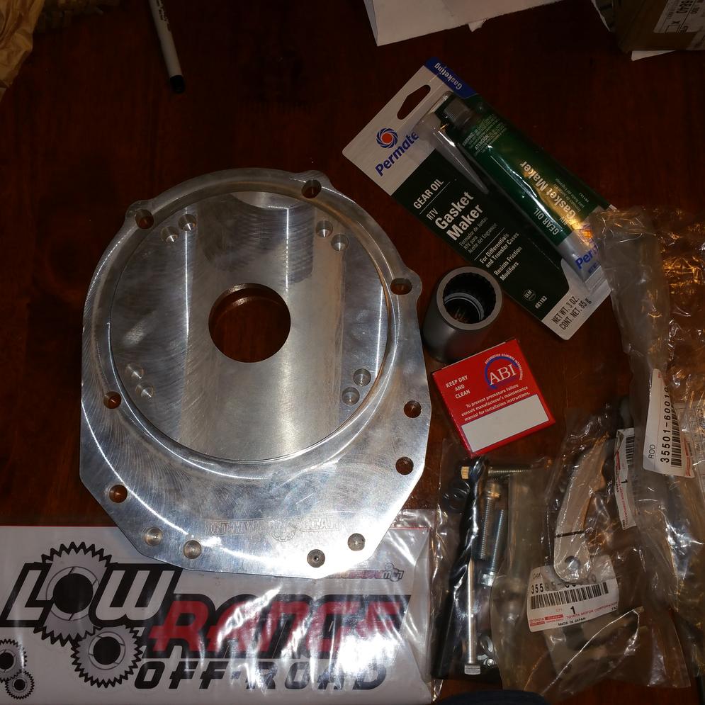

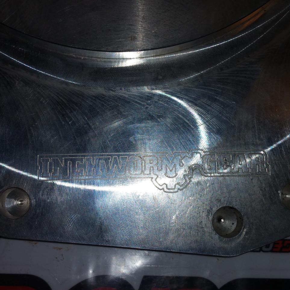

This pile got delivered a week or so ago, piled in a bunch of Xmas deliveries
Never pulled an auto transmission before so gonna be a learning experience but a good one

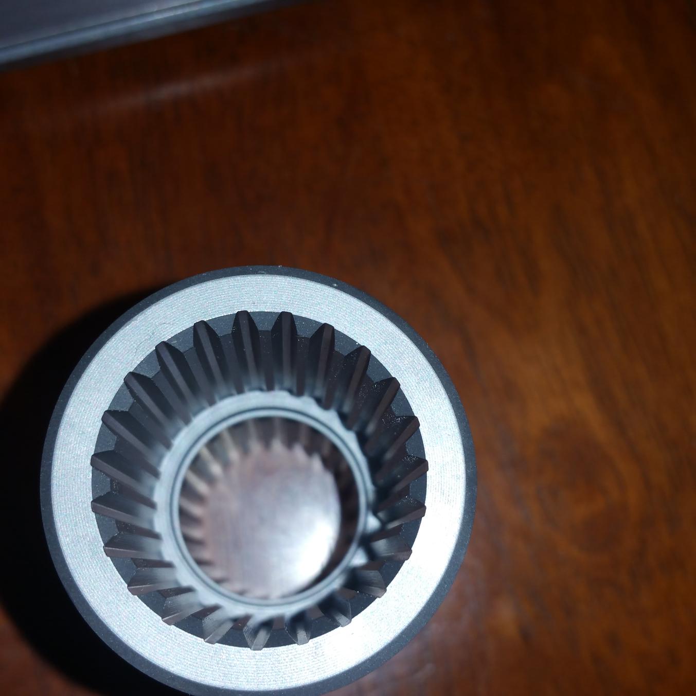

I was able to get the 23 to 21 spline adapter. Funny thing is was shipped from Advance Adapters. Hopefully the 21 spline duals out of my 81 survive for awhile, plus i have 2 more complete cases and a pile of T/C guts. Plan is to take it easy on this truck. Pretty much out of my rock crawling phase but want the option to gear down and not hammer on the truck.
definitely a size difference between the 21 and 23 spline
