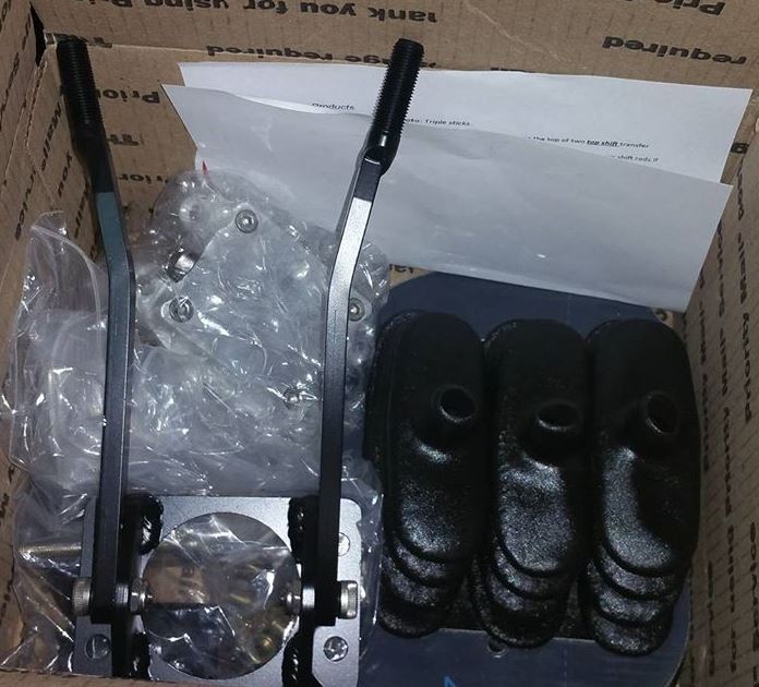

in an effort to keep the center console intact ordered one of Rory's Triple sticks.
I'll have to massage the transmission tunnel slightly with a hammer for a little clearance but this will help. I should have kept the triple sticks from the Trekker:der:

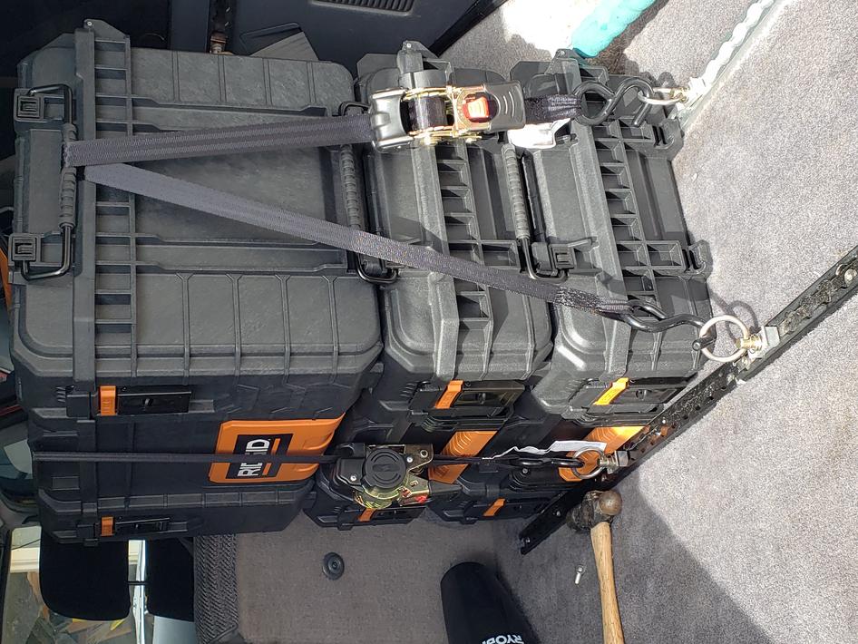

so i have been trying to come up with a storage solution for the back of this thing.
i probably haul too much crap on a daily basis with some tools, basic spare parts, fluids and some recovery gear.
I had 3 rubbermaid totes that have been around since i first got the Trekker. Great, durable etc but they weren't that great. A lot of wasted space both internally and externally. Not stackable etc.
I contemplated making a drawer system out of some 8020, the strut is stupid easy to work with and not priced bad. Some companies get crazy prices for their storage systems, great stuff but I am not gonna spend over a grand on a permanently mount drawer unit.
One of the guys I follow on instagram uses his truck to play on weekends and a full blown work truck during the week. I saw that he was using some Rigid Tool boxes. Googled them, found them at home depot. Lockable, water tight, stackable with integrated latches that allow them to interlock. And the killer part, they aren't all that expensive.
So i figured I would give them a shot
20180327_164834 by ocdropzone, on Flickr
20180327_164827 by ocdropzone, on Flickr
The smaller case come with an organizer deal for bolts and has an inner piece of plastic. I popped that out for a little more room
20180327_164917 by ocdropzone, on Flickr
i need to add a center tie down point but you get the idea.
20180327_171536 by ocdropzone, on Flickr
It is nice to have the majority of the back of the truck back for costco runs and crap. They make some milk crate style cases too. Thing I like about it since it's modular you can pull or add a case when budget allows or you don't need some stuff and just pull the case off the shelf when you need something.

Added another s track tie down rail and picked up some self retracting ratchet straps. These are nice, push the button and it retracts the slack like a seat belt and tighten as normal.
They secure the boxes nicely.
