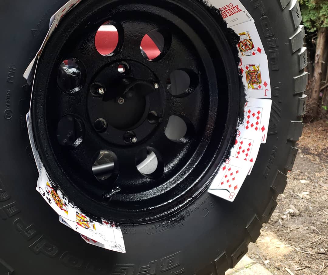

took a gamble and used some black monstaliner on the rims today.* Saw a post a few years ago where someone used a desk of cards to mask the tires.* Worked awesome.
it worked as a good experiment to let me know how monstaliner sets up for when I paint the whole truck
. Not perfect but it will do

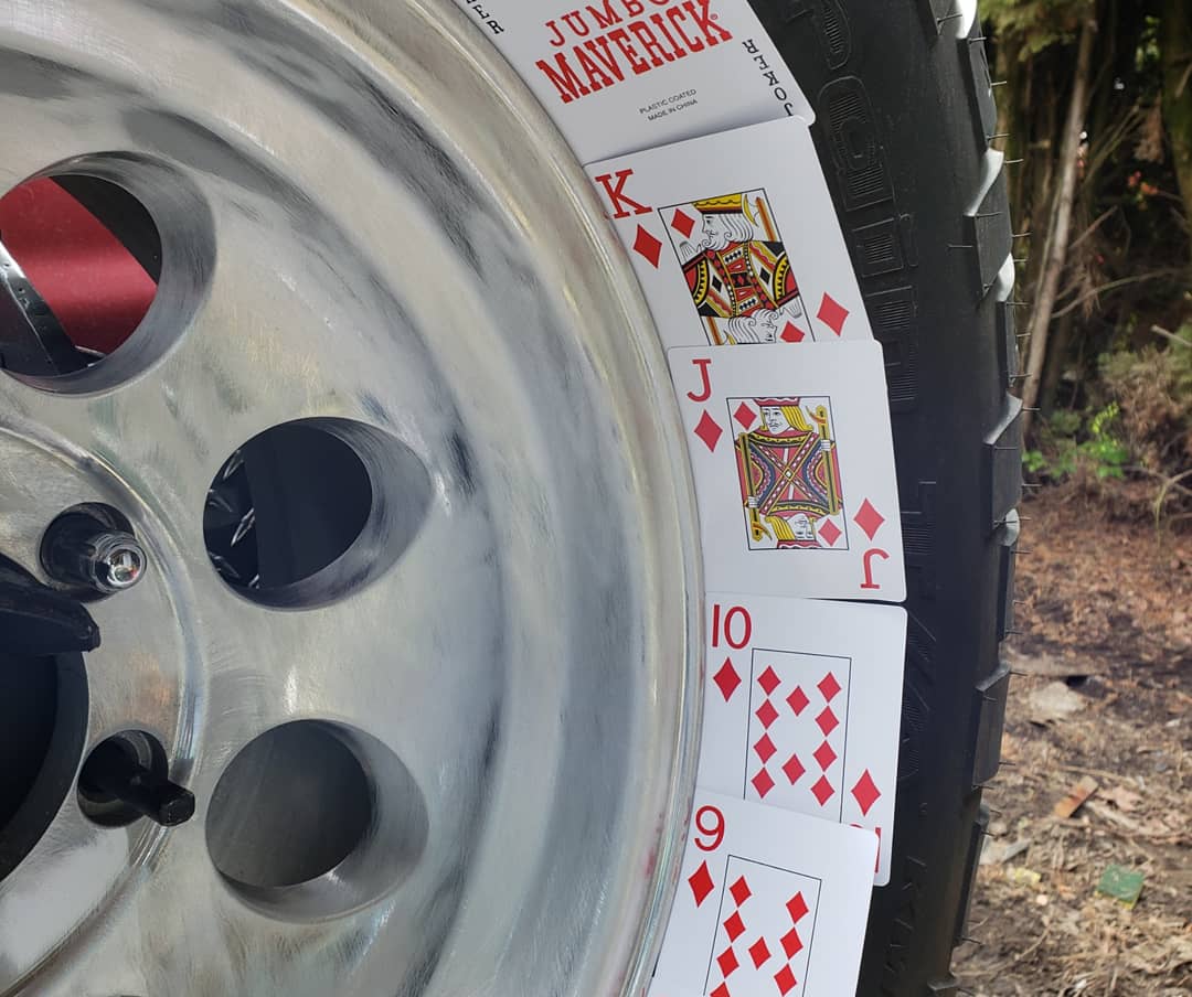

Thats a great trick, I might have to try that! Is the finished product as textured as it looks wet? What kind of prep work did you do to the aluminum? Looks great!
I wish I remembered who I saw use that card trick. Way faster than using masking tape.
Finished it still has a textured look to it. I sort of dabbed it on with a brush since could not use the roller like I will be able to do the whole truck.
For prep I used a couple of different wire wheels in the drill, than a little bit of hand sanding with some 150. Cleaned it with some acetone before 1st coast.

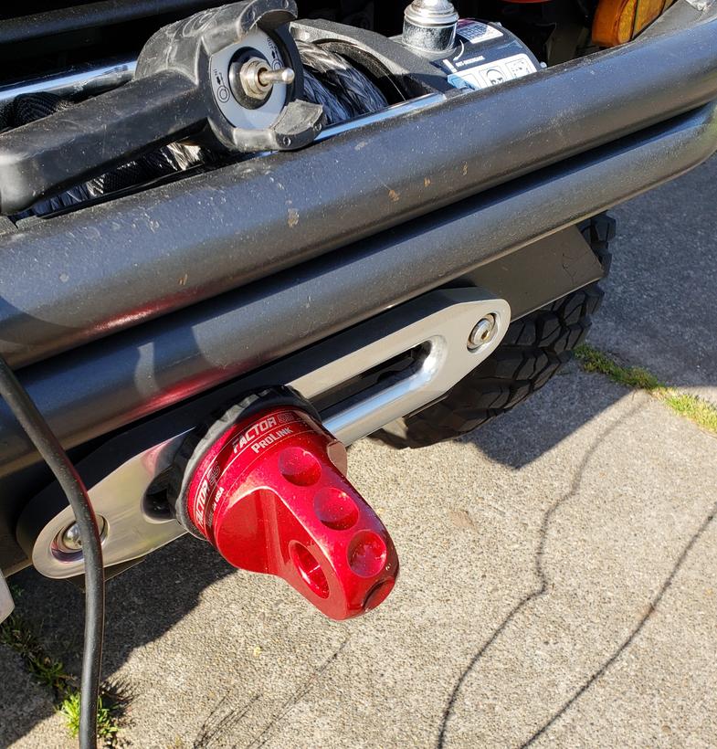

Got a smoking deal on a Factor 55 winch thimble.
​​​​​​​I love 5 minute mods that increase safety
had a question asked on another forum about why using a winch thimble:
I thought long and hard before spending the $$ on one of these. I did get mine for about 2/3 of the retail cost for one of these. It was NIB but I get lucky on ebay sometimes.
Anyway:
from Viking Winchline
"The Safety Thimble is designed to prevent the thimble from getting pulled into the fairlead where most accidents happen in winching, often due to winch "run-on" from electric winches"
from Factor 55
https://youtu.be/A6EEwCvtqLo
Allows for closed system winching. Much easier to hook up a strap etc to the thimble using a steel or soft shackle than hooking stuff to a hook.
Also not as tempting to hold on to the winch line when spooling the cable back in.

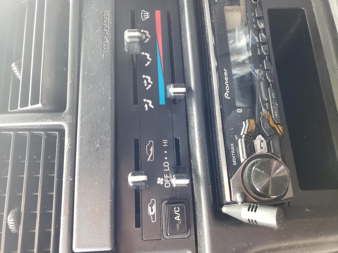

My grandson loves flipping switches and stuff in the 4runner. He is a pro at losing the heater/fan control knobs.
I hit pick and pull today looking for misc junk.
Scored a gas filler door with a good spring.
Took a peek inside a 93 Corolla, always sort of liked them.
I looked at the dash and saw all the controls were still there. Decided what the heck and pull the HVAC knobs.
Got into the 4runner, well guess what they fit like a glove. Much tighter than the old ones. Grandson would have to pry them to get them off now

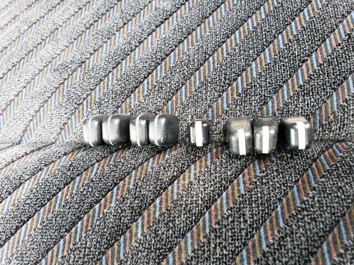

4runner on left, Corolla on right
Bottom pic with Corolla knobs.

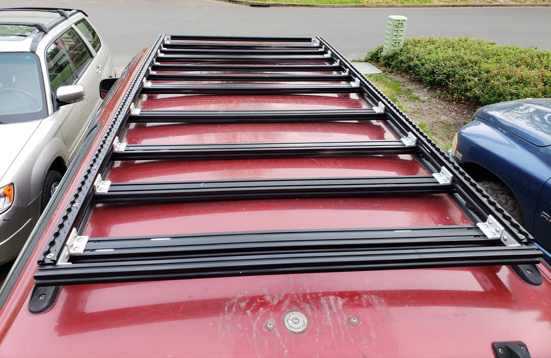

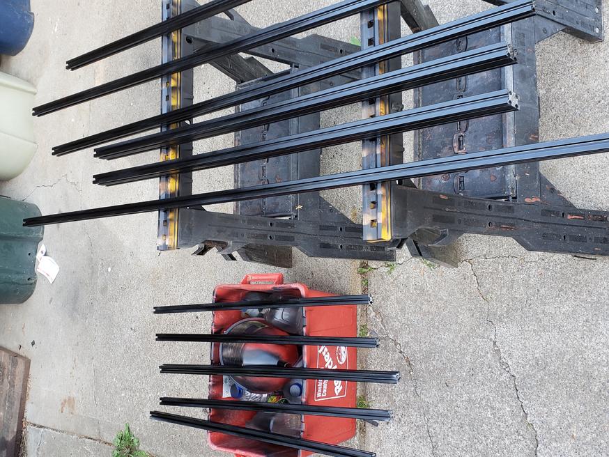

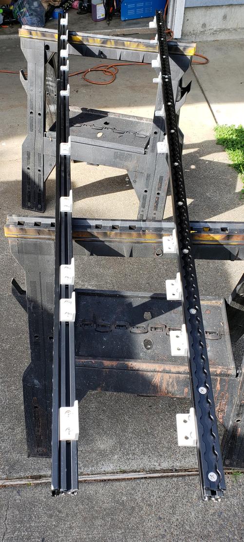

Felt like a little kid playing with an erector set today. A bunch of 8020 strut, 88 button head bolts, 28 angle brackets and I have an addition to the rack I started a couple of months ago.
it needs a little touch up, it will get pulled in a few weeks when I paint the truck.
it ended up about 3" high.* Not too bad heightwise.
​​​​​​​it was a fun afternoon project

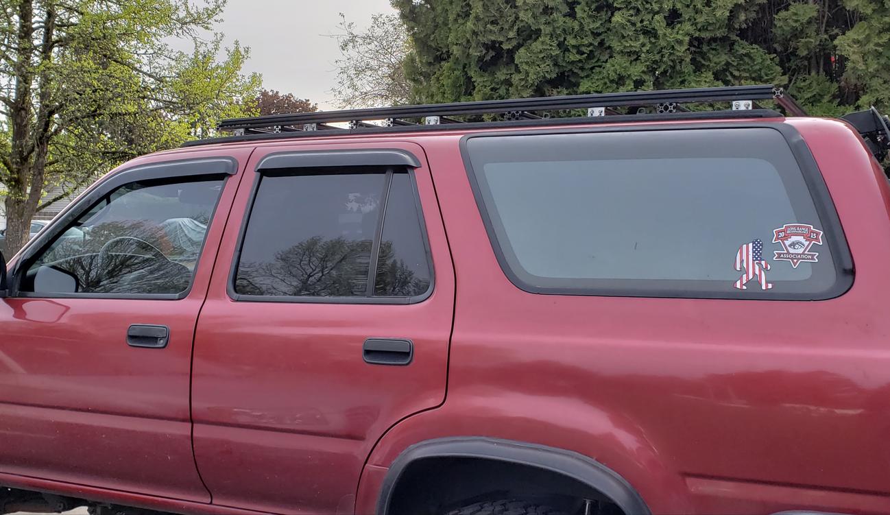

added a piece of 8020 quarter round to the leading edge of the rack.
It cut the wind noise down by a ton. i can hear the tires hum again

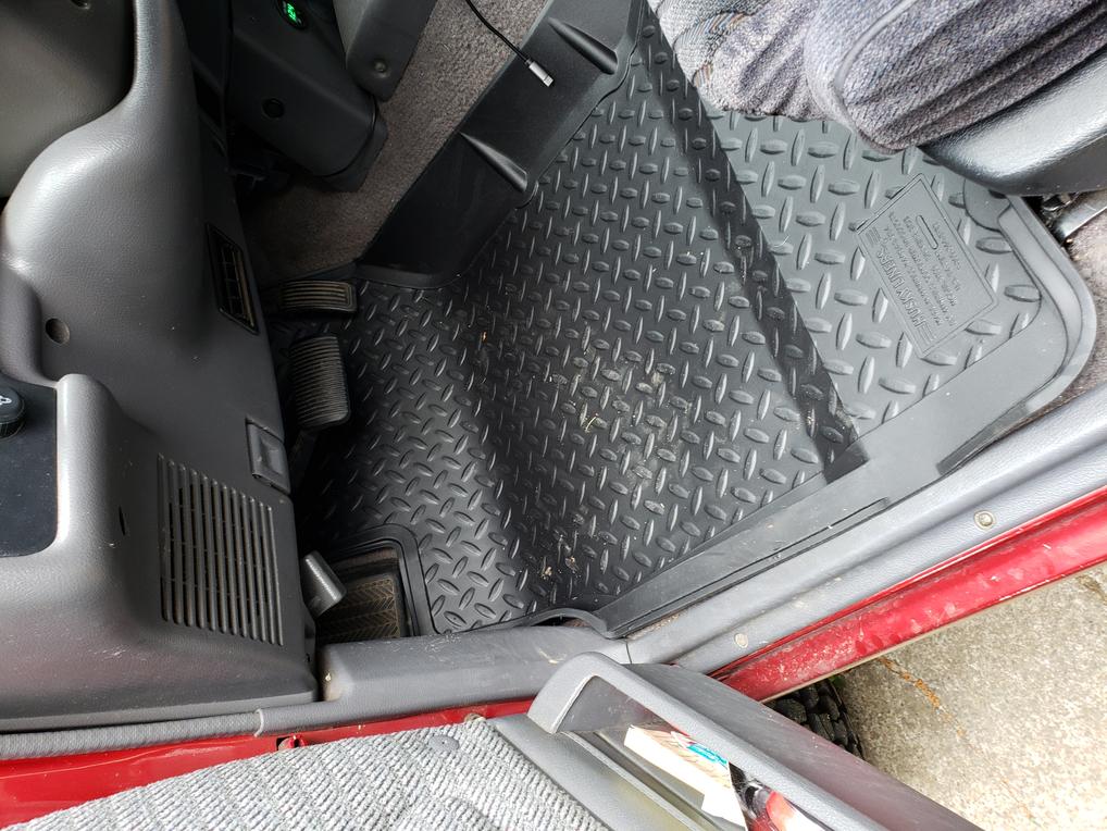

Got the 4runner through emissions today. Big relief since the old beast has 204K on the clock and the 3.0 can be finicky
Also threw in a set of Husky floor mats. I was surprised to find out they were still available for 25 to 30 year old 4runners.

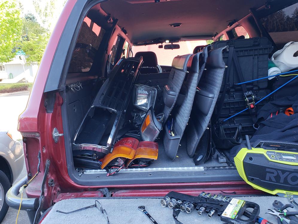

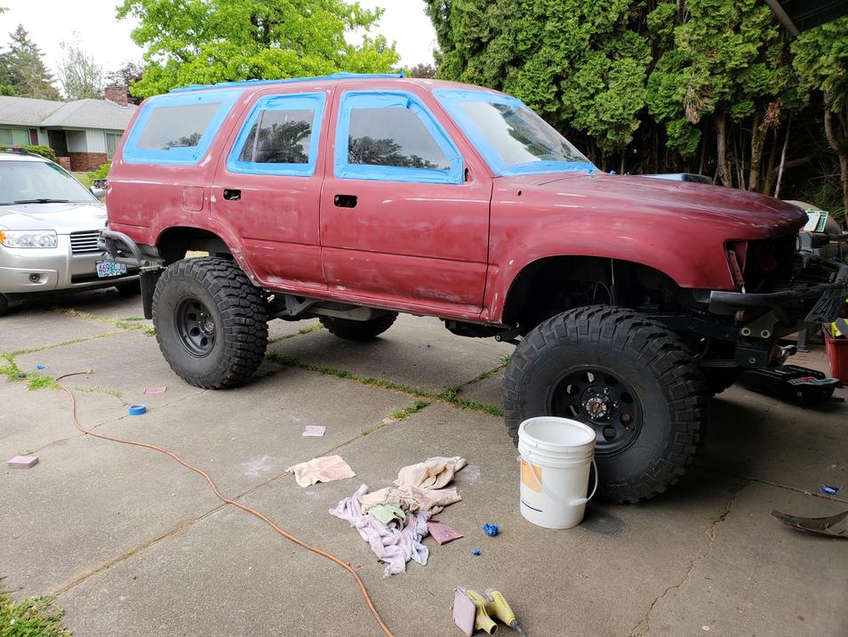

Started stripping stuff for paint prep
Will pull the fender flares after church in the morning and then start making some dust

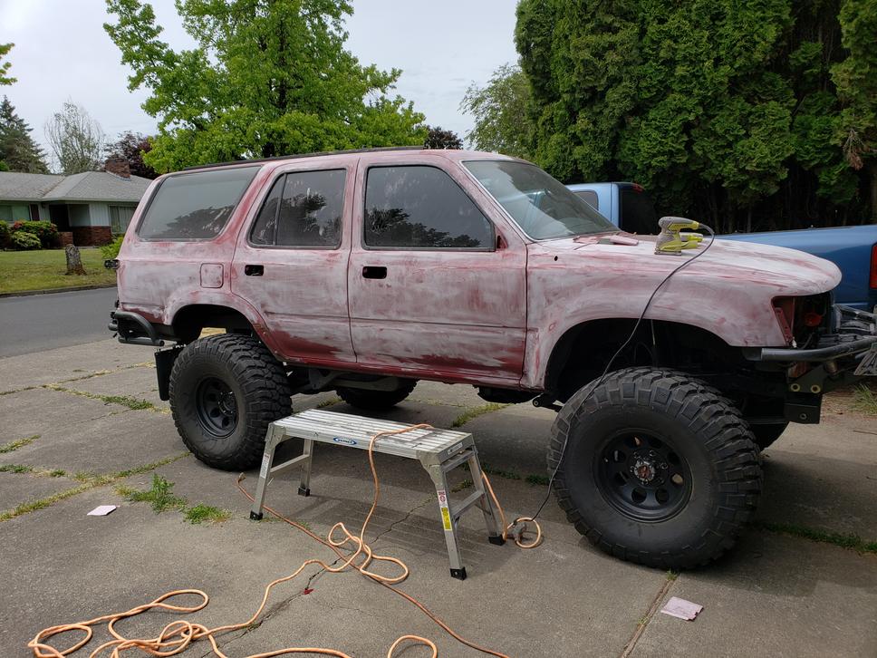

Got the fender flares pulled
Sanded the whole thing down with 150 grit
And got it wiped down with acetone.
Hopefully tomorrow of weather cooperates it will be a slightly different color

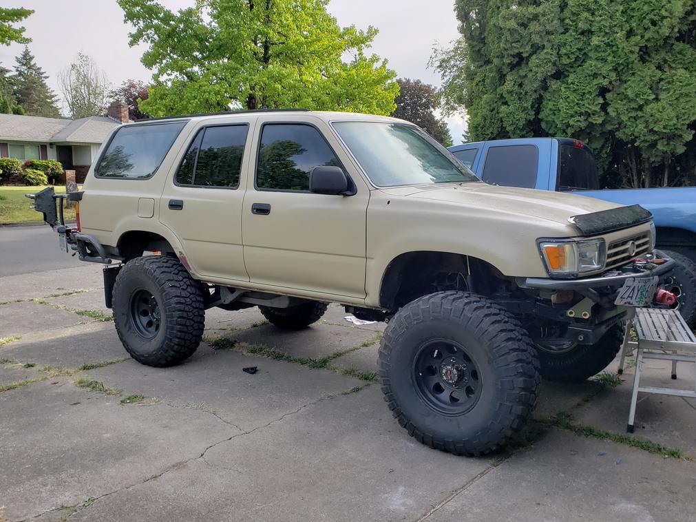

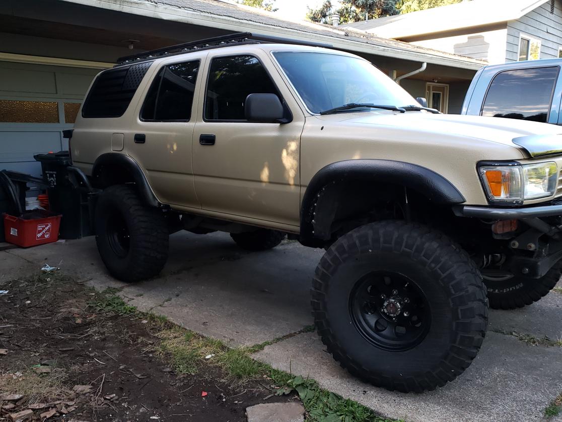

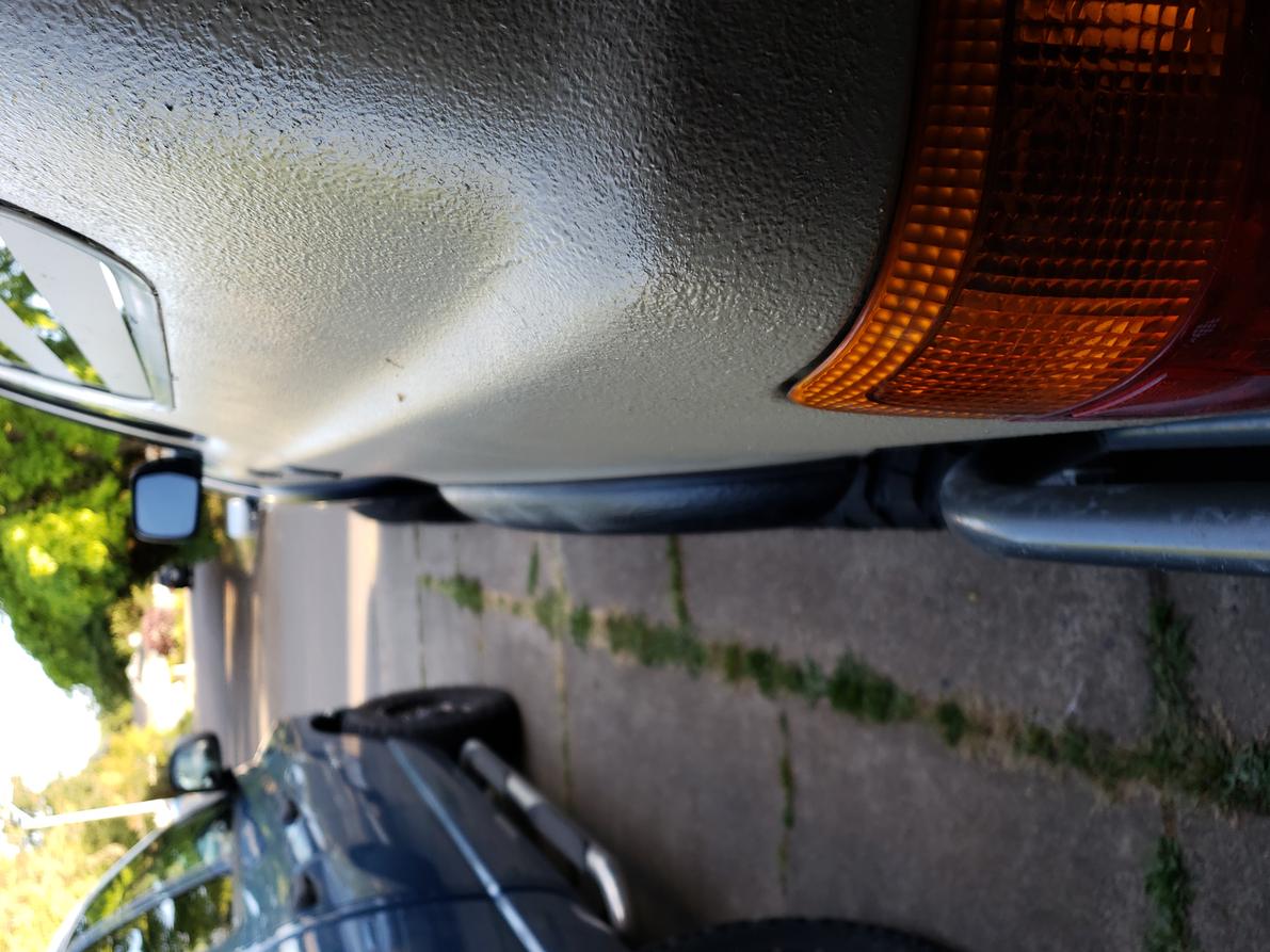

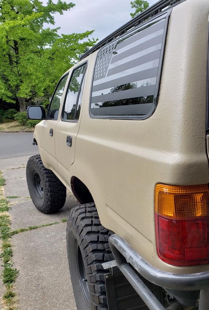

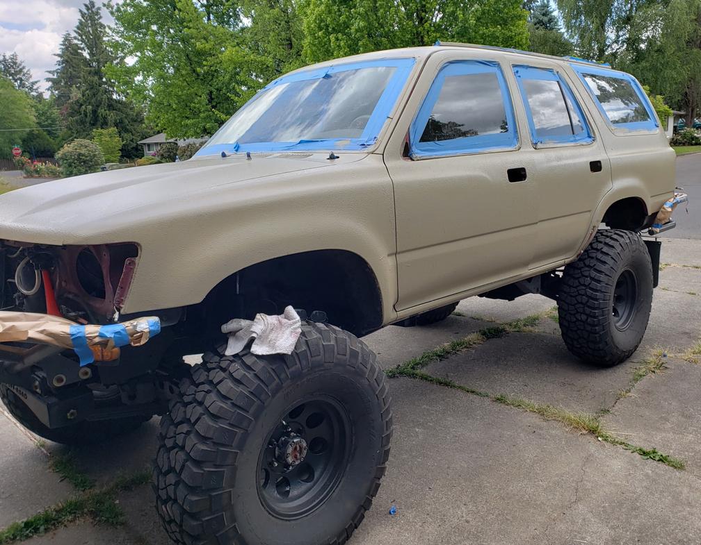

After 3 rollers, some brushes and several pairs of gloves the 1st coat of Monstaliner Desert Sand is on the truck.
Got the 2nd coat on and started putting door handles etc back on. Need to put the fender flares back on and a couple of other lose ends.
It's not perfect but overall happy with the outcome

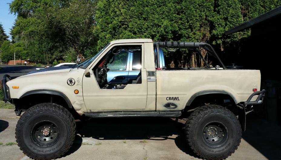

And a comparison of my old 81 Trekker with a rattle can paint job

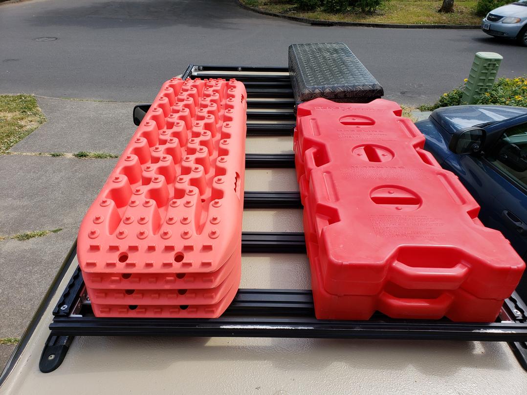

Putting the wipers, spoiler etc back on I got side tracked and decided to play with laying stuff out on the roof rack.* *The only permanent fixture I think will be the small storage box up front.**

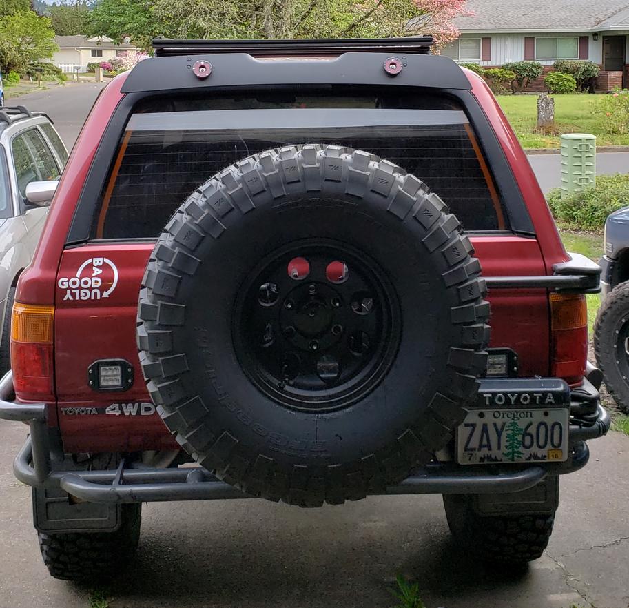

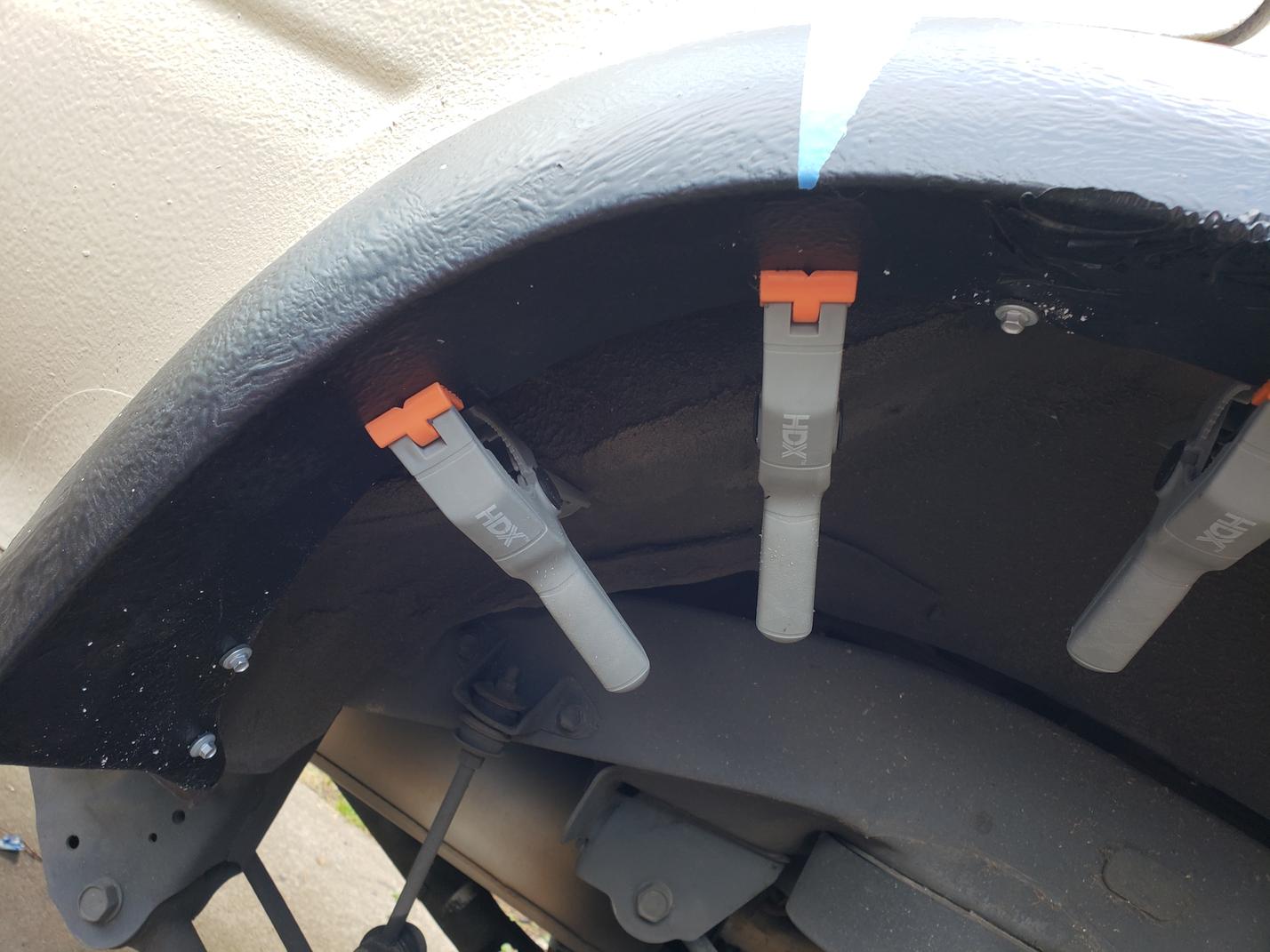

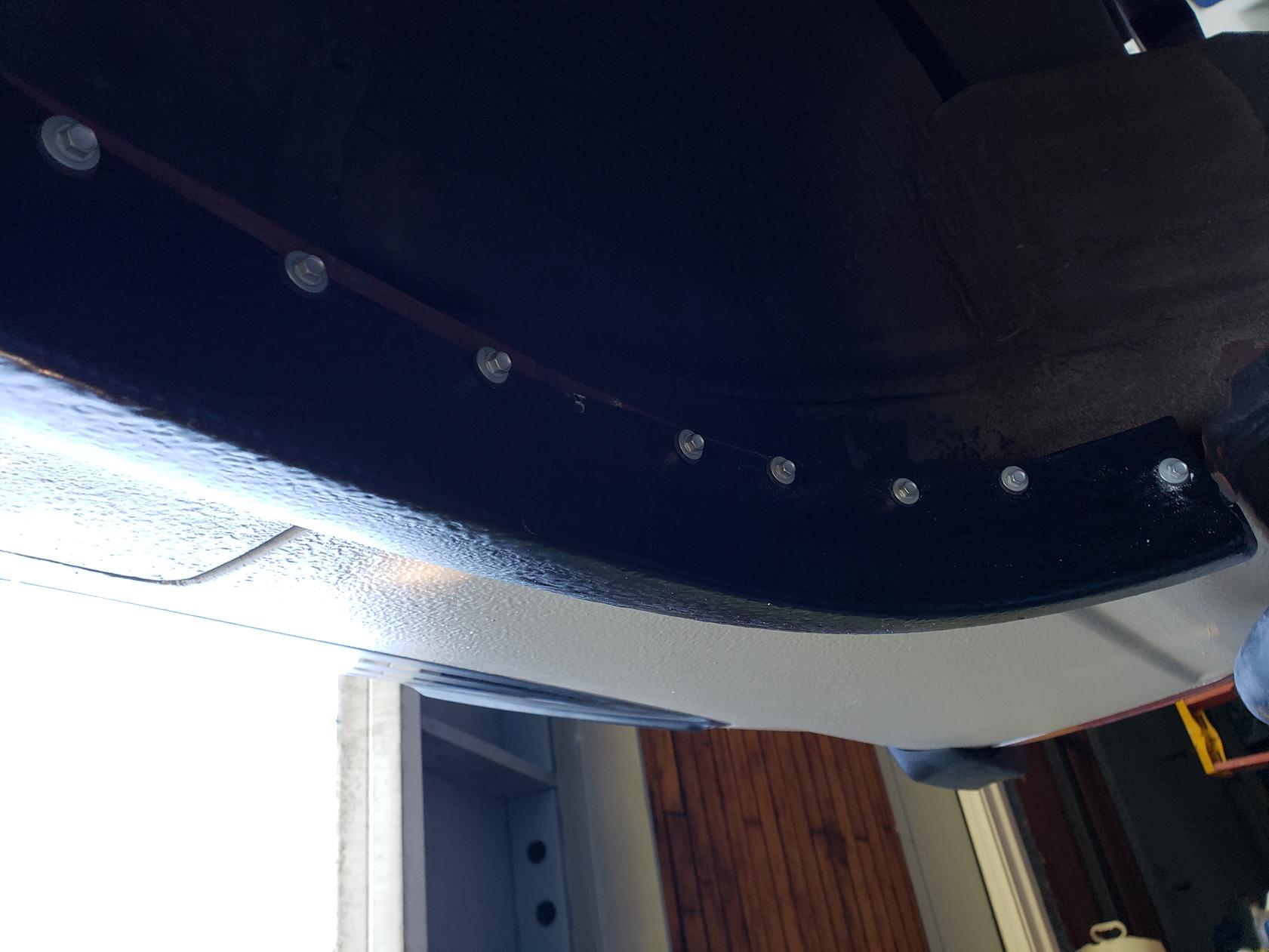

I ordered a set of Jungle Fender Flares about a year ago and finally got them mounted.
Sort of a pain to do because their directions aren't that great. Basically I got them as tight to the fender as I could and prayer when I drilled I hit the inner fender lip.
Only snafu was i broke a couple of studs on a wheel spacer. Can't complain it had been on the 81 for about 8-10 year and a year on the 1994. Took me a while to find the spare.

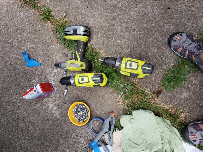

Having a couple of cordless drills helped not having to swap between a drill bit and hex nut bit.
