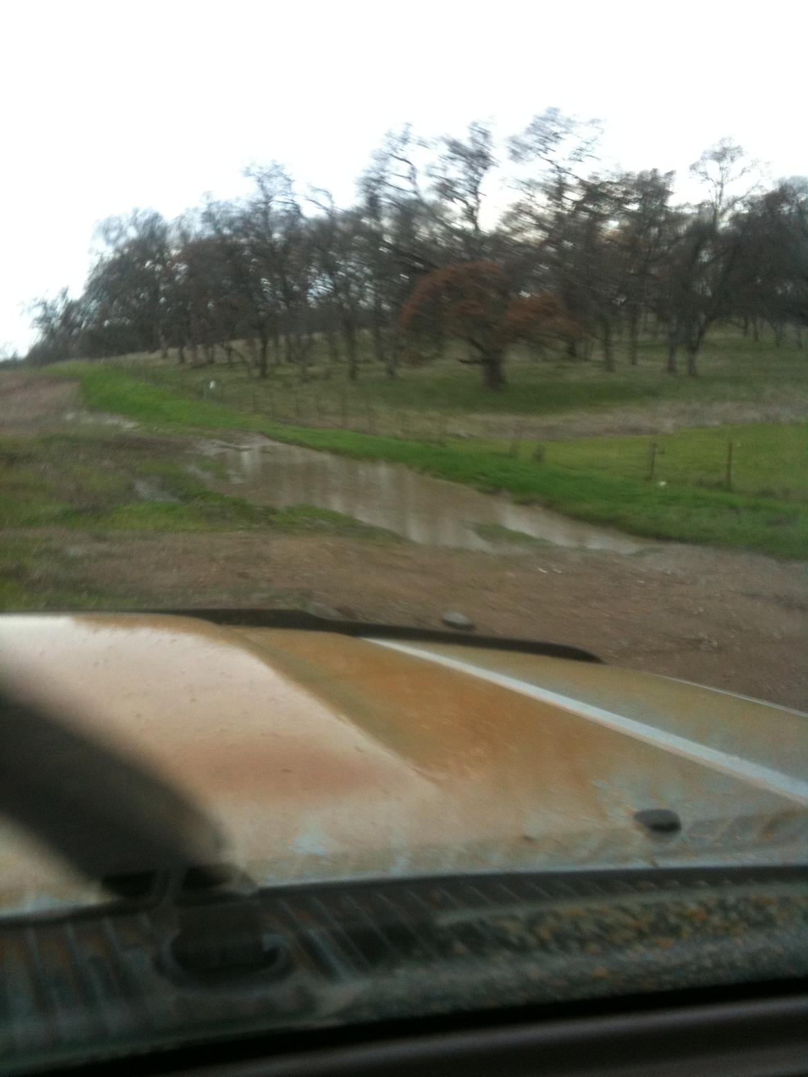

ya me and the guys on this forum went mudding today and i hit a fat mud puddle, my car shut off and i was scared the first thing i thought was now me?!!? luckily i thought quickly and pressed the gas and tried starting it quickkly before too much water got in there heres the puddle doesnt look like much, but it was up to my window and i have a 4 inch lift haha
