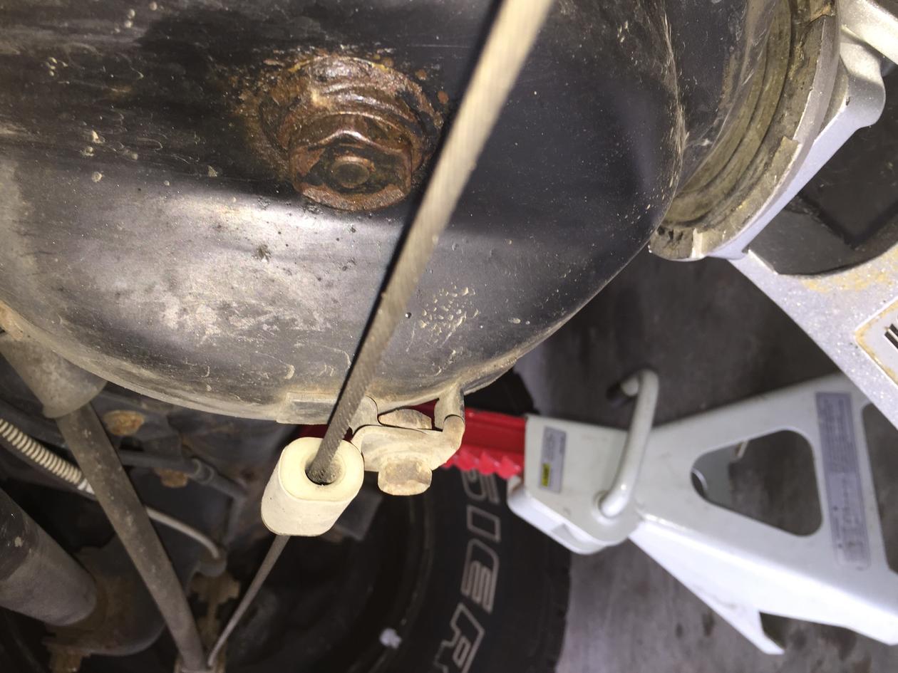

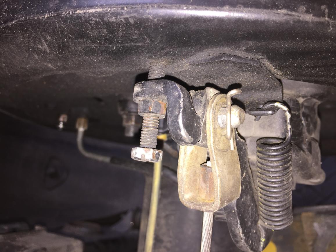

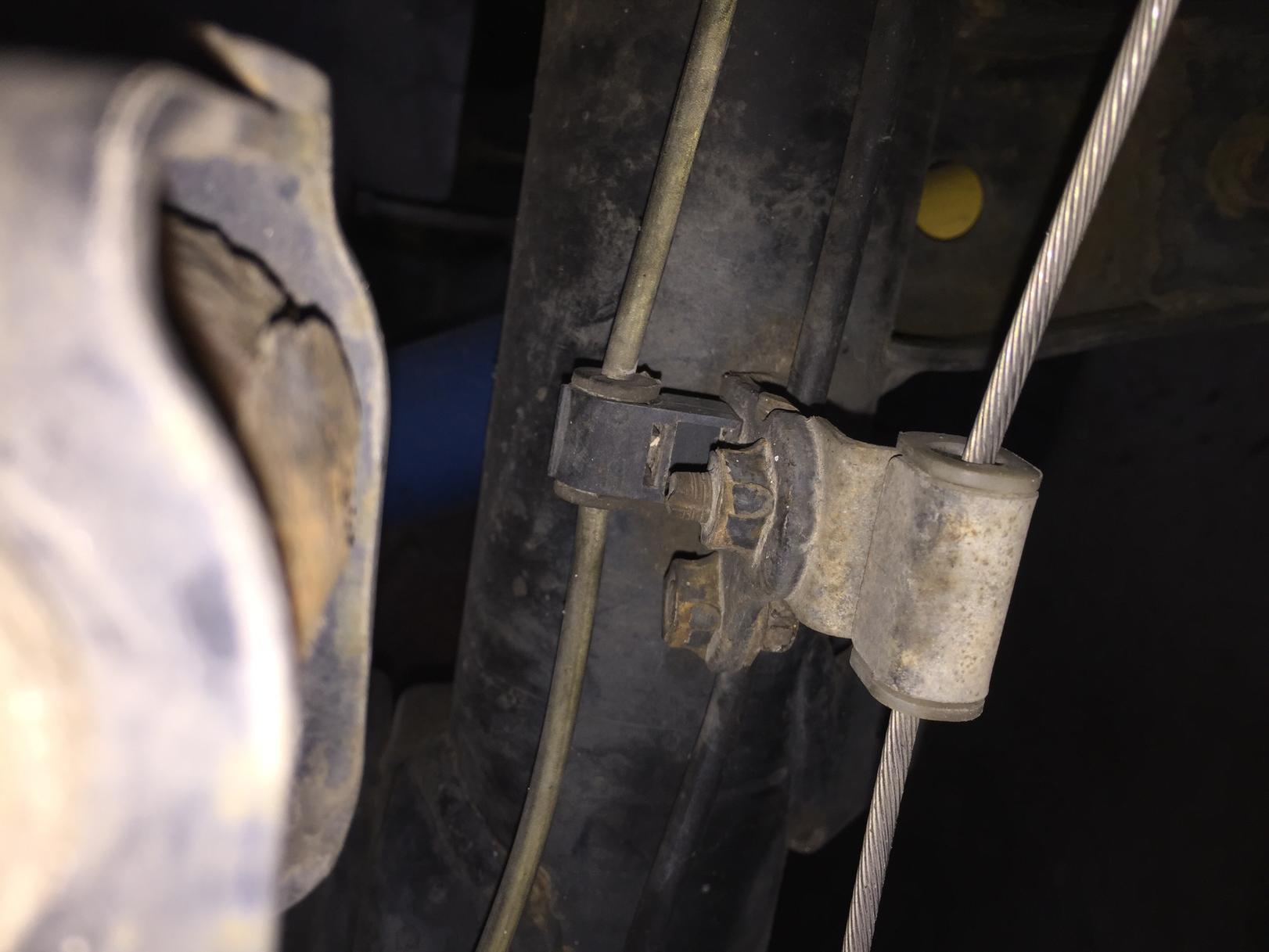

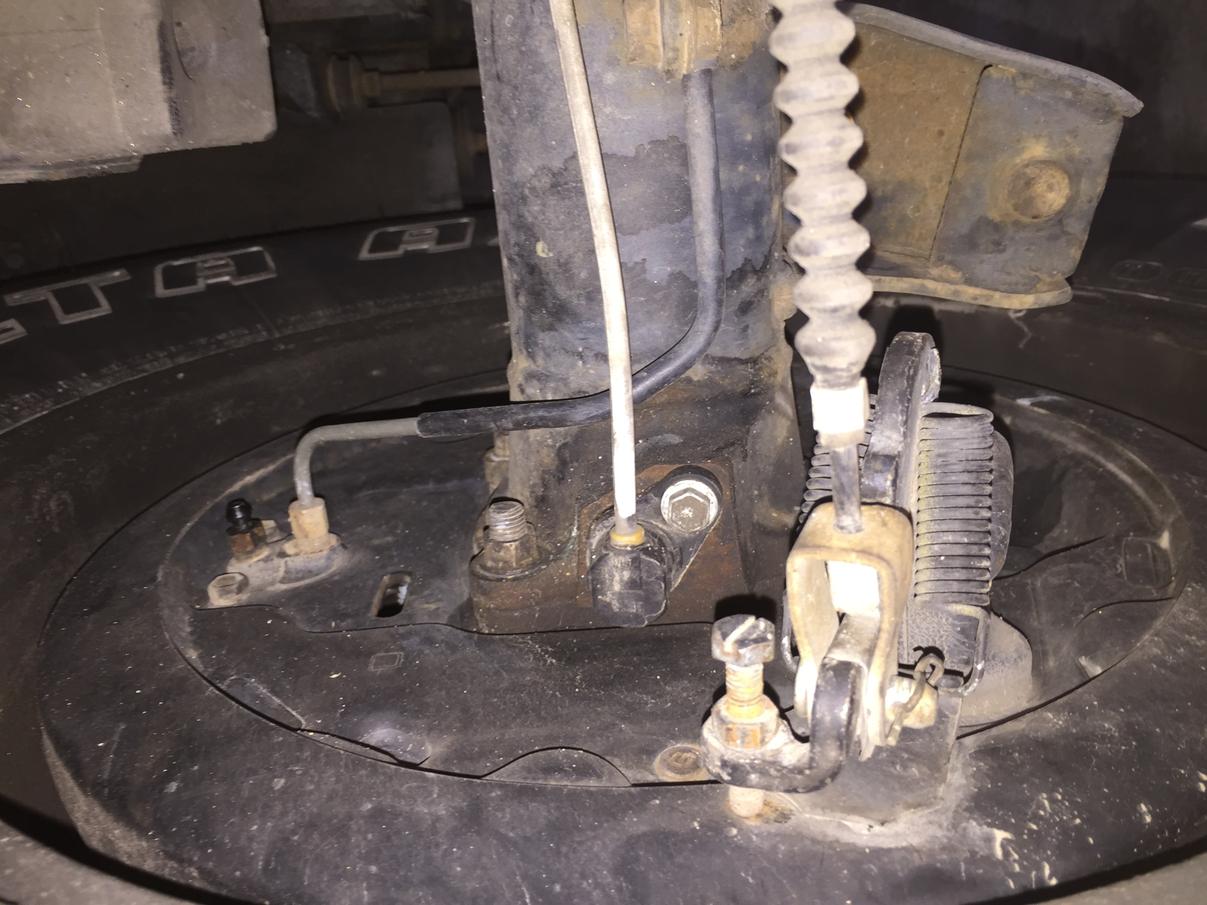

Can you shoot some pics of your bell cranks and the parking brake cable and it's mounting points on the axle housing. I'll compare it to mine.
Having trouble uploading more than one image at a time :/
Passenger side support
Also, I did find a set of shoes at another dealership and picked them up this morning. I'm currently swapping out my radiator and then I'm going to fix a valve cover leak. After that I'm going to throw on the oem shoes. I had to take a break from the brakes. I can't tell you how much I appreciate all the help on this. This forum is tremendous resource.
