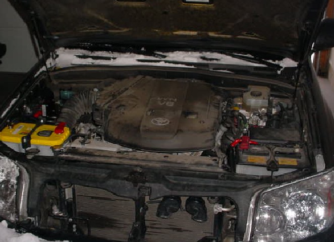

This first one is a "big pic" of the engine bay showing where I installed the Optima D31T.

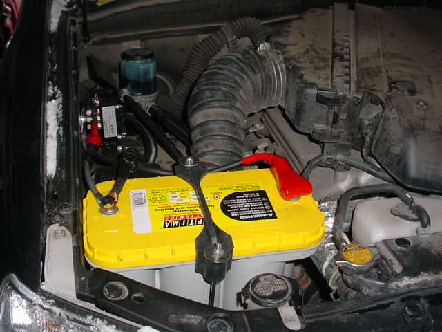

Next pic is a closer view. I mounted the battery "backwards" so that the positive post was inboard away from sheet metal. The only clearance issue I have is the negative post just fits against the hood liner because of the height of the battery and the tray I used. Ran 2 negative cables: one to the chassis (#4 gauge); another to the rear passenger corner of the engine block (#1 gauge.) Also using a 175A fuse at the positive battery terminal (covered in pic.)

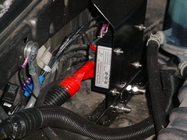

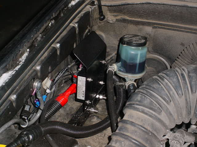

This pic shows the relocated P/Steering reservoir and the Hellroaring BIC95300A isolator (located on a custom fab plate mounted to an angle bar.) Utilized bolts and holes already existing on fender.

Closer view. Chassis ground wire and BIC ground goes to an existing threaded hole.

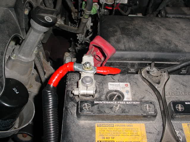

Last pic is of the original battery where I hooked up the new #1 gauge wire running to the BIC isolator (ran this wire around the front of the rad under the plastic trim.) Had to replace the bolt in the positive terminal clamp with a longer one in order to be able to fit the extra cable terminal.
