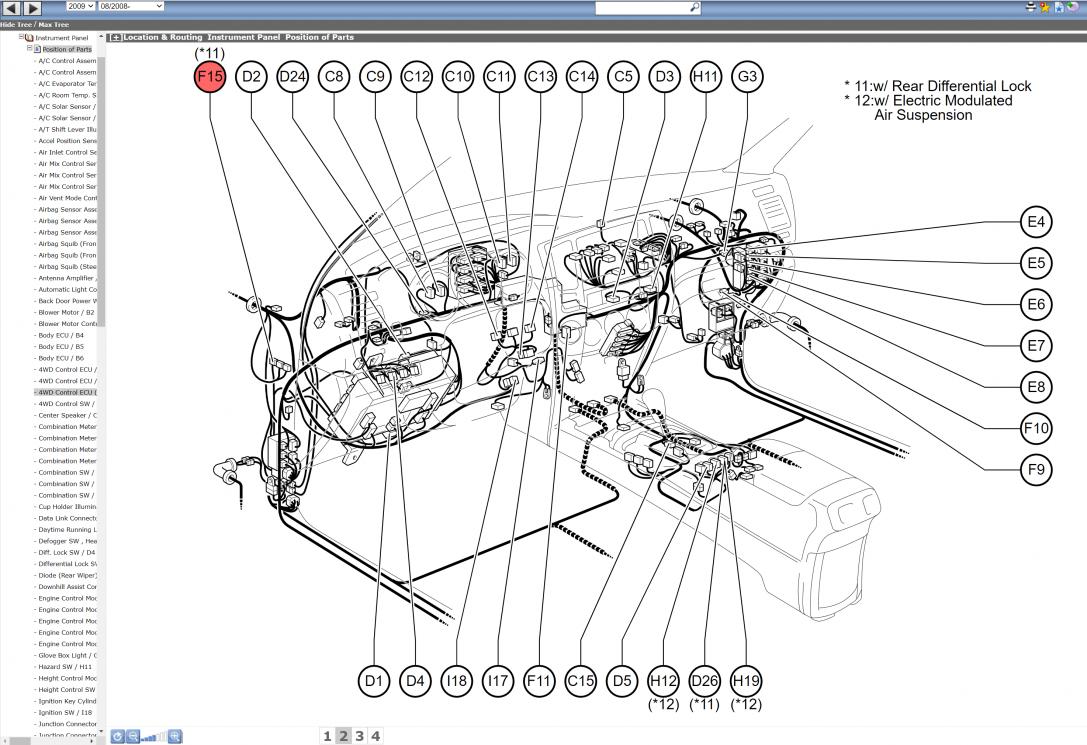

-The wiring for the circuit may not even exist on the V8 4Runner (see the attached parts location, connector F15)

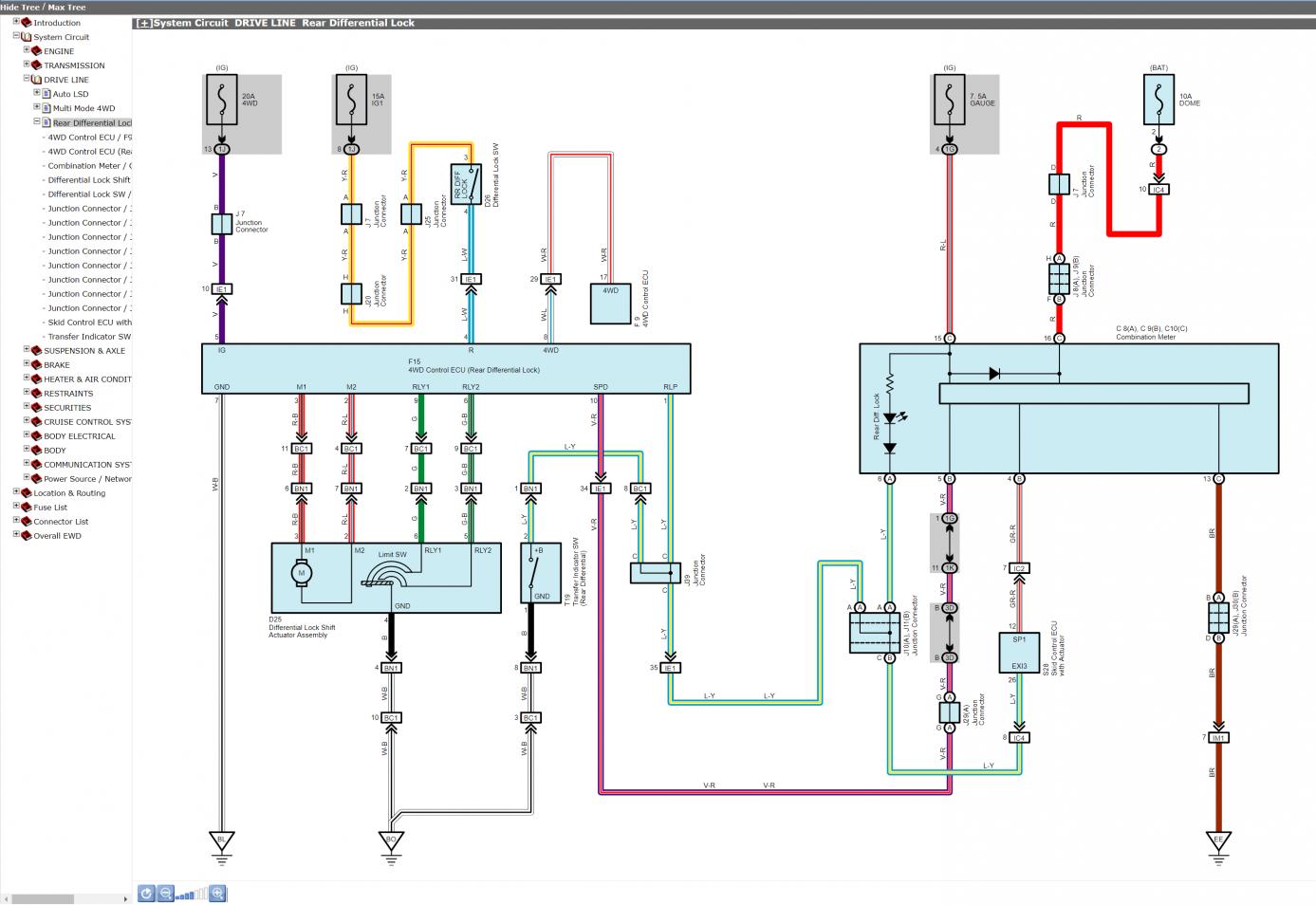

-You may need an entire "4WD Control ECU (Rear Differential) Lock" module (see attached EWD Schematic for Rear Diff Lock Circuit)
-IF you did manage to get all the required parts, switches, and connectors, you'd still probably have to run your own wiring for certain aspects such as the Speed Signal, Communication with the ABS/VSC/TRAC module, Communication with the 4WD ECU, etc. (See attached EWD Schematic) Additionally there's no guarantee that these modules will have the programming (these are modules Toyota doesn't have a process for reprogramming that I am aware of) to properly communicate with the new module you install.
