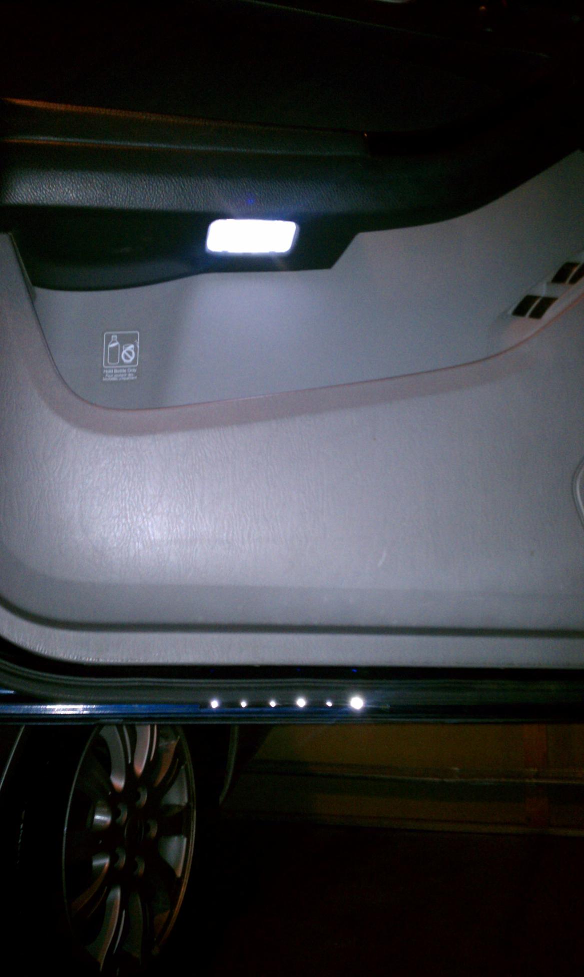

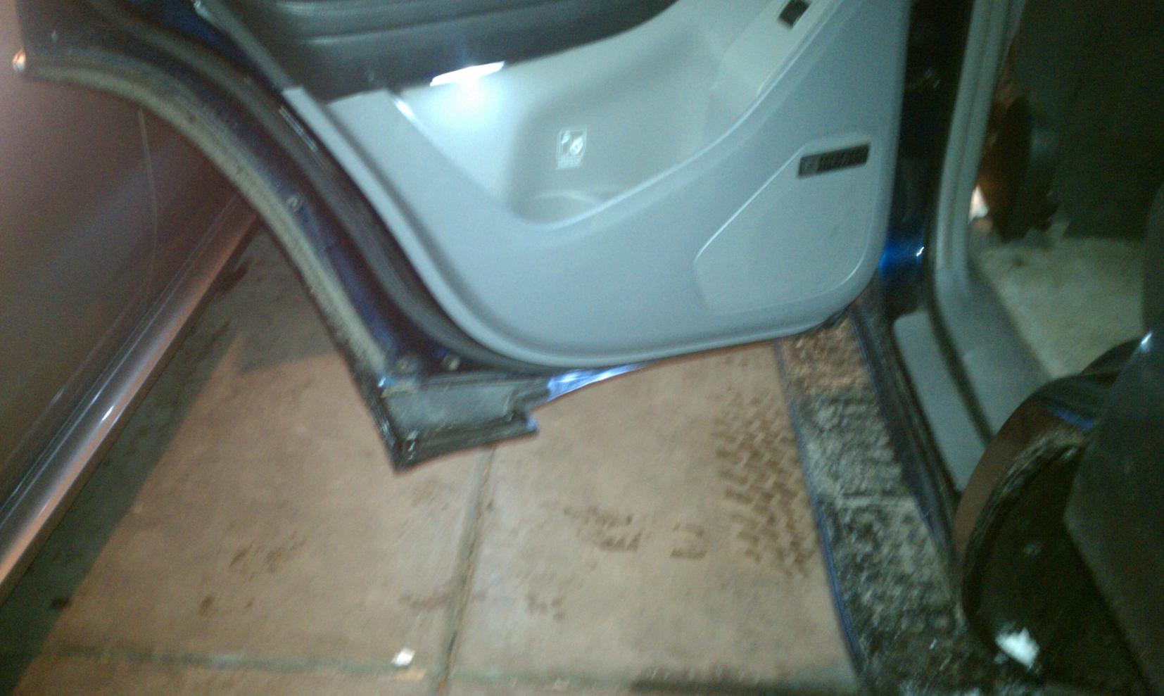

I thought i would share this mod.

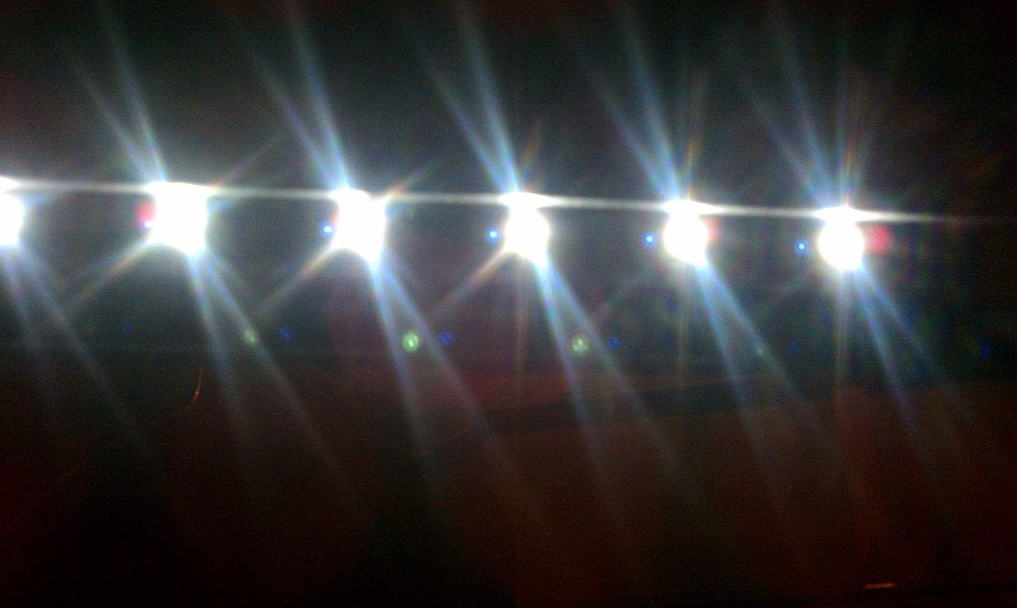

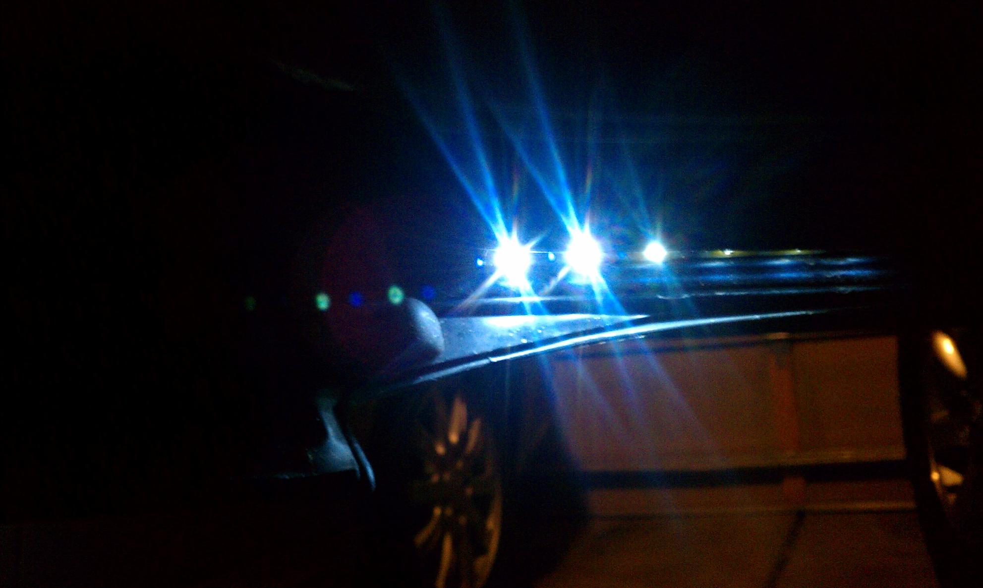

I wanted to have more light on the ground when the doors were open, I did a led upgrade in the doors but I found some led strips 5K WHITE 3 CHIP STRIP LIGHT STRIPLIGHTS
they said they were bright for there size and they are

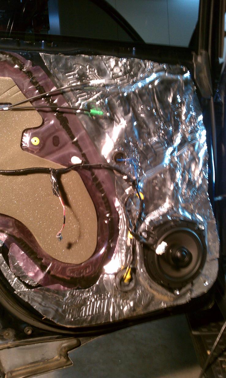

I removed the door panel to replace my speakers so while I was doing that I stuck the led strips between the door seals and ran the wire through the door drain and up to the door light wire, spliced it, and I had light! I made sure the wires were secure and put it back together
