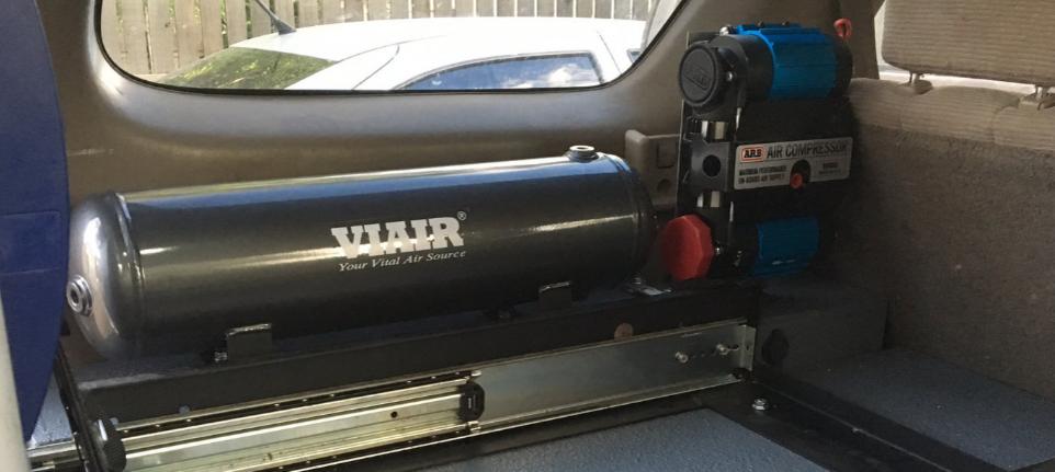

Quick question for you ... that VIAIR tank looks like the same one I've been eyeballing on Amazon. I was thinking about installing it outside the truck in the factory spare tire well. I've got a 1" BL and there looks to be enough room it to sit outside the truck. Any reason why you didn't go that route?

I put the tank/compressor in the truck because I figured it would fill the awkward space I had left on the platform nicely when I measured. It would work just fine outside in that location too though! I'm loving the tank/compressor setup. I've got some ideas for that location on mine which may or may not ever happen but ya. If you'd rather it be outside go for it.
