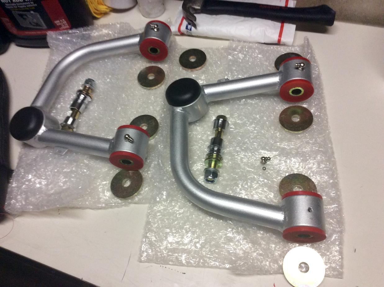

I just recieved mine in the mail got them in two days which is cool. One of the zerk fittings broke as I was snugging them up and checking out them arms... So I will purchase all new ones after that easy snap. Over all seem beefy and good to go after a few modifications and paint job.
Cool! Looks like they come with uniball covers now!
