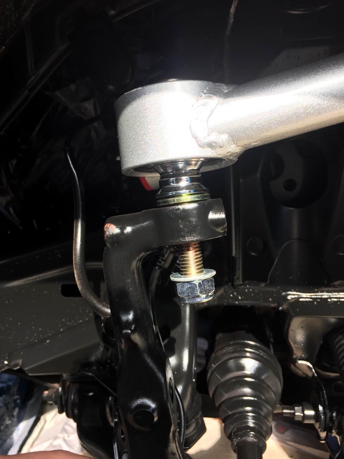

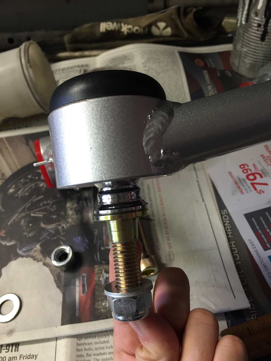

Got a pair myself, notes about them:
  • No grease packed into the monoball
  • Bushings were too long, had to grind them down
  • Powdercoat/Paint extremely brittle, easy to chip
  • Came with nice hardware
  • Perfect Fitment

Can someone do me a favour and measure the sleeve included with the arms? Need OD, ID and length. I swear someone posted that in the thread somewhere, but I can't find it.
With these measurements, I may have another solution for us.
I know that Energy suspension control arm bushing kit comes with two sets of different size inner sleeves and I thinking the ones I didn't use when I rebuilt my OEM UCA are probably the correct size but I won't know til I get my arms to try it out ..
I went through all of ES's universal sizes and couldn't find any that matched the sizes these UCA's need.
