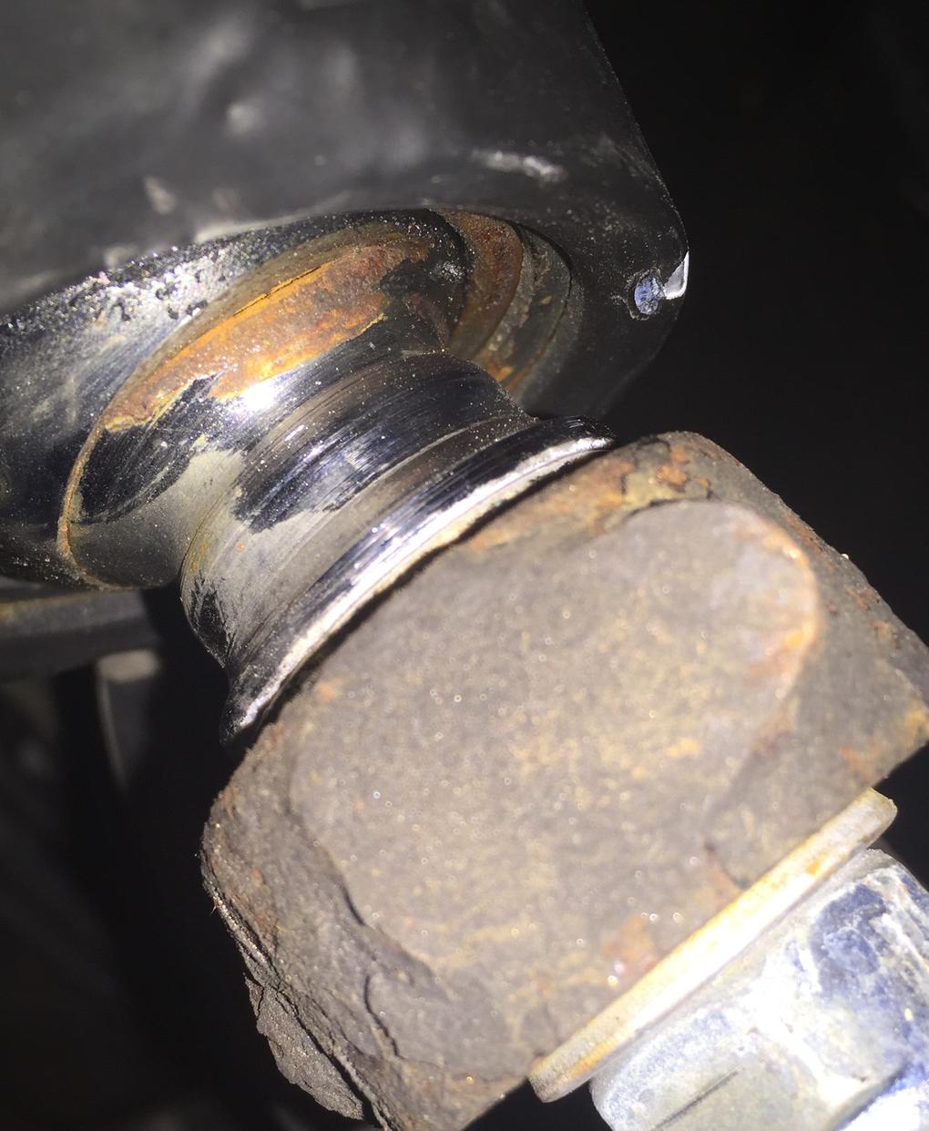

You're going to want to have a picture handy for this to make the most sense.
The bushings are fine, but the inner metal sleeve inside of the bushing is too short. The bushing and sleeve should be the exact same length.
Try to find a picture of the metal washer/plate (?) that sits against the whole outer bushing surface. That plate is should touch the metal sleeve and the bushing.
Instead, since the inner metal sleeve is recessed, the plate only presses on the bushing, which you don't want.

Here's the replacement sleeves I was sent from eBay seller Freedom.Suspension or maybe it was Suspension Marketplace. They're all the same... Anyways!
Washers for comparison, original sleeve on left, replacement on the right.
