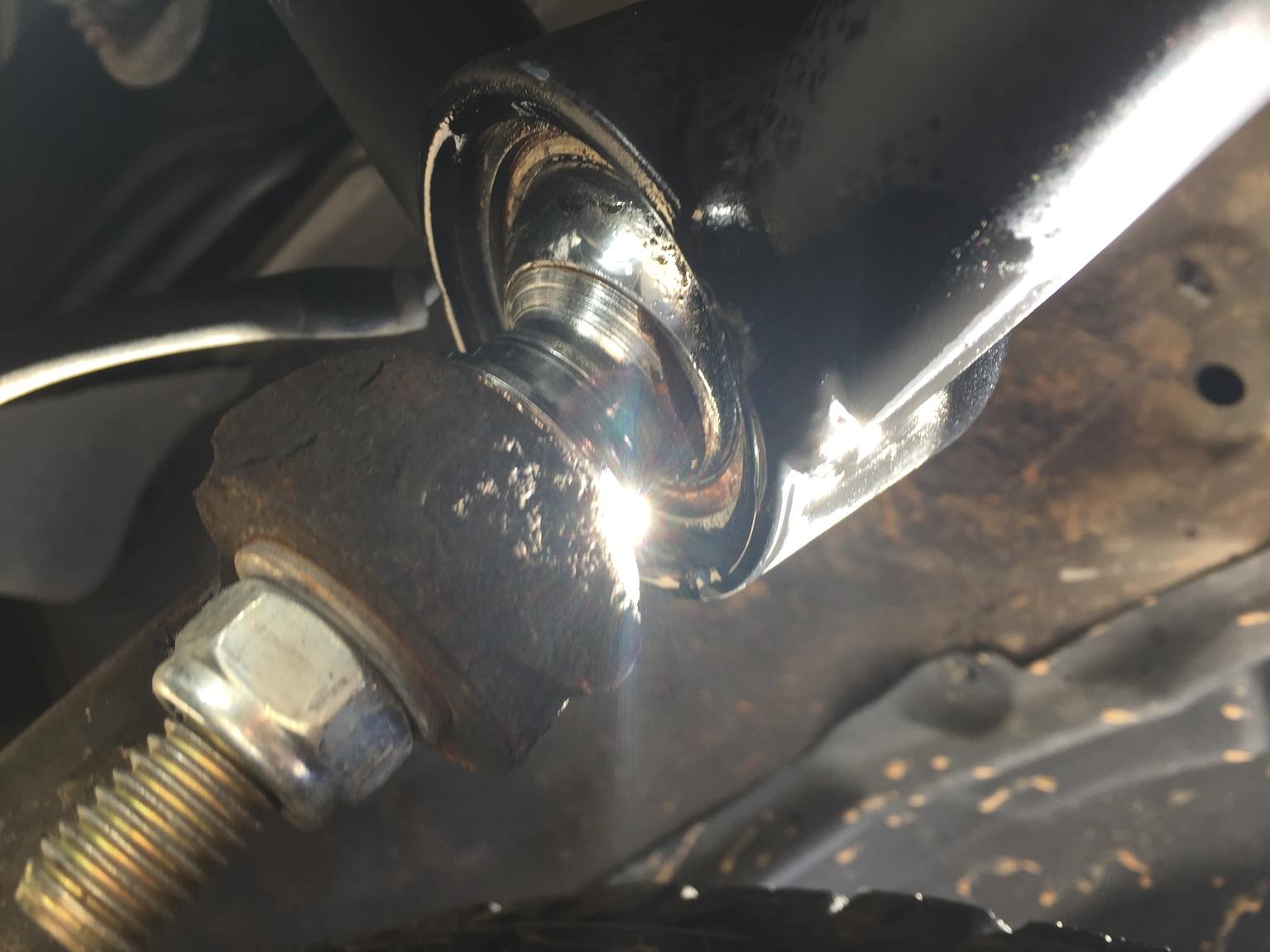

that was what my thinking was. if its not i might be screwed since thats what stops my down travel
That's the misalignment's job is to act as a buffer between the bolt and the arm. Some heim joints use them too.
I'm fairly positive that isn't designed for a bumpstop. That's why you limit your droop with limit straps and your up travel with bumpstops. That bashing on that ledge will tear things up quick.

What I think is that that piece was not machined properly and when torqued down it put more pressure on that corner and broke the piece.
Definitely not a bump stop! But a machined surface for friction, I suppose.
Looks kinda like the bolt wasnt torqued down all the way, or came loose after some use, which allowed the misallignment spacer to come away from the uniball, and as it articulated, the misallignment got caught on the edge and snapped off. I dont see how else it couldve happened.

After about 17,000 miles here is a look at the uni-ball...

Looking at the part closer I agree during full droop it is hitting and breaking stuff. Saw other marks on the damaged part.
I need to invest in limiting straps.
Could it be from the extended travel coilover and the wrong arm?

Your misalignment is stopping your travel, which is not good if you're jumping. Or whatever you're doing to fully droop your suspension at a high velocity.
I would say invest in some limiting straps. Thats my next project.
