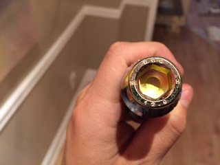

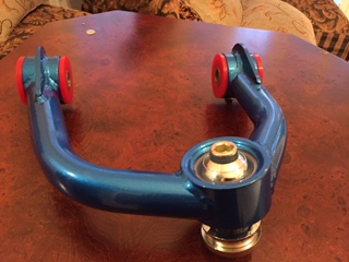

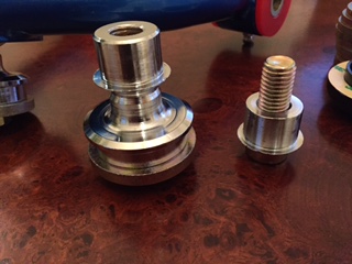

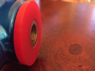

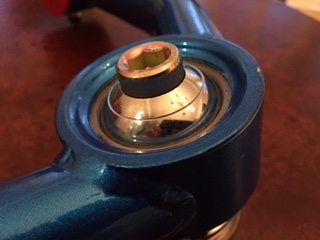

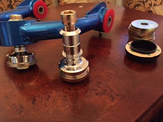

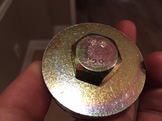

IMG_3196.JPGIMG_3199.JPGIMG_3201.JPGIMG_3202.JPGIMG_3207.JPGIMG_3209.JPGIMG_3200.JPG UPDATE: This appears to be the new uniball system they are using. Never seen this style before. going to install this weekend to try it out. Anyone's opinions? :help:
WTF? So the Allen head bolt and the hex head bolt thread into the misalignment spacer?

Yes I have a 3rd gen, but they have done away with the older style for the mos part, my understanding is that this is the new style for the arms from here on out.
After reviewing your video, I believe this style wouldn't work with 4th gen spindles.
