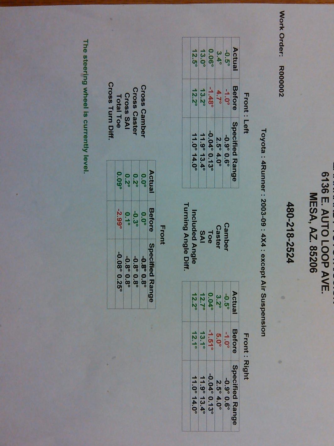

Ok she's aligned. These are the numbers.

I am curious to know if the alignment is improved by installing these and if so by how much?
The only thing I really noticed after I lifted mine was sensitive steering. That was after I had it aligned with stock uca's + 2.5 /1.5 spacer lift. These ebay uca's improve your straight line driving like on the freeway thats about it. Granted you have it alighned after you install them.
