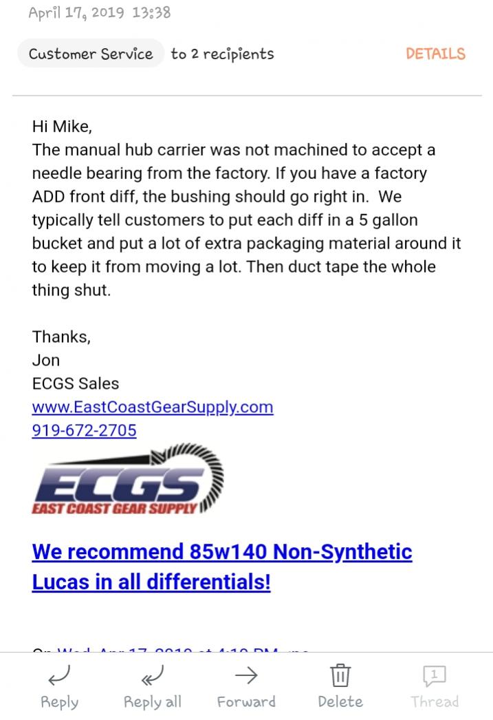

Pardon me if this doesn't belong here. I'm going through my 2000 and definitely have lots of slop on both sides. Would you use this bushing on the passenger side as well on a 2 - 2 1/2" lift? or go back with needle bearings on that side?, Thanks, Tim
[MENTION=546203]earlenecr1979[/MENTION] straight from ecgs. I asked the same question. The carrier is the diff itself. I have a ADD front diff and did a manual hub swap. Since all I changed were the hub side the carrier stayed the same. Install was less then 10 mins (once everything was removed).
