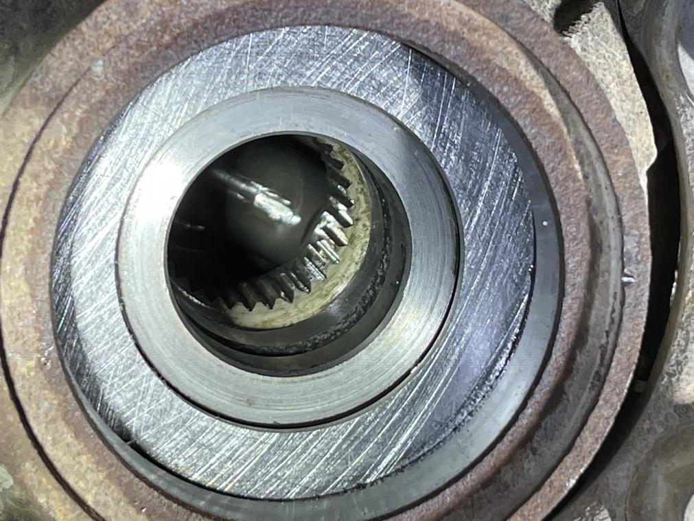

I bought the ECGS bushing for my 2011 4Runner Limited. I pulled everything apart but there is no needle bearing. Instead there is a double row bushing with quite a larger OD than the ECGS bushing, ECGS bushing has an OD of 1.594” and ID of 1.378”. I can’t get a perfect measurement on the bushing in the housing but it is approx 1.970” OD and 1.400” ID. The CV axle fits good inside that bushing in the housing.
I can’t find any information anywhere on that bushing/housing combination. No idea what’s going on.

Even though this is the 3rd gen section, is your 4runner an AWD model? If it is, it doesn't work on your 4runner. States it under the description.
Ahhh, I think you are right. I have been confused as to trying to understand whether my drivetrain is part-time 4wd or AWD. Thanks for the tip, I didn’t even notice that in the description. Seems very hard to find info on the AWD model as even on Toyotas parts website I could only find the needle bearing.
