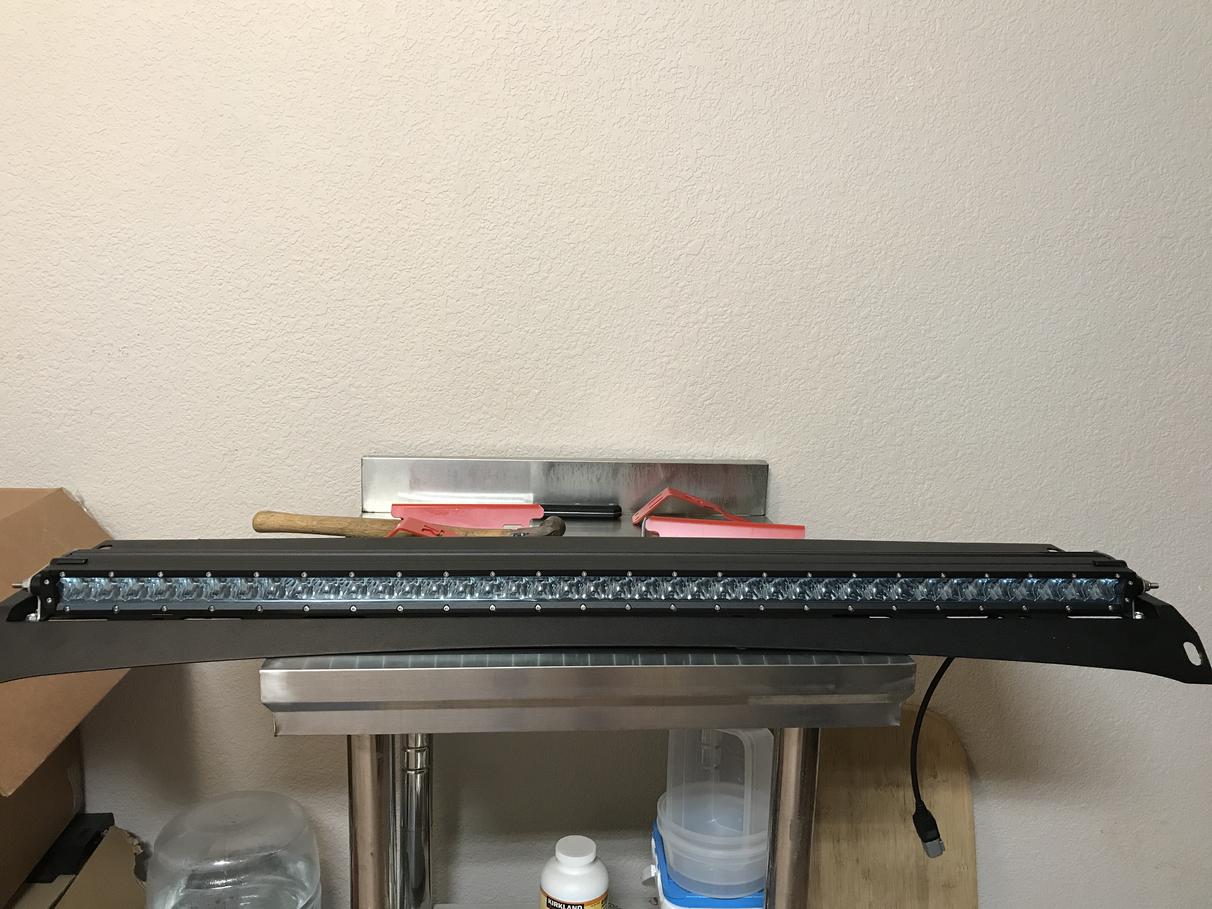

Just an FYI, the Aurora single row 40” light bar fit perfect on the Ecotechne rack. Almost like it was made for it.

Nice! I'm still working on "tuning" my rack in.
It looks like there were a lot of improvements with V2 besides the fairing/lightbar mount up front. The side rails and cross bars now have slotted holes for adjustable mounting options, which is nice. However, I wanted to make sure I wouldn't need to drill into the rack in the future, so I added holes of my own to the crossbars. The top faces have holes for 1/4" hardware, arranged in 3.5 inch squares. The bottom (where the slots are) have holes for 3/8" hardware every 3 inches. This way if I ever need to make any custom mounts, I already have something to attach it to.
Also I've been working on smoothing all of the rough edges and grinding down excess weld spatter, etc. Trying to make the pieces as nice as possible before sending them out for blasting and PC.

Smart, looking good. I’m still debating having mine blasted and re powder coated.

I also just got the same light bar as you from the group buy. Hoping to get it installed tomorrow.
