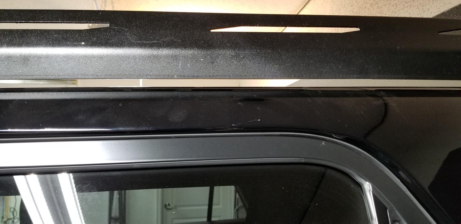

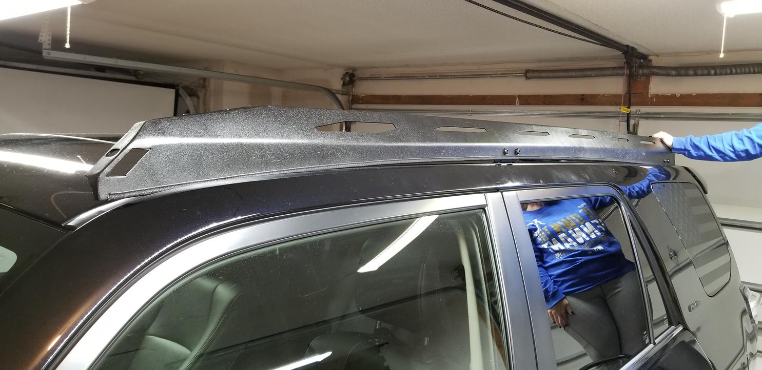

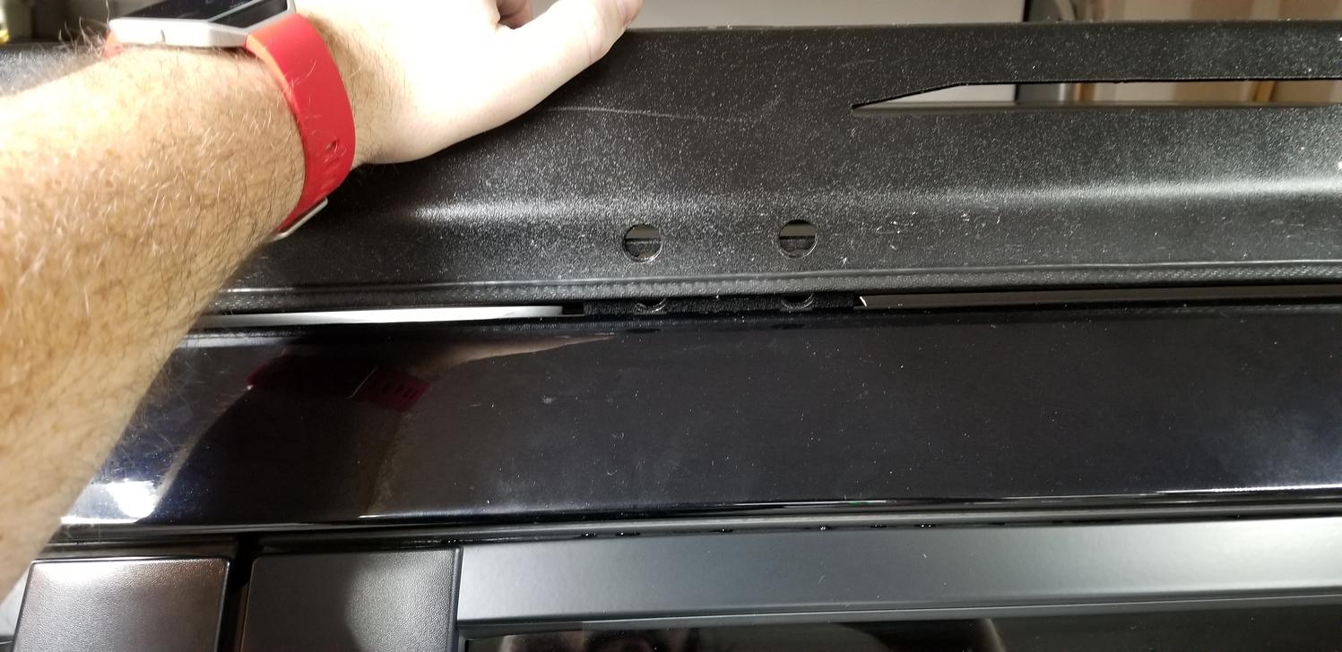

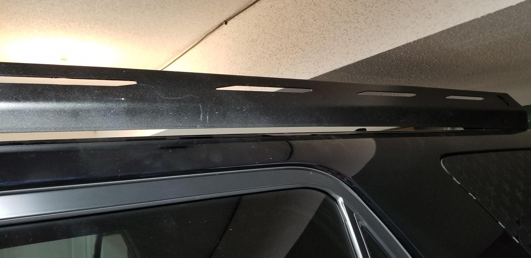

It leaves about a 1/2" gap between the siderail and the top of the vehicle.
The drivers side when compared to the passenger side is visibly cut and drilled in different places which keep them from lining up correctly. In order to get it to attach to the roof, the mounts have to be raised and unbolted about a 1/2" from the roof... which... well would you put it on your roof to use it?
Are your mounts different sizes? In the instructions it mentions smaller mounts in the front and larger in the rear. But, it seems that they are all the same size now. Your mounts look very different from mine.
I agree that adding 1/2" spacers in order to make the holes line up would not be ideal.
Does the passenger side fit the roof contour with mounts lining up properly?
