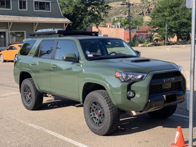

Very Nice!! waiting for it to cool down a bit (104* today) before I install the same springs and UCA's my top hat spacer is .400 about .750-.800 additional.
Did you happen to get before and after hub to fender heights.?? Very curious, especially with the adjustable rears, which I already have installed...
AMLOR
Thank you! I only measured ground to fender.
Stock fronts = approx. 35.25"
Stock Rears = approx. 36.5"
Lifted front and rears = approx. 39.25"
But I am going to raise the rears by another 0.5" for a little rake.

Do you know what caster you have on your alignment? What setting did they use on the SPC—2?
Also, are your spidertraxx on in these pics?
Nice! The extra height from the top hat spacers makes a big difference I think.
I'm not sure on the caster sorry, alignment was done by [MENTION=116770]Stellar[/MENTION]built in Sacramento CA.
Yes the 1.25" spidertrax are installed in those pics.

285/70/17 + JBA UCA, no wheels spacers needed , TRD Pro wheels 0 offset about 3/4” space in between tire and UCA. Just saying

0 issues, and you can get Caster up to 5+ easy with 2.5”+ lift. Good luck!
Horizon: I’m doing an extra 0.5” over the 1.6” in the front using toytec strut shim. Also doing around 1.75” rear with Dobs c59-505. If you don’t want to cut a ton and you plan to take it offroad, I wouldn’t get the 285/75. You’d need new wheels or spacers to clear the JBAs with that tire size.

Yeah I’m just waiting for my install next week. Holding off on the UCA’s since guys are getting plus 3 on the caster. I’m not even mounting my SCS wheels yet till I see what measurements are after done. I want to check to see with tires turned with stock size tires before and after lift. I also might have the tire owner I know just to mount a 285 on my 8.5 inch wheel to take home to see what’s needs to be done as far as the wheels turned.
I added 2x 1/4” coilover shims to each side which increased the lift by another 1”.
Im considering the lowering kit since ill have around 3" of lift from stock. I have JBA UCA's and the same eibach spring set up as you on order.

Looks good. Waiting to have my AG done also. How was the alignment afterwards. Or did you change your upper control arms? Thanks.
Sorry for the late response. Alignment took 3 tries to get right, I believe it was just poor alignment shops, wasn't until the last one that they finally got a good caster and zeroed out the rest. Caster was ~3deg and drives great.
I did not change any other components, just swapped the springs and upgraded tires to the 275 Falken Wildpeaks.
Willing to share more photos? Im considering the 275 wildpeaks over 285. Looks great in that pic.
Here's another angle for reference. 275 wildpeaks
