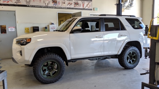

Lift installed yesterday on Limited. 285/70/17 Falken Wildpeak for reference. Was expecting it to be higher to be honest but has good manners on the road.

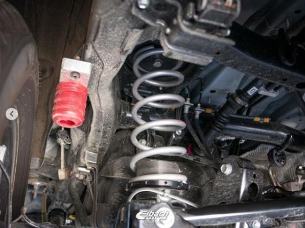

Eibach posted this pic on their instagram. Adjustable rear prototype. Really hope we can buy the parts to upgrade our existing kits to make them adjustable.
I don't see why not. it's just an adjustable spring perch like found on a coilover. Pretty simple setup, i like it.
