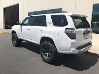

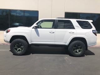

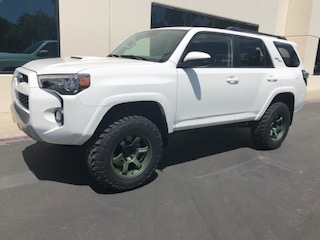

We're still messing around with the rear setup so this was about 2". The front is 3". Looks great and still rides very well.
Yes, for about a week. Then I'll be on Dirt King upper and lower arms.
Thanks Ryan! I'm looking to do a similar lift with the fronts on the second perch and a 2 inch lift in the rear with the Toytec RCC2.0. Also looking to get the Dirt King UCAs.
It looks like you have some reverse rake though? Has it settled?
Yah it's dialed in. We had bags of sand in the rear to simulate added weight.
