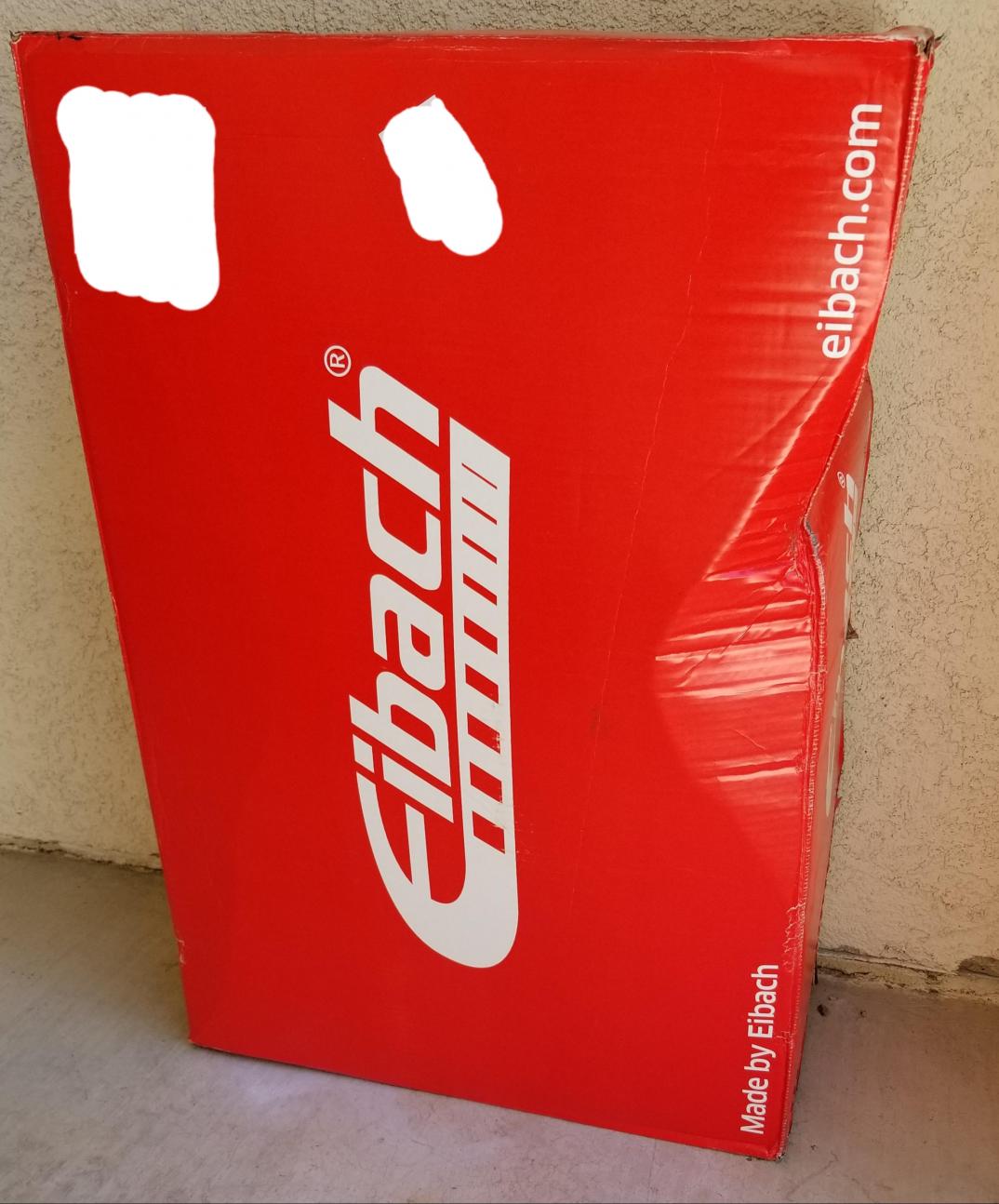

Oof! Looks like someone at FedEx skipped arm day at the gym. :D
Thanks to the amazing packaging no parts were damaged!
