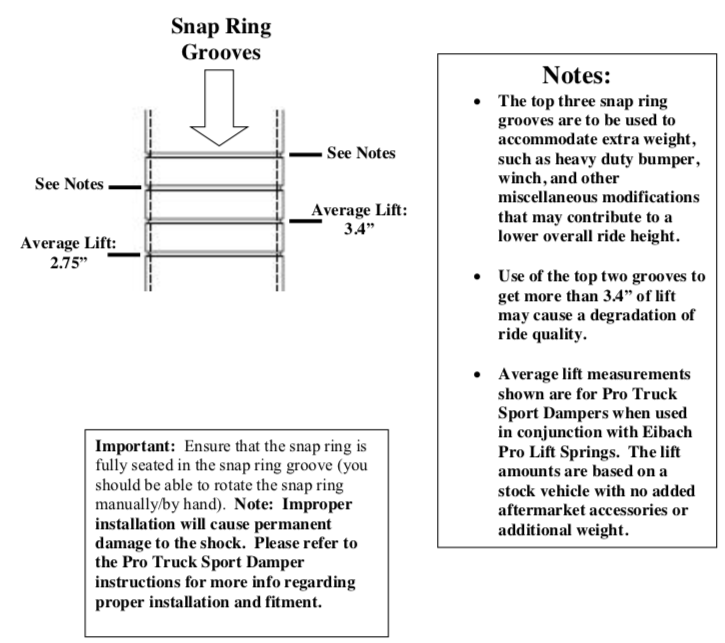

I am so close to buying these! What is the max hight these will go while leveling the Runner? I want to lift and level her out and planning on getting 265 or 275 KO2's.
EDIT: Never mind, I think I was confused about the adjustable notches. From my understanding, the springs are what actually adjust the hight, the notch is to adjust the front springs when there is added weight, such as, a front bumper with a winch. So in theory, this kit will lift the truck 2.75" while leveling it out. Please correct me if I'm wrong. I am still learning.

Does anyone have pics of the kit set for the highest setting for lift I guess 2.5? I am trying to go through the whole thread but damn it's a lot of pages. Also, Where is the best place to get it with the best price. I knew I should have ordered in April when it was under 500 bucks.
Here is a screenshot a page from the manual. It looks like the lowest setting ("average lift") is 2.75in.
Thats correct. The higher notches are to maintain the same lift with added weight. It leveled mine out nicely with no lean. I was able to clear 285 k02’s with minimal bumper trimming and the fender liner mod. No body mount chop was needed.
Thank you for reassuring me! I am going to keep 265, simply because I don't want to deal with bumper trimming or fender modding. Plus, my baby is primarily a daily driver with 5-10% camping/off roading.
