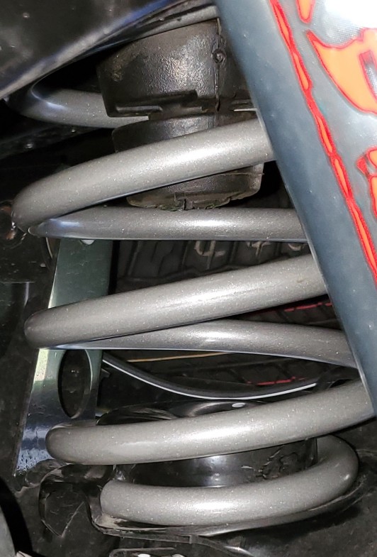

Do the Eibach rears settle in time? I ended up with 1.75 in the rear. Drove it about 30 miles with no change
You shouldn't get that much lift. Are they seated correct?
Yes the bottle of the coils are in the perch. The only thing I noticed is the driver's side bottle is slightly bent where it sits at the perch. Not sure if that matters as the passenger is flush and both springs got the same rise.
Did Summit send me the right springs?
Box says Pro-lift-kit springs
E30-82-071-01-02

PN is correct. Keep me in the loop on this. Might just fix itself.

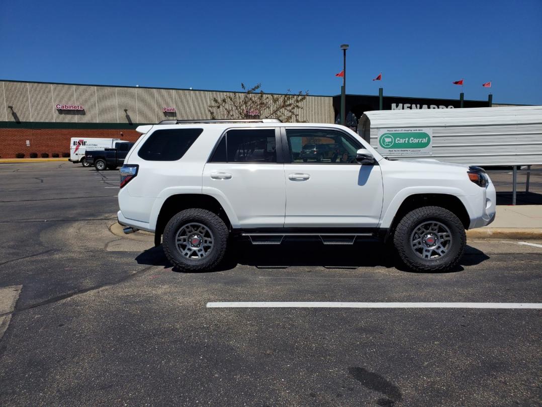

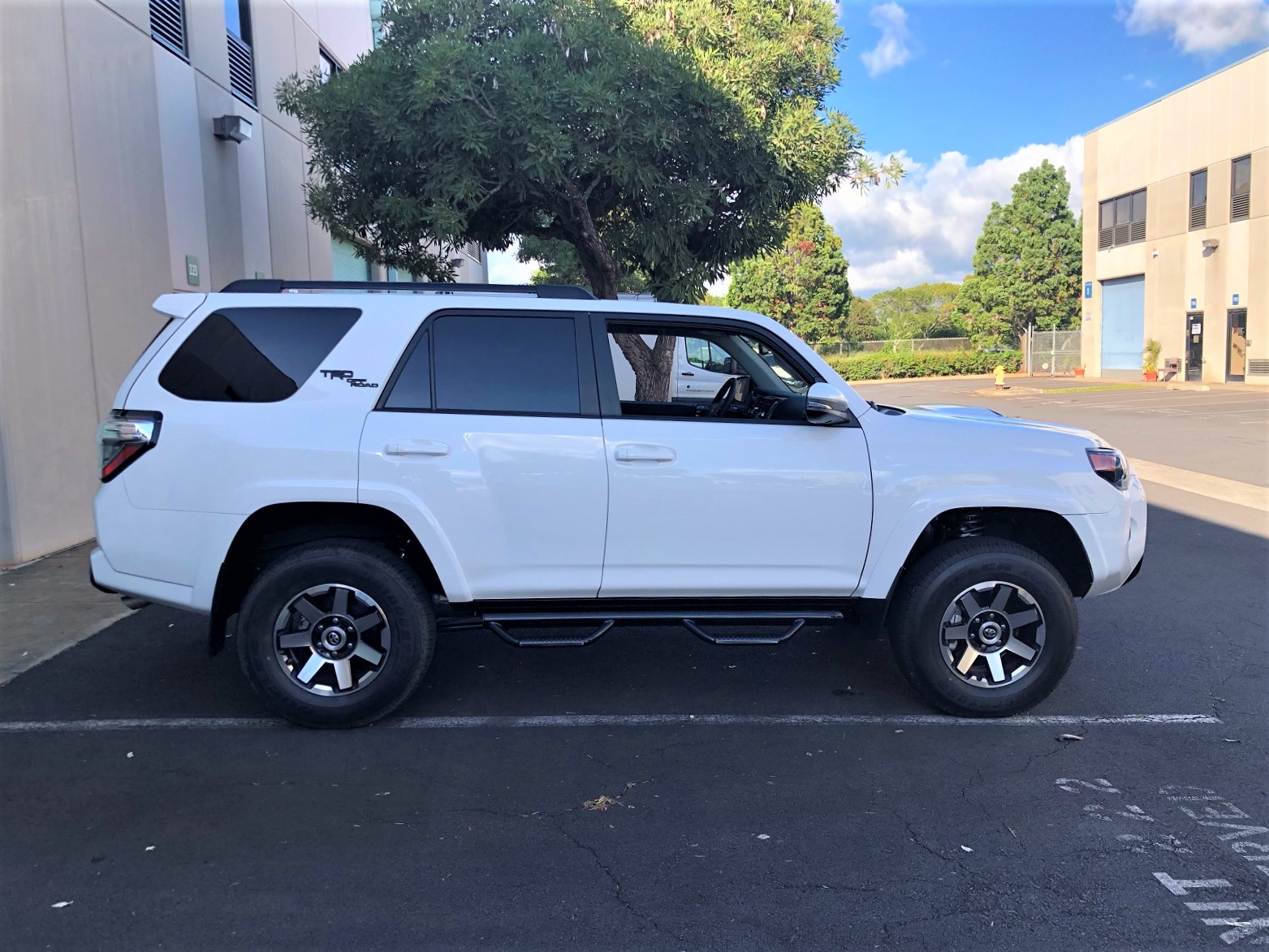

Well now I don't know, comparing pictures it seems mine is on par. Maybe my runner was low to begin with?
I've got Eibach rears and my front is another brand set exactly 2.5" and the rear 1.75

Your height is perfect. Don't touch it. Just get a taller girlfriend :biggrin2:
