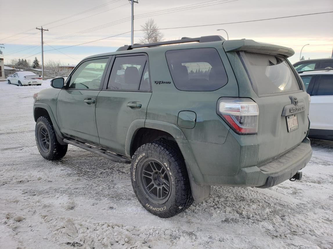

I have the kit on but I have 285's on and it sits about 75-76" to top of stock rails.

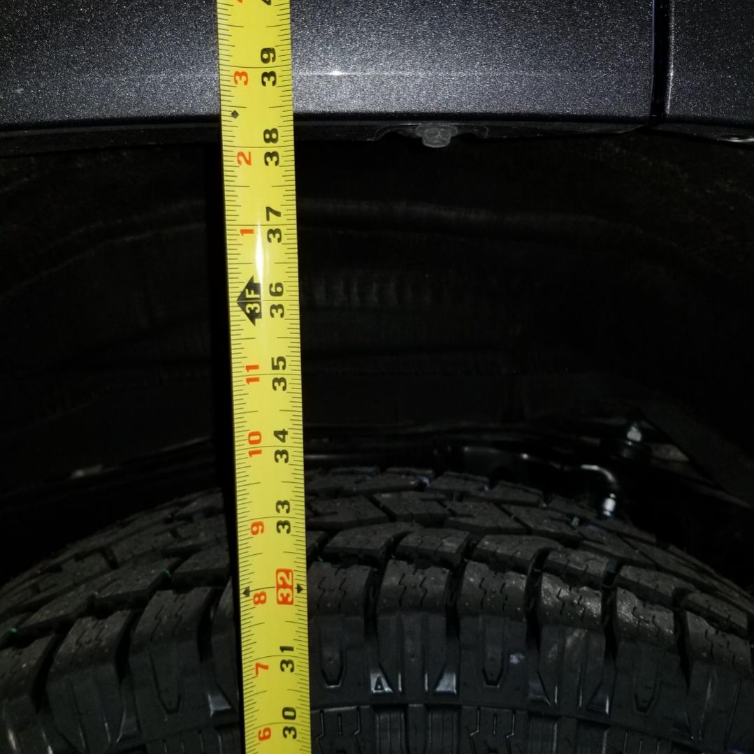

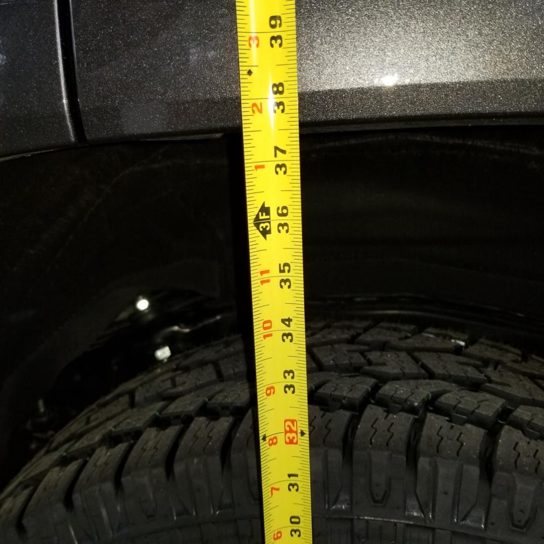

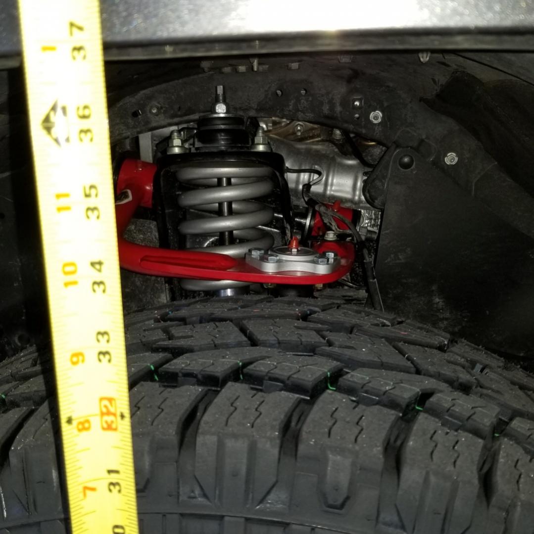

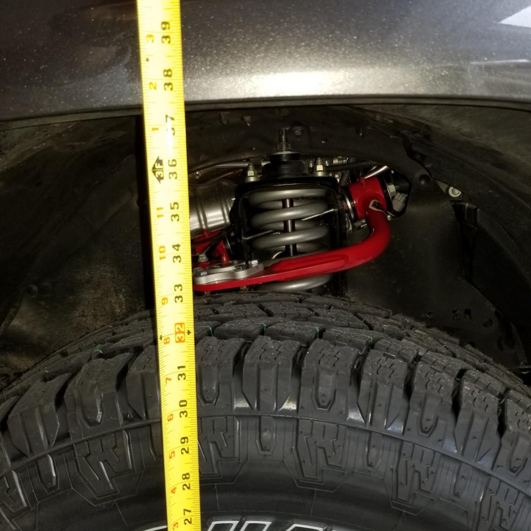

Here's the front, pretty sure i posted these about a year ago. Just add 3" to stock and your good.

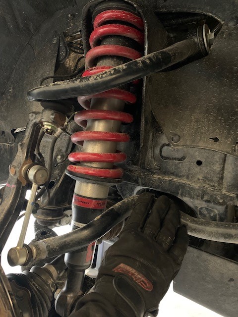

Front shocks- anyone else have an issue with the spacer on top? I had to use the factory spacer from Toyota. Couldn't get the threads to show up when using the thicker Eibach spacer.
I suppose I could swap them out now the that vehicle has settled a bit. Doubt it's worth the trouble.

Only issue i had was one of the stock rubber grommets stayed in place under the "top hat" took me to long to figure it out. With the double rubber grommets on the top of the shock there was not enough thread to secure it in place.
