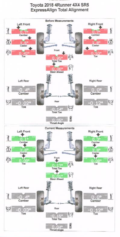

alignment after install
After the install, Handling and ride are GREATLY improved !!!, more planted and firmer but not harsh. The Eibach Pro Truck Lift Kit is the way to go, should have come this way from Toyota.

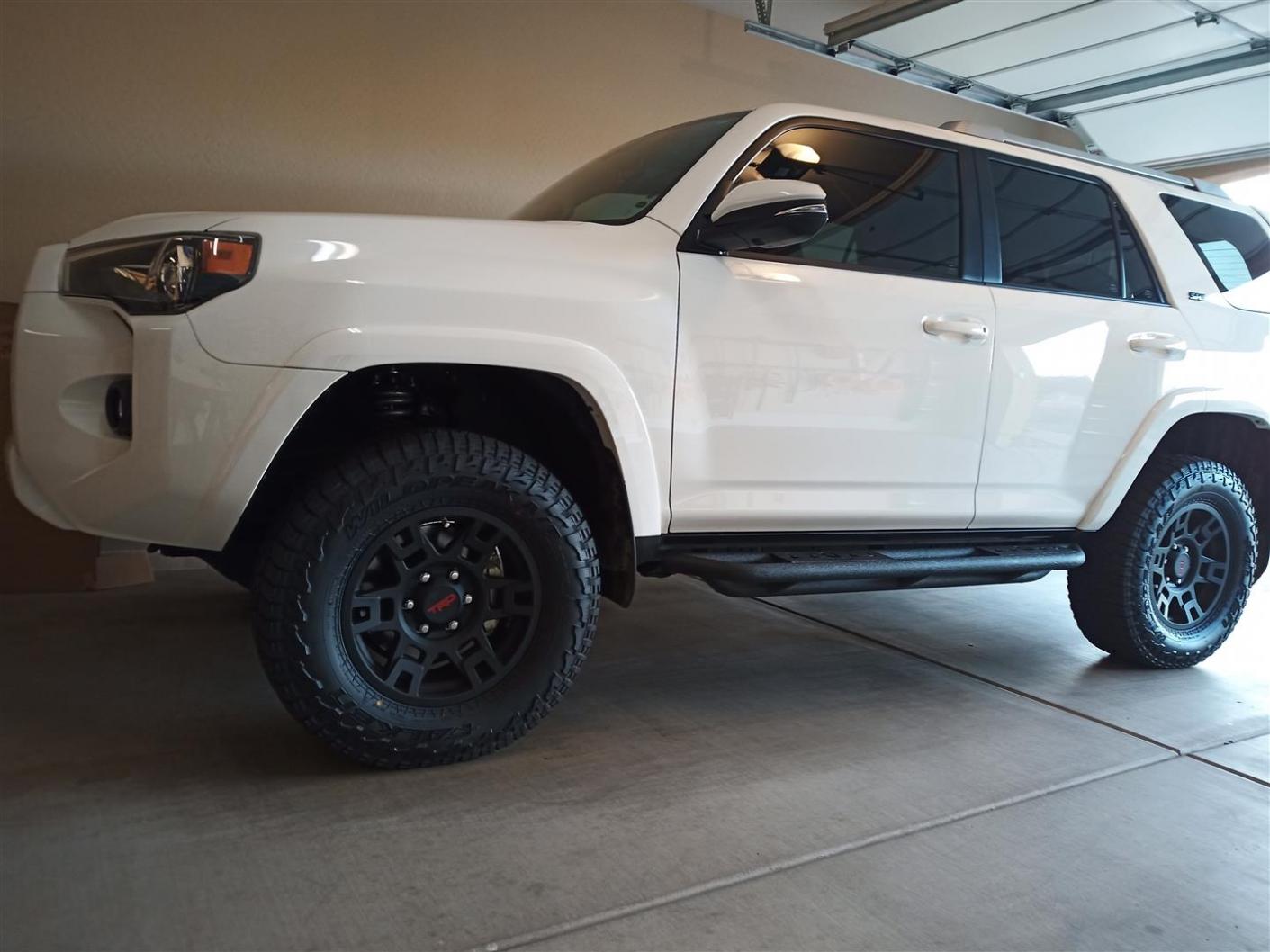

Any pics? What tire size did you go with? I’m assuming stock UCA’s with those numbers? Can’t wait to get mine on. My install paperwork says 2010-2017 4Runners so I’m wondering if I got some old stock or not? I’m sure it’s the same but oh well. Still waiting for my RRW Wheels on pre order to ship out.
Any pics? What tire size did you go with? I’m assuming stock UCA’s with those numbers? ...

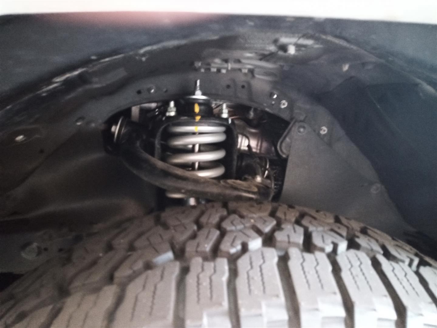

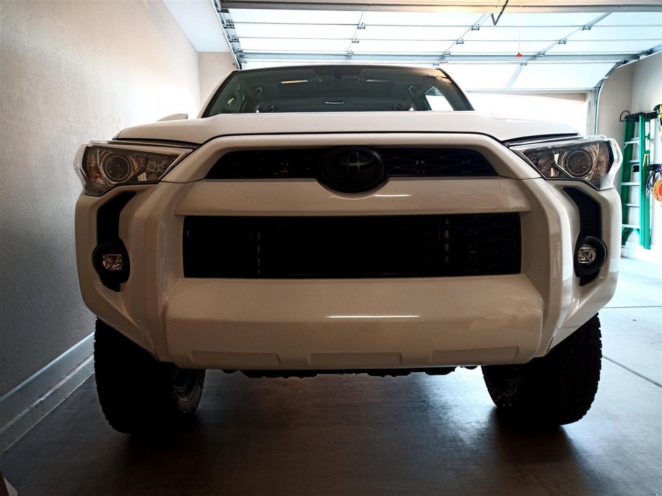

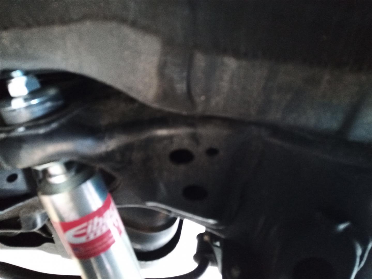

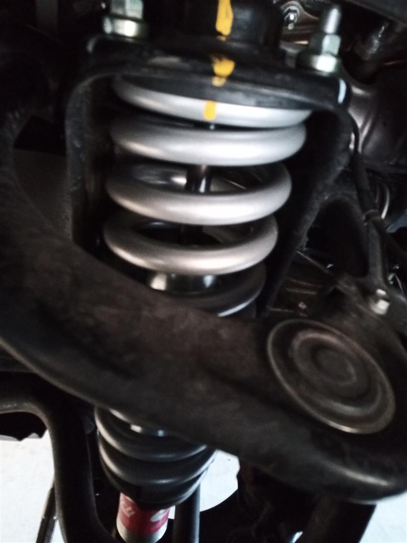

Yes those are Toyota UCA's (FWIW - The shop that did the install & Eibach felt that UCA's were not necessary unless the vehicle did ALOT of wheeling or high speed driving or you want to run oversize tires...). Tires are original size 265/70/17 Falken Wildpeaks.
I'm super happy with the ride and handling, even my wife said "it just feels better" .
